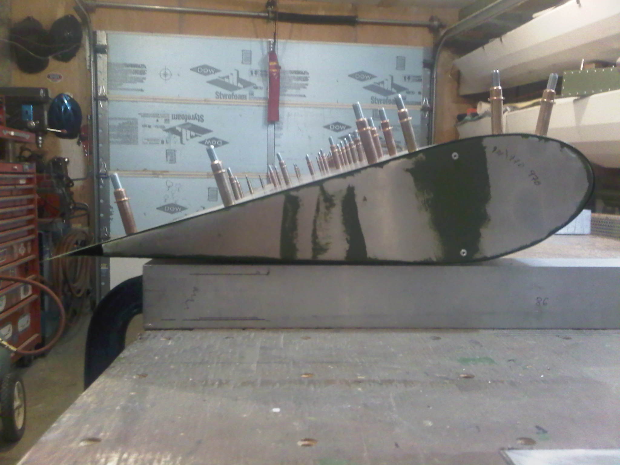

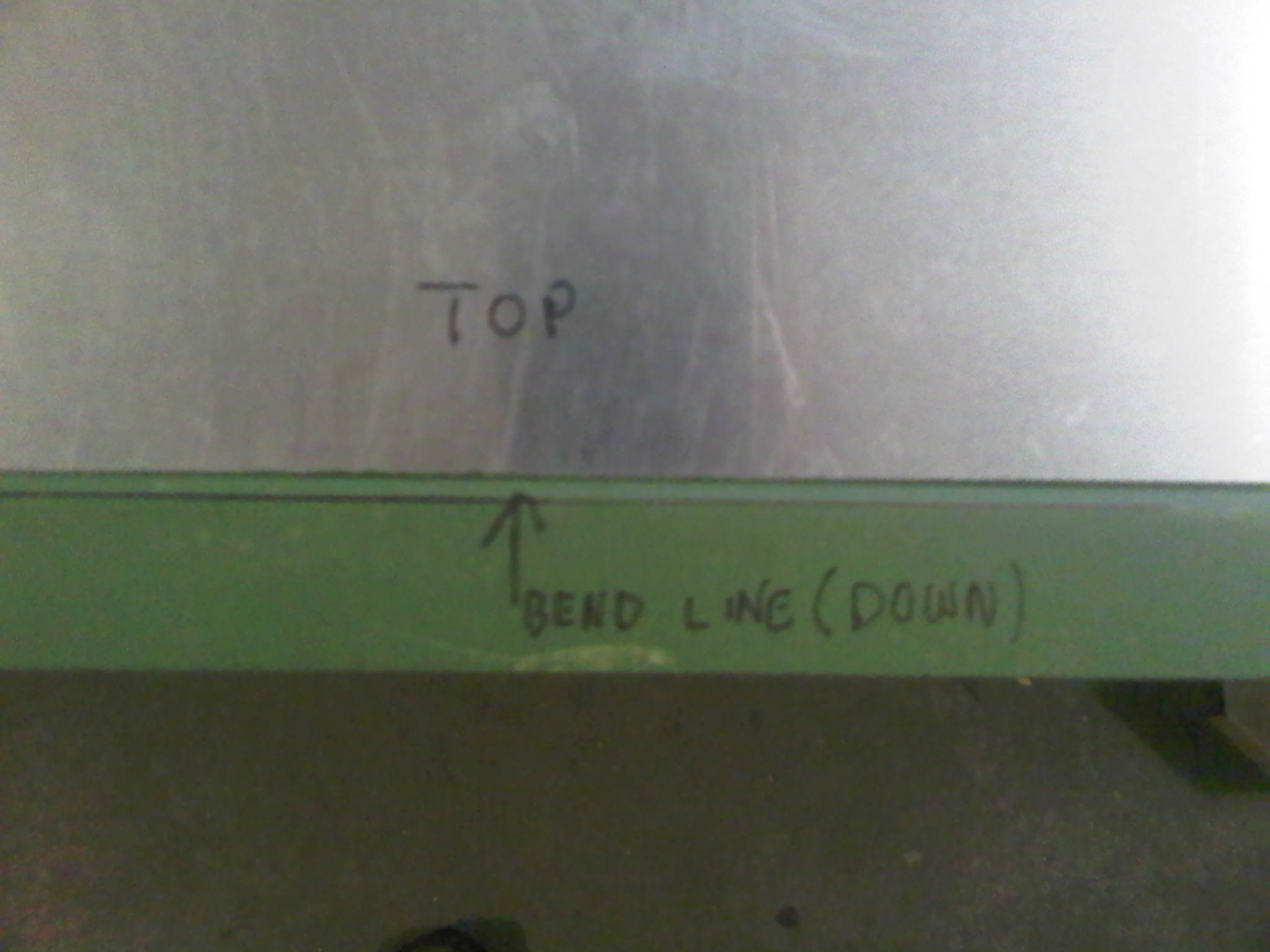

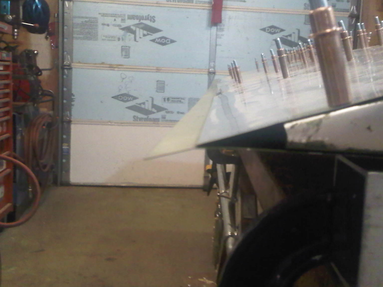

Hi All,
I thought being a shade tree mechanic and a mechanical engineer would serve me well in building a plane, I’m having my doubts. Please see attached photos. The elevator (kit Pieces) should be new version with the bend on the bottom skin (downward). As you can see the bent flange protrudes well past the top skin and if I were to put in the solid rivets along the trailing edge I would have to pull the skins together as they meet at point top and bottom planes intersecting rather than being parallel to each other. As you can see in one photo the bend line is out from under the top section of the skin. Thought I measured 3X and cut…..well drilled a lot of holes, anyway dazed and confused. Is this elevator scrap.
Sent same basic email to Caleb at Zenith.
Perry

Perry, I don't remember the exact mistake I made with my first elevator as it was about six years ago, but whatever it was, you've duplicated it perfectly. I scrapped my entire elevator but didn't need too. You will likely need a new skin though and then match drill the holes moved by 20mm or so.  In the assembly manual there is about half a chapter about finding the center point on the nose of the end ribs. The steps kind of seem redundant and should be pretty self explanatory but belive it or not, each of those steps is fairly critical to follow or you end up exactly as you have.
Another point to consider is the little duck tail bend in the elevator was meant to help the trim with a light two stroke on the nose. With a 912 Rotax or any other engine which is heavier, the duck tail actually causes insuficient trim and most builders end up bending it back to neutral. It would be easier to eliminate the ducktail bend while building the elevator instead of on an assembled and painted aircraft.
Hope this information helps.

PostPosted: Wed Jun 06, 2012 5:16 am    Post subject: Elevator Skin, Not as expected Reply with quote
Yes, reverse the ducktail now!
I left it "from-factory" but ended up bending it during my phase 1 period. Bending it while the elevator is completed and on the plane is a pain.

PostPosted: Wed Jun 06, 2012 1:54 pm    Post subject: Elevator Skin, Not as expected Reply with quote
Perry It is a bit hard to see from pictures but jpg 2 seems to indicate the top skin is protruding further out than the bottom skin.
which indicates the top skin should have been back further towards the elevator frame.
When you had it test fitted on the bench with ratchet tie downs holding the skin in place as per instructions you should have been able to get the skin trailing edge to match and clamp in position.
Unless you want to start again you will probably have to put a patch the length of the elevator in the bottom trailing edge with the bend in it (cut the bend out of old skin) looks like it needs to be approx 20mm longer to intersect correctly.
I wouldnt rely 100% on all measurements in plans some things may need to be fixed as you build make sure every thing is where it is surposed to be when you test fit.

PostPosted: Wed Jun 06, 2012 7:11 pm    Post subject: Elevator Skin, Not as expected Reply with quote
Hi Perry,
 With the amount of overlap showing I think the skin is on the ribs upside down. You should be able to reverse it and with luck drill new holes in the ribs. The spar holes will be a mile off though so perhaps a new skin is the way to go.

pdelano(at)telus.net
PostPosted: Wed Jun 06, 2012 10:39 pm    Post subject: Elevator Skin, Not as expected Reply with quote
Hi John,
Thanks for the feedback. It appears a new skin or a patch strip are both an option. Although I’m building from plans that called for the bent edge up on the top skin. The newer kit parts come with bent flange down on the bottom skin. The latter added some complexity to the issue which I thought I had sorted out pre drilling anything. Low and Behold, Not. In any case I will move ahead with one or the other. I’ll try the patch as others have suggested and feedback from zenith seems to support. If it looks suspect, I’ll go for a new skin.

PostPosted: Thu Jun 07, 2012 5:05 pm    Post subject: Re: Elevator Skin, Not as expected Reply with quote
I had the same problem scratch building, mine was really close but didn't give enough edge distance for the trailing edge rivet line on the top skin aft of the ribs.
So new skin, match drilled and left the skin a bit longer, then cut to fit once clecoed in place.
Much better second time around. Smile

PostPosted: Sat Jun 09, 2012 6:26 am    Post subject: Elevator Skin, Not as expected Reply with quote
Hi all,
After getting a lot of good responses here and talking with Caleb at zenith,
the solution to the miss measured skin (still not sure that is what it is as
everthing seems right exept the top skin shy about 20 mm) is to cut the
short skin back to the trailing edge of the spar and slide a new piece
underneath it to the leading edge of the spar (maybe a little more in each
case to ensure edge distance),thus both pieces will overlap each other.
Prior to doing any cutting ensure the new piece is long enough, wide enough
and alligned, I'll match drill the new piece through the old piece (already
drilled) and that I will cut off. End result, one extra seam line, no extra
rivets, no drilling out all the rivets in the bottom side of the skin and no
need to start from scratch on the elevator, "pheuuuww".
