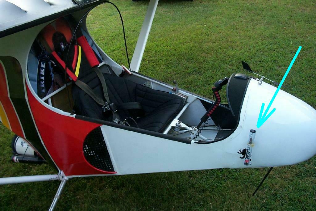

I bought one of those "Hall" mechanical wind guages as a "Check" because I couldn't believe how SLOW I was flying before stall...

Oh -- BTW I've got a $35 "Hall ASI" on my nose cone, Air Speed Indicator
in the Instrument panel and Garmon GPS 295 inside.
So I'm pretty sure my airspeed is right, but the Hall is the most accurate.

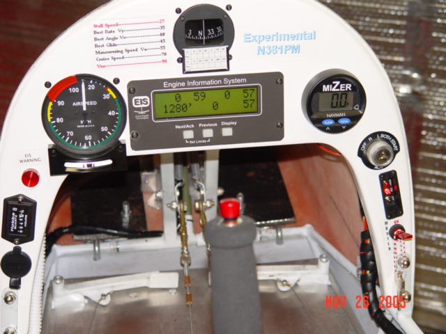

Actually got a glass panel - but still have my "Hall" as
a back up. Ha Ha
For the mountains.

Can you provide a link to the $35 hall asi product?
Charlie
http://www.hallwindmeter.com/wind.php
