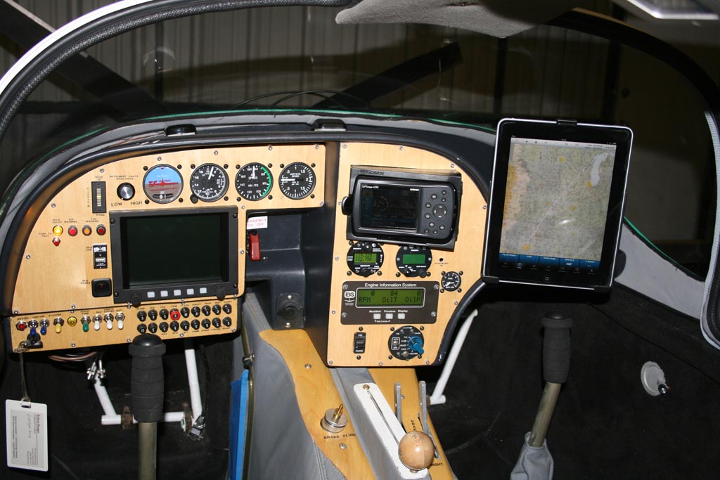

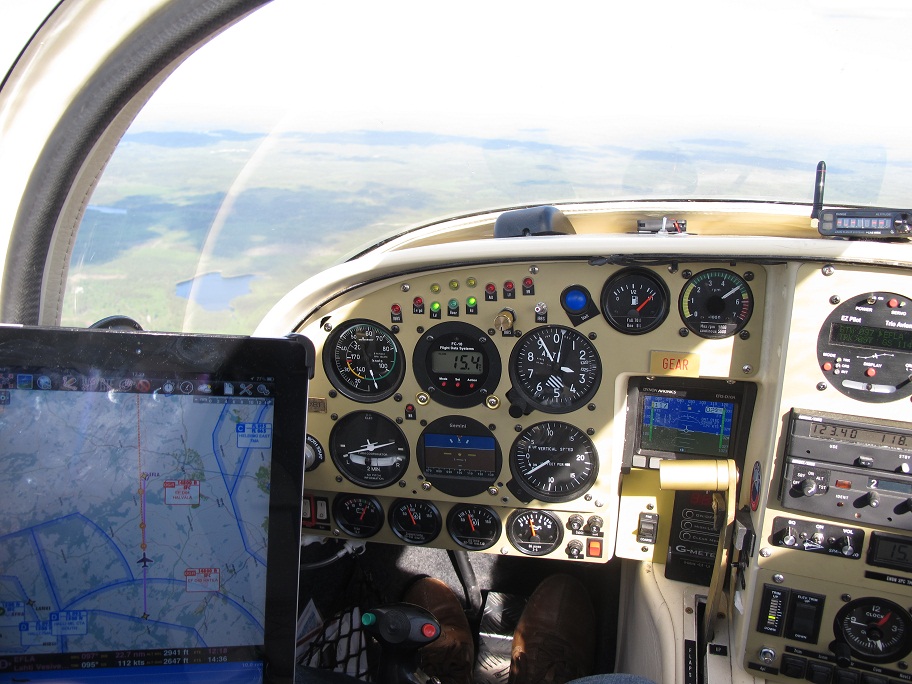

| Quote: | Hi Richard,
how about this?
The camera was aproximately there where is my my head when flying.
The Master ASI is well visible but a skid/ball and panel´s lower port corner not (there are some fuses, switches and a key),
In the other hand IPad´s mount is easily adjustable so I can turn it 90 degrees if I wanna see whole panel (but then IPad is not visible).
Notice: this configuration with also a new TruTrak´s Gemini ADI with TCW`s IBBS and Garmin´s 35HVS and FDS´s FC-10 fuel comp with GPS and only ONE fuel transducer has not been in the air yet but tomorrow it will. Wish me luck.
Cheers, Raimo Toivio

Hi Raimo,
TOOO MUUCH INFO!
I think I would have a problem with one horizon showing level, one nose down but level and a turn indicator showing a turn left!!
Ouch!

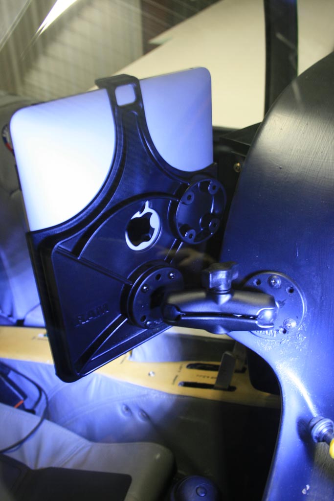

Here's how I did my iPad mount. It is a RAM mount system I purchased last year at AirVenture. It can be adjusted a fair bit to bring it closer to the pilot or to allow the passenger to operate it.
| Quote: | From the back, showing the mount:
I think the clamping bar should be turned so the tightening fixture is down. That way it can be operated more easily from the front of the unit.
I may get another ball mount and try it on the mount location on the right and middle of the mount as it may provide more freedom of movement.
Hope this helps.

Posted: Fri Jun 01, 2012 3:20 am Post subject: ipad mount |
Barry,
you are right - everything in my plane is up-side
down. Obviously that is why I get headache when
flying. Thanks for info!
Seriously:
- (My) Dynon is quite slow to react and this new
Gemini ADI is VERY sensitive (would like to adjust
it to be slower)
- in this situation plane was descending a bit
like plane´s VSI is showing
- my turn indicator is shit (brand name is Falcon)
and it is rocking like an idiot, I have ordered a
new one
This is a statement of my American friend for your
happiness:
Cheer, Raimo
Hello Barry! Kim Prout here....Raimo and I are
having fun here in Finland and are hoping to see
more Europas at the fly-in.
Anyway, I would agree that the differences in the
instrument readings are disconcerting and
confusing. It was no problem, however to fly
in VFR conditions knowing that the Gemini was
accurate. I would recommend to builders that the
mounting holes for turn coordinator, attitude
indicator,
and heading indicator be slotted to allow for
adjustment of level relative to airplane as the
panel cannot be relied on to be level based on its
fit to the fusalage
and firewall. In N111EU I really do not power up
the turn coordinator or attitude indicator (no
heading indicator installed) unless flying in
marginal conditions. The slip/skid ball works no
matter
what so no issue there. I always thought it
unecessary to power up the gyros with master
switch just wearing them out without really
needing them for the typical
VFR flights. They just seem to be a distraction
when I should have my head up anyway.
I prefer a separate switch for gyro power...only
need to remember to turn them on when anticipating
night, marginal or IFR conditions.
