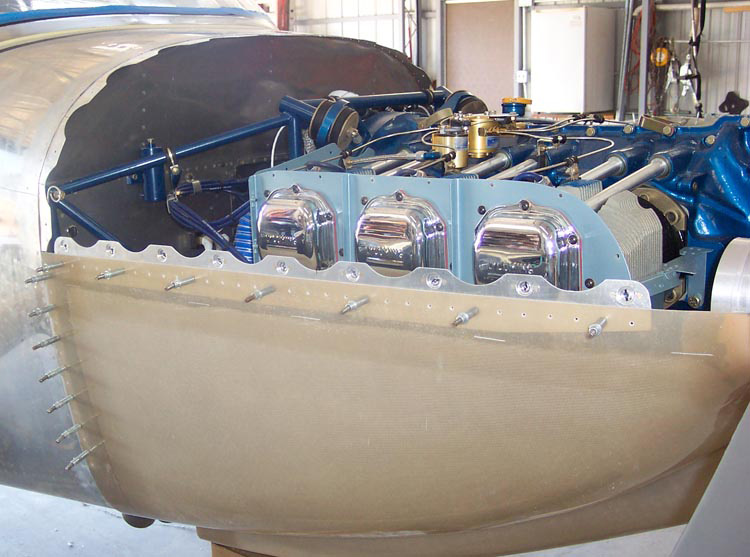

I’ve done several –8’s now and the original –10 with skybolts (or camlocs) around the firewall, with hinge pins on the horizontal joints. Some of the 8’s owners got all floating firewall receptacles – I don’t recommend that since that allows the gap to open between the cowl and the firewall. I think they recommend only using the floating ones near the horizontal to aid in installation after complete.
I don’t like the “ears” that come with the new kits to install as a flange along the firewall. It’s relatively so much easier to install a solid flange, then drill a pilot hole through the cowl into the flange – match drilled, done. Vs. trying to find the damn center of the pre-punched “ears” with their jig, flashlight, etc.

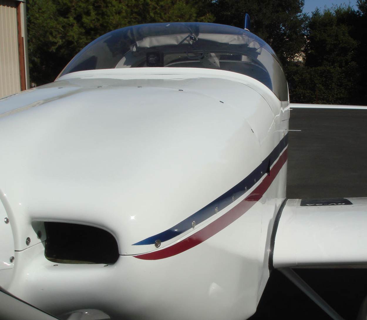

I installed the SkyBolts on my RV-4, but to be honest with you, I like the clean lines of the Vans Hinge cowl installation better than the silver fasteners showing every few inches. To each his own, though...

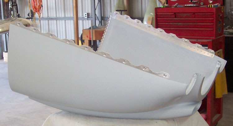

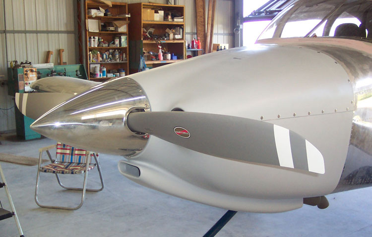

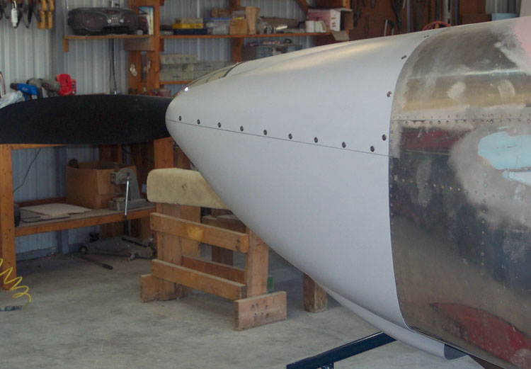

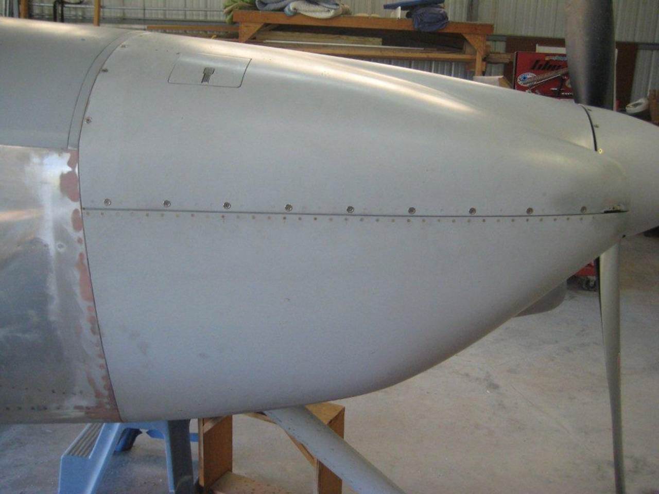

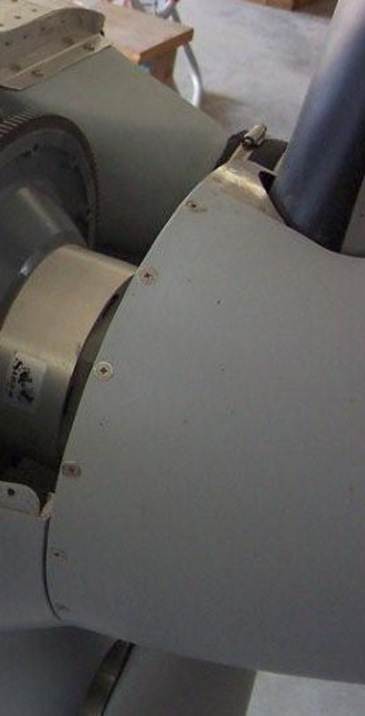

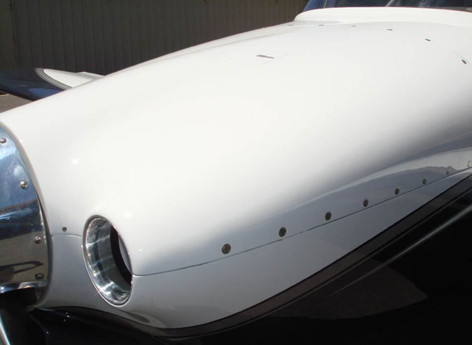

I have the skybolt style fastiners that can be adjusted to optimize height. Not sure if they are skybolt or not. I think they ran me ~$500.00. I have/had 4 RV's one was standard Vans Pins & Hinges and my -10 we used the Skybolt style fastiners and on both my 6A and my recent build of an RV-8A I used S/S screws and washers. I do like the SB fastiners but they are expensive, heavy and when the bits & pieces fail you you generally don’t have a hand full in your tool box or hangar. What I have come to like about the S/S screws is they are light, inexpensive and available just about anywhere. They work as well as the SB fastiners but with a fraction of the cost or effort.
Skybolt style
S/S screws on my 6A
Unpainted RV-8A with S/S screws and a special smaller washer. Painted photos due in 6 weeks Smile
I just re-read your email as I assume I am too late with my comments. Good luck with your install.
Robin

I like the sky bolts, but I only put them across the top of the cowl. Their instructions are poor, but mind the recommended spacing that they suggest and you will be ok. They are very expensive, but to my mind worth it in THIS AREA ONLY. They are good because they save a lot of time removing the cowl when you are flight testing, when you should remove the cowl after each flight.

I just had an email inquiring about my comment on installing the solid flange around the firewall being easier than using the "ears" supplied with the new skybolt kits.
I briefly read it in my email screener, then inadvertently deleted it. So here's hoping you get this as a general post.
Yes, you just rivet it around the firewall, then when your cowl is fit, simply measure where you want to put the skybolts and pilot drill through the cowl and flange -- perfect fit.
Originally I think everybody had to install their own flange (the kit was just male/female fasteners,collars, retaining rings), some scalloped it out, others didn't -- your preference for weight, easier to bend to fit if scalloped, etc. See Tim's site for pictures, specs on the aluminum, where to order it. The ears work OK, but personally, I don't see them as an improvement.
I hope this addressed your inquiry, if not, send it again or post it here for other feedback.

Yes, mostly. I'm assuming with the SS screws you are using an aluminum
strip with nutplates on the inside of cowling?
On Thu, Jun 28, 2012 at 6:29 PM, Robin Marks <robin(at)painttheweb.com> wrote:
[quote] Correct, the locks are *along all the edges of the top cowl*. I forgot
which locks I got but they are the ones that allow you to adjust for
height. On the 8A I used all #SS screws & washers in place of the locks.
Saved $500 and some weight. Plus much easier & cheaper to replace in the
field.****
The Piano hinges are on the sides of the lower cowl and have damaged some
of the fuse paint when taking on / off the cowl so many times (mostly due
to the SJ cowl). If I had made the nose gear slot longer it may have been
easier to drop the lower cowl down enough to better position it for
installation without smacking the fuse with the shark tooth like piano
hinges.****
Did that answer your Q's?****
Robin****

Here is our solution for the -10. Works well. I opted for S/S screws on
the 8A to save $, weight and simplify the build.****
On the -10 especially I have had issues with the lower side cowl piano
hinges damaging the fuse paint when removing & installing the lower cowl. A
longer nose wheel slot would have been beneficial to ease all the on/off.*
Absolutely don’t use Skybolts on the underside of the cowl (IMHO). Just
too much vibration, oil etc… for them to hold up long term. Ask me how I
know?****
Robin****
http://www.painttheweb.com/painttheweb/rv-10/SjCowl.aspx ****
[image: Description:
http://www.painttheweb.com/painttheweb/rv-10/Images/SJ_Cowl/Cowl-Fitting-6.jpg]
http://www.painttheweb.com/painttheweb/rv-10/Images/SJ_Cowl/100_2448.jpg]*
http://www.painttheweb.com/painttheweb/rv-10/Images/SJ_Cowl/100_2453.jpg]*
http://www.painttheweb.com/painttheweb/rv-10/Images/SJ_Cowl/100_2450.jpg]*
http://www.painttheweb.com/painttheweb/rv-10/Images/SJ_Cowl/Cowl_Left.jpg]

Correction:
Not Hellman Washers. They are more famous for their mayonnaise.
We use Tinnerman Washers
http://www.aircraftspruce.com/catalog/hapages/nas549washers2.php
Of note, we didn’t want as large a flange on the Tinnerman washers (especially on the spinner) so we took about a hundred washers and laced them on an appropriate size bolt then used a grinding wheel to remove about half the flange. This took less than 5 minutes to make 100 custom Tinnerman washers. One can use standard washers, we just thought the reduced flange looked better for this application.
Robin

Exactly. Used #8 with hellman ? Washers. always wanted to try next larger size and a couple fewer sets but didn't. Robin Kelly McMullen <apilot2(at)gmail.com (apilot2(at)gmail.com)> wrote:
Yes, mostly. I'm assuming with the SS screws you are using an aluminum strip with nutplates on the inside of cowling?
On Thu, Jun 28, 2012 at 6:29 PM, Robin Marks <robin(at)painttheweb.com (robin(at)painttheweb.com)> wrote:
Correct, the locks are along all the edges of the top cowl. I forgot which locks I got but they are the ones that allow you to adjust for height. On the 8A I used all #SS screws & washers in place of the locks. Saved $500 and some weight. Plus much easier & cheaper to replace in the field.
The Piano hinges are on the sides of the lower cowl and have damaged some of the fuse paint when taking on / off the cowl so many times (mostly due to the SJ cowl). If I had made the nose gear slot longer it may have been easier to drop the lower cowl down enough to better position it for installation without smacking the fuse with the shark tooth like piano hinges.

Another way to do the spinner is to take #6 Tinnerman washers and drill them out to take a #8 screw.
Carl
