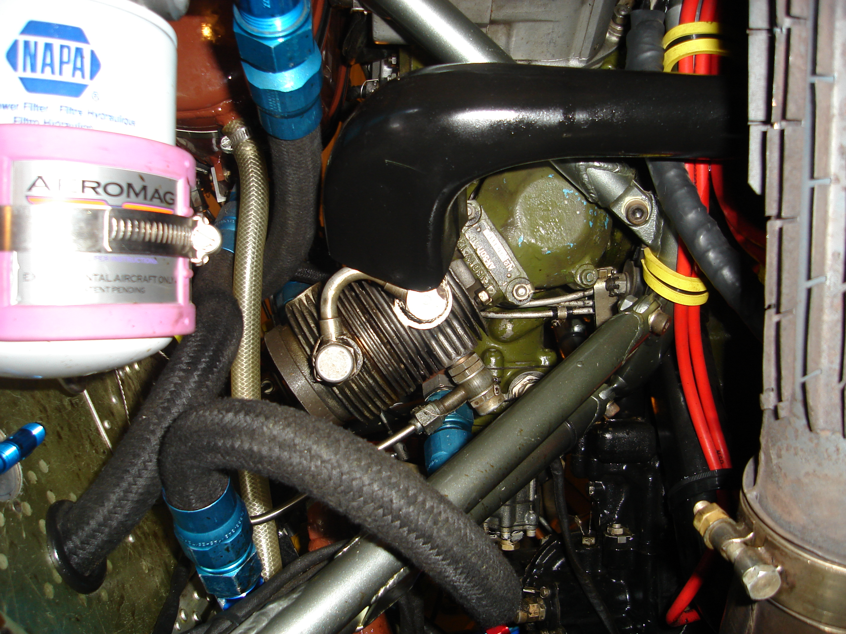

I have, what I'm told is an AN2 engine driven compressor. Mine is larger than the stock M14P compresssor. Besides making air at idle, I can have an empty bottle to the point of fill while taxing. I tend to like it.. Attached is a picture.
Larry Pine
Larry Pine

It's a little larger but still fits as an exact bolt-up. Mine is canted downward instead of the stock upwards due to hoses that I added.
Larry Pine

On May 10, 2012, at 9:53 AM, Larry Pine <threein60(at)yahoo.com (threein60(at)yahoo.com)> wrote:
[quote]It's a little larger but still fits as an exact bolt-up. Mine is canted downward instead of the stock upwards due to hoses that I added.
Larry Pine

<DSC01571.JPG>

PostPosted: Thu May 10, 2012 6:09 pm    Post subject: compressor issues Reply with quote
A few facts to consider:
AN-2: 4700 pound aircraft with a 1000 horsepower engine. Pneumatic brake system and compressor designed to bring it to a stop.
Take air compressor off 1000 HP engine and put it on 360 (or less) horsepower engine.
It fits.
Pumps up tank faster. You betcha. Which means it also places a much heavier load on the engine drive system that powers it while doing so.
The result of doing that long term? I have no idea. Maybe someone else does. I have no doubt that it works well short term. It may turn out to be a really good mod, but make no mistake that it will rob more power from the engine when it is under load. Not saying the sky is falling. Just saying that it is wise to consider such a change carefully.
Mark Bitterlich
Larry Pine

Unload it while flyin. Save wear and tear on any compressor.
Bill
It fits.
Larry Pine

On May 9, 2012, at 3:09 PM, Larry Pine <threein60(at)yahoo.com <http://us.mc1614.mail.yahoo.com/mc/compose?to=threein60(at)yahoo.com> > wrote:
Larry Pine

Unloading while flying not a bad idea to avoid continuous load when tank is
full but I am guessing that it would still load the drive system while
filling the tank and if nothing else I is will surely take more energy
(horsepower) from the engine even when not under load than a stock
compressor with the same mod... May not be much I just don't know.
Nifty install though.
Sam
