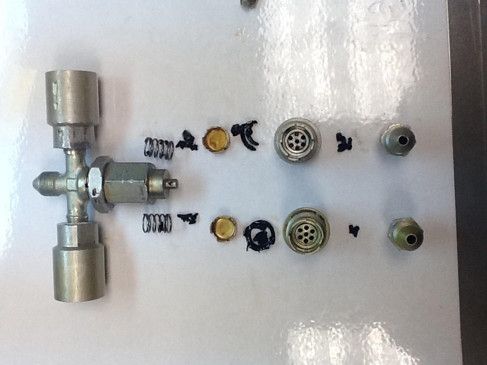

My airplane "seemed" to be operating quite normally until I returned
from a few days at Sun N Fun. When I landed at my home airport, I did
the usual shut down and secured the airplane--only to notice then that
the EMERGENCY air pressure was zero. It was not at zero at the time
of doing my landing checklist and had never leaked before. The
following day I began to pull apart the check valves, beginning with
the one that holds pressure in the emergency bottle. That seal was
quite deteriorated, apparently failing during the last leg of my
flight. The seal on the other side of that same tee was similarly
deteriorated. I next went to the second tee, located on the other
side of the firewall...same results---two more badly deteriorated seals.
A final check was made at the pop-off tee, and attached is a photo
showing those recently disassembled check valves. The black bits laid
out between the various parts are placed to indicate where those bits
were found. The black bits are what is left of the seals, which had
completely deteriorated. Bits of the seals were also found on the
"in" port of the water filter. One might think that, since both check
valve seals at the tee are exposed to engine oil via the snot bottle,
that may be the cause. Not so!
Subsequent tests on the seals revealed the following:
New seals are .4750" in diameter, and .067" in thickness. This was
verified by measurements also taken by Doug Sapp. A NEW seal placed
in air tool oil for several days swelled to .5300" diameter and .
0725"thickness...roughly 11% increase in Dia. and 8% in thickness.
Two more NEW seals that were in valves I had overhauled for inventory,
with a drop of tool oil on the piston, had grown in dimension almost
exactly the same as the seal I soaked in the oil. Obviously, any
exposure to this oil had profound effects on the rubber.
I chose to ignore posted advice by Doug which said something close
to..."If you don't know what your are doing, err on the side of a dry
system." I had ass/u/med what a Yak could digest, a CJ could also.
Bad assumption. If I ever am tempted to "lube the system" again, it
certainly won't be with MMO air tool oil...and I'll be doggone sure I
thoroughly test the compatibility of anything I consider sticking in
the system.
Fly safely,
Buddy

The same happened to me on several
occasions but with one difference, only
the after market rubber pads got dissolved
while the original seals are still intact.

I had exactly the same results with the chevron seals in my YAK-50's
landing gear actuators, which caused them to fall to pieces.
Fortunately, the emergency gear blow down worked. This event was posted
to the YAK-List about a decade ago. Since then, the idea of putting oil
into the air system has once again grown in popularity.
Good luck with that.

dougsappllc(at)gmail.com
PostPosted: Wed May 02, 2012 10:00 am    Post subject: Effects of air tool oil in a CJ pneumatic system Reply with quote
About the check valve "pads":I don't know who Elmar is referring to as selling "after market" check valve rubber pads, but mine come from China.  Elmar's post caused me to start wondering if my inventory of pads were in fact any different than those which are in a factory assembled check valve.  This morning I disassembled a factory new check valve and found that the rubber material appears to be the same black material as the pads which I buy from my vendor in China.  I do not have the expertise to correctly analyze the material to be 100% sure but the two examples do appear to be made of the same material.   The outside dia is the same on both, the thickness is a bit more on the one which was removed from the factory new check valve, as it mics about .080.
Best,
Doug

again in the last 12 years, let me please relate to anyone new here that
it ALWAYS comes down to the same thing. The subject goes from Pneumatic
Air Tool Oil, to Glycerin/Alcohol, and then to Caster Oil or #8
lubricating oil.
APPLES AND ORANGES FOLKS! APPLES AND ORANGES.

No argument!
All of you own your own airplanes.
They are all Experimental.
Squirt any kind of oil you want to in the darn things.
But, I think it is less than bright to argue (if that is in fact what is
happening here) with someone who has taken a seal, dunked it into
Pneumatic Air Tool Oil and then watched it swell and start to come
apart.
But that's just me.
Mark
p.s.  As a new YAK-50 owner back in 2000, I listened to people ON THIS
LIST telling me to put pneumatic air tool oil into the system.  I did
exactly that.  I have told everyone on this list that the chevron seals
then fell apart and I was lucky to get the gear down.
p.p.s.  And since I have watched this discussion occur over and over
lubricating oil.

Uh, no. Here's how I read it:
"I lubricated my pneumatic system with air tool oil. It hosed up all my check valves by rotting out the rubber."
<Natural follow on -- > "Here is the stuff we are supposed to be using as recommended by the builders of the airplane -- glycerine and alcohol."
See? Obvious connection. And I bet there were several people on here who didn't realize that glycerine and alcohol is the proper lube for the pneumatic system. The thing I didn't remember was the ratio of glycerine to alcohol and the proper quantity to be injected into the system. I was hoping to jog someone's memory into providing the missing piece.
But I know that I have parroted the, "lube the pneumatic system with air-tool oil," party line in the past. Bad on me. But I did remember that there was an official alternative and thought I would remind people. Sorry. It was a case of me stepping out of character and trying to be helpful. I'll shut up now. Wink

  1. Well, it seem that Marvel air-tool oil attacks rubber seals.
  2. Hmm, MATO looks and smells like MMO.
  3. I wonder if MATO has the same components as MMO or is even the same stuff as MMO?
  4. If so, I wonder if MMO has the same effect on diaphragms and seals in the oil and fuel system?
I don't know the answers to my two questions. But I do know that, as a result of the discussion here and my ruminations, I am going to be a bit more circumspect in my use of MMO in the future.
YMMV.
