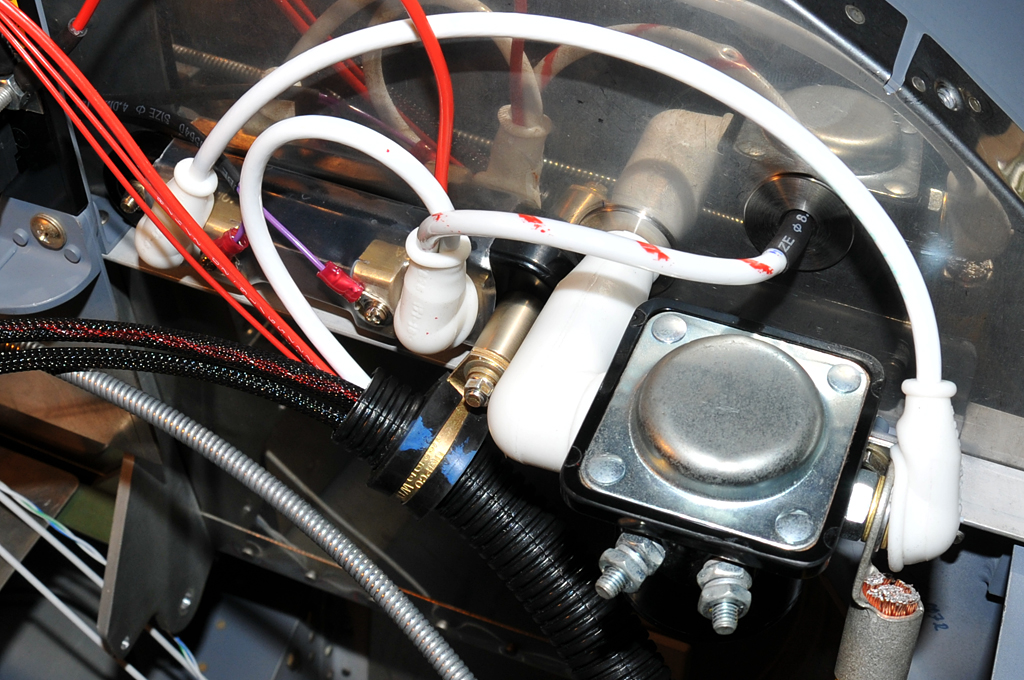

My shunt is mounted in the 'hot' wire between the live post of the starter contactor (not measuring start currents) and the main and avionics busses. The B-lead is upstream (so to speak - depends whether we're talking electrons or holes !), so I can read the current into and out of the battery. I've already 1A fused the signal leads (which go to my EFIS), but I wanted additional insulation around the shunt to protect from shorts should anything metalic fall between it and the fuselage during aerobatics. I don't really understand how a shunt is calibrated, so I'm wondering if clear heatshrink and having the shunt on the back of the firewall will alter the temperature environment of the shunt enough to affect it's calibration? You may be able to see the heatshrink in the photo ... which has holes punched for the terminals to screw down.
Kind regards, Stu<?xml:namespace prefix = o ns = "urn:schemas-microsoft-com:office:office" />

No it won’t be affected by temperature enough to be a problem. A shunt is a low value resistor in series with the circuit you want to measure the current in.
An ammeter is a sensitive volt meter that measure the voltage being dropped across the shunt (resistor).
The calibration of the shunt will the depend on the Full scale deflection current required by the Ammeter.
Needless to say just use the shunt supplied with the engine monitor package and you will be ok.

I will expand on John's righteous answer to add that GOOD shunts are made of a strange metal called manganin. This is an alloy of multiple metals designed to give the shunt a zero, or near-zero coefficient of resistance versus temperature. Obviously, a shunt carries current through a resistance which heats it up. Further, shunts may be situated in environmental extremes of temperature.
It's desirable to have a very low temperature coefficient for resistance so that the instrument reads correctly under all operating extremes.
Hence, any additional heating that might be attributed to the added insulation is of no consequence.

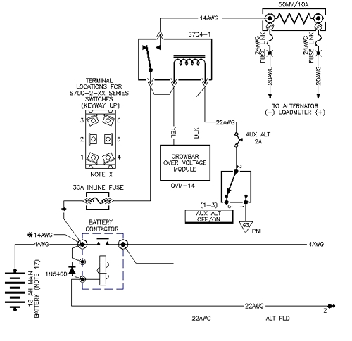

Thanks for asking Bob, your question inspired me to pull out z13/8
again to make sure I hadn't hooked it up wrong! If I understand
correctly though, it looks like the shunt for the SD8 goes from the
always-hot side of the battery contactor via a 20AWG fuse link. Is
that not correct? It's been a little while since I hooked all of
those wires up.

Oh . . . THAT shunt. Yes, Z-13/8Q does show that sequence of connection which was shuffled around in Revision R when we deleted the "self excitation" feature for the SD-8 and replaced the 20AWG fusible link with a 30A fuse thusly:
[img]cid:.0[/img]
But I understand how it came to be on your airplane and it's no really big deal. I wouldn't change it now. But it did strike me strangely and I had to ask. I should probably add a note to Z-13/8 to elaborate on the 30A in-line fuse. The picture I had in my head at the time suggested that leads supplied on the COTS fuse-holder would place the SD-8 control relay close to the battery contactor. The note would speak to this design goal and suggest that the leads not be spliced. In fact, I did mark the upstream lead as being in the 6-inch-or-less category.

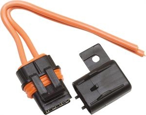

I've just discovered an rather slick, in-line holder for the plastic fuses. It's offered by marine electrical suppliers (among others). It's not only waterproof by virtue of the now ubiquitous bellows gasket but the snap-on cover features a mounting tab. Pretty cool.

it's all still good. Should I replace it with a fuse? That nifty
inline holder looks a lot like a weatherpack connector.
You got it. Yeah, if it were my airplane, I'd go
for the fuse. Simple, fast, inexpensive and continuing
to evolve . . . sort of like the elegant hammer . . .
I'll do some poking around to see if I can find a bulk
source for those fuse-holders. Either B&C or AeroElectric
should stock that one.

They sure look like Weather Pack fuse holders maybe from
http://www.whiteproducts.com/
and the Blue Sea version is on Amazon for $9
http://tinyurl.com/7tzcmc2
Greg

Yes. I've located a bulk distributor and
will set up and purchasing account with
them as soon as I can get to it. Thanks!
