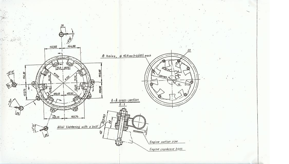

FWIK the engine mounts are not tightened
by torque but rather by measurement, please
see attached picture.

PostPosted: Tue Apr 24, 2012 12:44 am    Post subject: engine mount torque values Reply with quote
In the unlikely event the attached
png file doesn't work, here comes
an alternative (low-res pdf).
