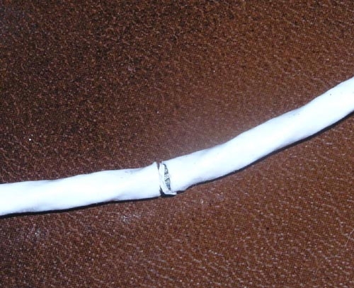

The problem with hot strippers and multi-conductor
shielded is that it is insufficient to simply
part the outer jacket at the strip-length.
When the jacket is molded over the braid
which in turn is conformal to the spiral
wires beneath, there is a great 'attachment'
of the jacket with the braid.
So even if you achieve a clean separation of
the strip length of outer jacket, the
unwanted insulation generally refuses to
slide off. Here's a shot of a cleanly separated
length of about 1" on the end of a shielded
trio. No way is that stuff going to slide off.
[img]cid:.0[/img]
Tefzel jackets are also very
thin. PVC insulation is thick enough that
'pushing' a strip-length off at the cut
tends expand the inner diameter of the
insulation lessening the grip on the wire.
Tefzel is so thin that the same push fails
the insulations column strength in compression
and it simply bunches up . . . and rips the shield
strands but still hasn't budged in the space
beyond.

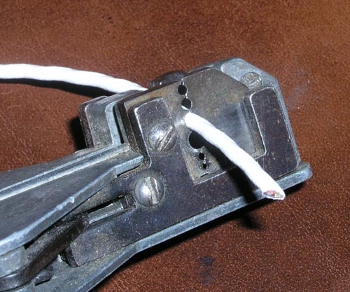

My favorite process uses the generic Stripmaster
with knife-edge dies . . .
http://tinyurl.com/bol9x2n
In this case, a 22AWG trio is nicely decapitated
with the 14AWG die.
[img]cid:.2[/img]
The dies just barely cut the jacket but does get a
'grip'.

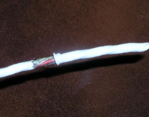

The resultant strip comes out looking like this:
[img]cid:.3[/img]

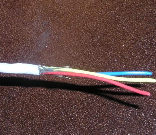

You wind the shield remnants tightly around the wires like
this . . . keep the diameter small.
[img]cid:.4[/img]

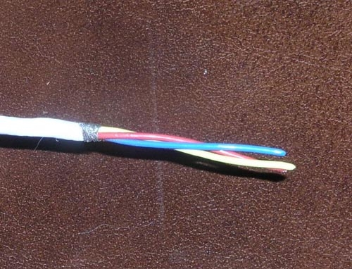

If the wire is 'old' . . . the shield strands may
be less than bright. Optionally, you can prepare the
strands to accept a solder sleeve by 'tinning' them
but shake off all excess solder.
[img]cid:.5[/img]

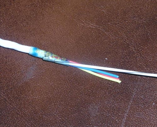

Then apply solder sleeve for a finished product that
looks like this.
