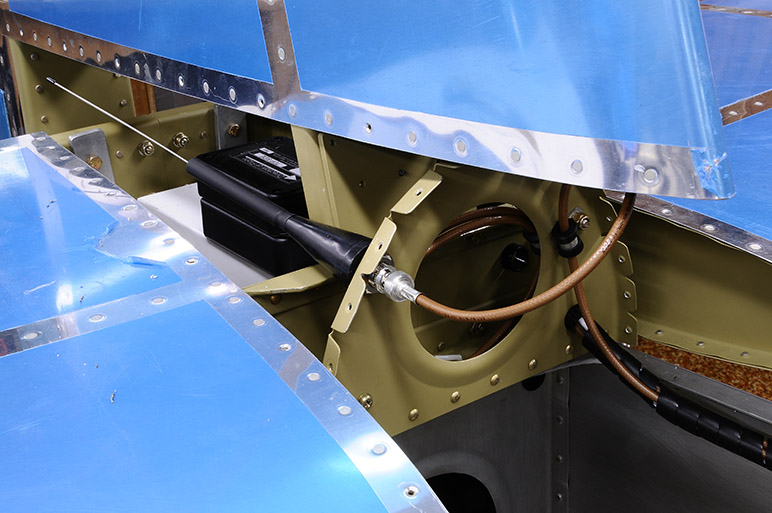

Please see attached picture:
Please understand that my intention is not to be critical, but to learn…
Is this an effective way to mount an ELT antenna?
I understand why this builder chose to mount it this way. But I have concerns that there is a great deal of signal-blocking structure very close to the antenna.
What do you RF gurus think?
-RF neophyte

Well certainly the omni-directional characteristics of the 1/4 wave antenna are ruined, the vswr, is probably affected, it's horizontally polarized and nicely shielded......It might still work but you'll never know until you need it. If you want to hide ALL the antennas inside structure you probably need a glass plane.... Wink

In terms of ideal electronic performance, it is a poor location. In terns of intended mission it is excellent. The tail cone location makes it very likely the antenna will survive a crash. There are enough gaps to make it likely a satellite would be able to receive a signal.
It looks like you have an RV model. In that case a better place for an ELT antenna would be under the rear portion of the canopy. But what you have will certainly be more reliable than any external mount.

To be clear, that picture is not of my airplane.
I am building an RV-7 but have not started work on my fuselage. I’m trying to gather information for decisions I will be making in the near future.

rule, but I don't believe that was the original question. As far as the
ELT in the picture goes: I don't believe it would comply with the
manufacturer's TSO, and would for that reason not be an acceptable
solution to me personally. Whether it would work as hoped in an
emergency or be acceptable to your DAR is a question none of us can know
for sure. It's your airplane, and you are free to decide based on your
own priorities and how lucky you feel at the moment.
John Grosse

PostPosted: Sat Apr 07, 2012 6:19 pm    Post subject: ELT Antenna Mount Reply with quote
John & Jeff,
<< I don't believe it would comply with the manufacturer's TSO, >>
Usually the manufacturer's installation instructions address what must be
done to comply with the TSO. For example, the 406 MHz ACK E-04 and the
Airtex 406-4 say the unit must be mounted in a certain orientation to a
structure of a certain strength, have an antenna cable of a maximum loss,
use their supplied antenna mounted to a structure of a certain strength,
etc. It does not mandate where the antenna is located. There are some
recommendations but no TSO requirements. Thus I conclude, unless there is
some very unusual wording in a specific ELT manufacturer's instructions, the
far tailcone installation is legal. Note the multifrequency antennas for
the above ELTs would not mechanically fit in the shown location.
But as I said, a much better place would be under and near the rear edge of
the canopy. It would meet the dual needs of crash survivability and
reasonable satellite visibility.
