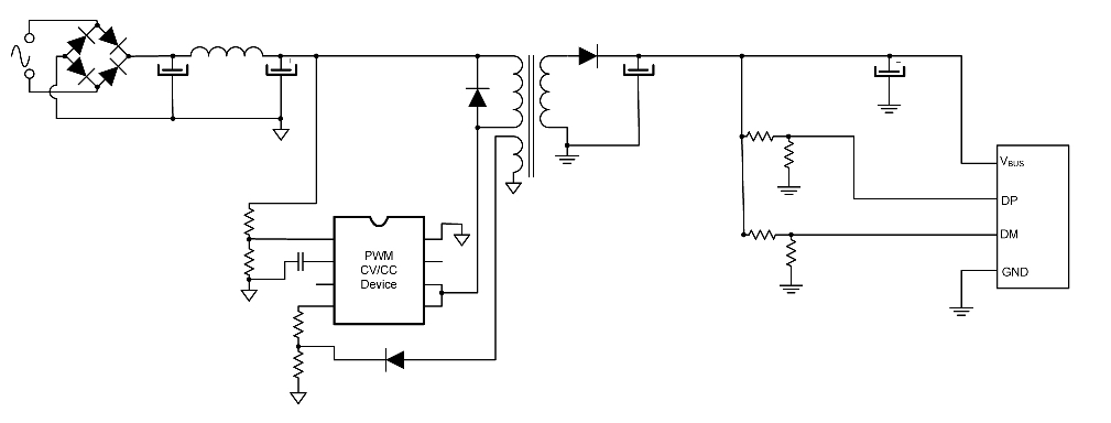

The "wall charger" illustrated in the first link . . .
[img]cid:.0[/img]
Is not a 'smart' charger. It's merely a 5V power supply
that includes a couple of bias networks intended to convice
the powered device that there is a 'real' USB client on
the other end of the cable . . . silent but real.

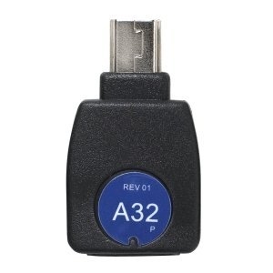

[img]cid:.1[/img]
I probed the 6 interface pins in this adapter (which
works with my mobile phone) and found THREE resistors.
No doubt they are necessary to effect a friendly
interconnection with the phone. There are only 3 wires
between the adapter and the power supply so at least
one and perhaps two of those resistors are used to
"talk to the power source" with the remainder used
to placate the mobile phone.

Should it happen that your particular device balks
for lack of characterization (like an IGO A32 tip)
then you might have to buy the tip designed to
'talk' to your device and adapt or clone it into
your airborne, USB connector based POWER distribution
system.

  [img]cid:.1[/img]

  One could consider adapting a compact, multi-port
  device like this . . .
[img]cid:.2[/img]
 mounted on the panel and then wired to a 5V
