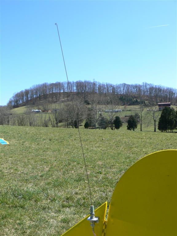

After a year of frustration, finally got good radio reception on the FSII. Before the crash, the antenna was on the bottom of the fuselage under the seat, and it had a ground plane, and it worked pretty good.
After the rebuild, decided to try using an old ELT antenna located on the front of the gap seal/cabin top as the com antenna, but that didn't work. Figured that an antenna tuned to 121.5 ought to be in the spectrum, but apparently not. A lot of hash and static, couldn't understand anything or anybody.
Took it to an avionics shop and they replaced the ELT antenna with a Comant style fiberglass antenna in the same location - no good either, still noisy.
Put a ground plane under the seat and put the antenna on the bottom of the fuselage. Same results. Tried a different radio - same results. Tried all sorts of combinations of antennas and radios, - and then got lucky.

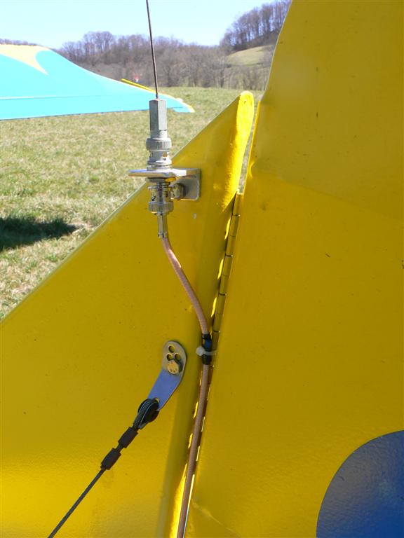

Carried the hand held all around the airplane with the engine running and the headset plugged into it and at the top of the vertical fin found a dead spot that was free of hash. Several test flights today confirmed that this is a very quiet spot with great reception in almost all directions - except dead ahead of the airplane. You can semi-sorta maybe hear whatever the airplane is pointed at, everything else works fine. We can live with that.

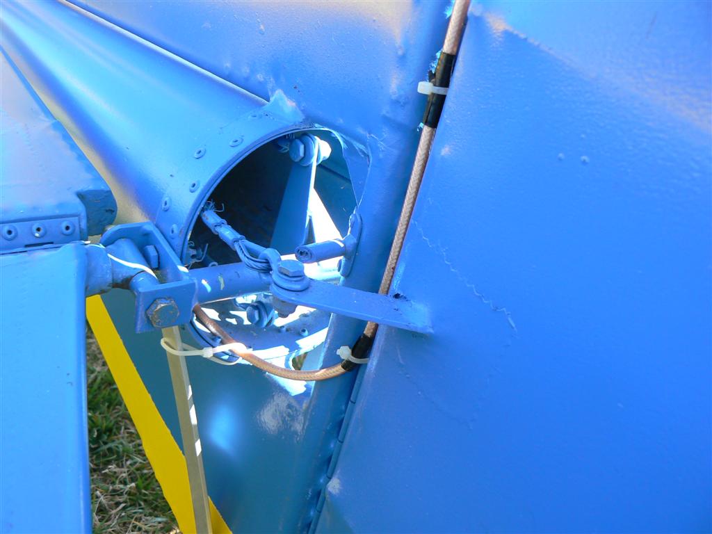

Tried the Icom's rubber duck antenna, the home made whip is twice as good. Here's how it's made: 24 1/4" long from the end of the BNC connector to the little rounded curl on it's end. There is a jack-to-jack BNC bulkhead pass-through screwed into the bracket. The ground plane consists of the front of the vertical fin, the boom tube, and the stab brace wires and the stab, so you have a ground plane in front and to the sides, not much in back. Maybe that's why reception stinks straight ahead? Transmission is good in all directions. Go figure -
The antenna is made by taking a Radio Shack twist-on male BNC connector, part # 278-103 and a length of 1/16" model airplane pushrod steel wire, and combining them like this: take one end of the steel wire, and taper it on a grinder until it will fit into the connector until the end just pokes through the end of the middle terminal connector. Solder it to the connector at that end. Fill the shank up with epoxy, and after it hardens, cut it to about 25 inches total length, and trim it to final length while checking an SWR meter. If you don't have an SWR meter, make it 24 1/4" long total length, ground plane to curly end tip, it will work. I suggest putting a little curl on the end, or Murphy's Law says someone will poke it in their eye. Cost? $8. Weight? 2 ounces.

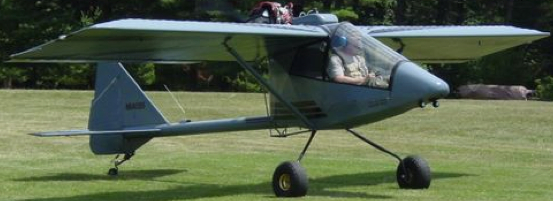

The antenna on my Slingshot is on the tail boom and has given trouble-free service with good transmit and reception. It is mounted on a hat shaped piece of aluminum, roughly 5"x5" riveted to the top of the boom tube with coax run through boom tube. It has room between the hat and boom tube to get to the connections. Seems that getting it behind the engine is indeed a good idea. I don't have detail photo, but this shot shows its location.
