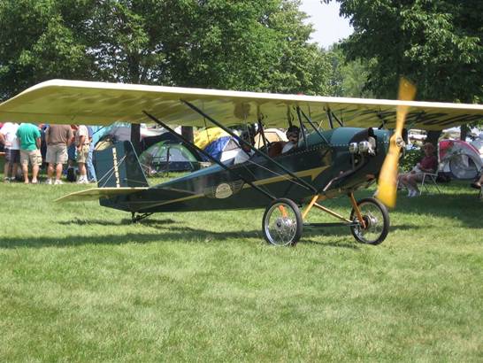

PostPosted: Tue Feb 21, 2012 6:41 am    Post subject: maintenance profile Reply with quote
My RV-4 does the same thing, as did my Cessna 140. This is simply a characteristic of spring type landing gear. They are designed for the wheels to have proper camber when carrying the weight of the airplane. As Bill pointed out, the maximum wear occurs when they are pretty much unloaded. If the gear were designed for the tires to touch down level, when the gear was loaded with the airplane’s weight they would be wrong and the plane would be difficult to control on the ground.
If you want to have it both ways, you need gear like my Pietenpol has:

Jack...Gorgeous airplane! Looks like a lot of fun. I've been toying with doing something like that as well for just buzzing around which the -10 has proven to be a bit expensive for thanks to current gas prices.
