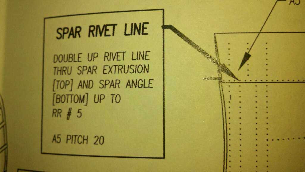

I found a step on print number 6-zu-3 thats not in the Upgrades photo assembly guide that I missed and know of a couple locally that did also.
See attached... (hope I can add this)
Lucky enough it fixable on a finished wing. Let me know if you did or did not catch it. Thanks!

        Andrew, I perused the prints extensively and I did catch it. I read it three or four times to be sure, though. Thanks for pointing this out. It may be of  great help to someone!!

I picked up on the doubling of the rivets during the upgrade but thanks anyway for posting it. You never know...

OOPS! Missed this one! Thanks for pointing it out. Luckily I can go back and pick it up because I haven't done anything else with the wings since completing the updates.

I initially saw this step when I started the upgrade.However ,I forgot to enter it into the data bank (my brain).....SMILE.I did catch it during my final review of the drawings after completing the upgrade.Easy to miss.Glad you put it on the list!

I had finished the left wing and am getting to button up the skins on the right before i noticed it. It caught my eye when i was looking thru the fuse update sections.... Only because a wing was on the fuse update drawings. lol
