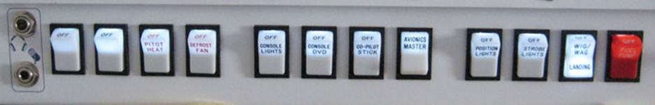

I have the Honeywell switches on my -10 and -8A. A few of them are 3 position switches. I use them for my:
Lights On/WigWag/Off
Safety Trim On/Off/Reverse (Reverse is momentary)
Both work great. I don’t see why you could not use these for your lighting needs.
