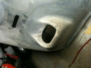

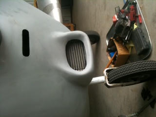

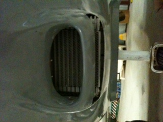

PostPosted: Tue Dec 27, 2011 10:51 am    Post subject: Re: 10 bar cooler Reply with quote
You'll notice I had to cut the bottom off of the cowl around the cooler to get the coil cooler to fit. This was kind of dumb and only made for more glasswork. A nice clean slice down both sites with a pice of scap aluminum and a few temp rivets to hold in place (spreading it about 3/4") works well untill the glass cures.If you slice all the way down both sides all you need to do is pry it appart lightly. And the oval opening will remain symetrical. Hindsight though. I'm sure each install and fitting of the cowling is slightly different. I've heard reports from some that they didn't have to modify the cowl at all, but then the oil cooler inlet still remains the same size which probably doesn't make it as effective as it could be. This has produced nothing but positive results for me.
