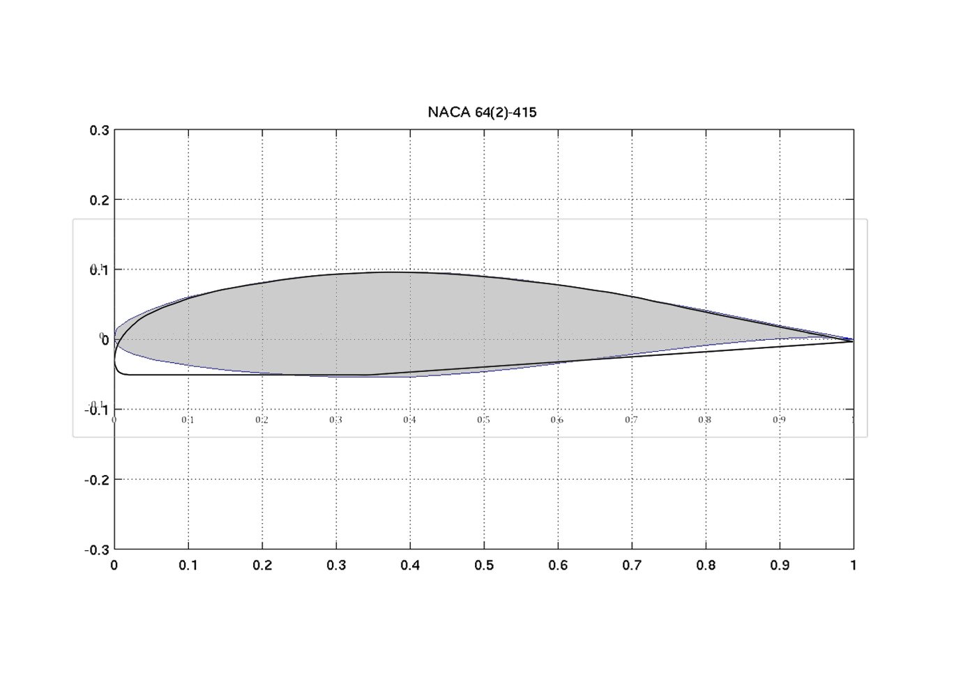

I was able to plot out the Grumman airfoil from the trace that Bob Hodo sent. The really fucked up a good design.
NACA 64-415
6 series airfoil
4 = minimum pressure at 40% chord
4 = .4 coefficient of lift
15 = maximum thickness at 15% of chord length.
What I measured.
- not even close to a 6 series
- minimum pressure at 34.15% chord
- lift coefficient TBD
- maximum thickness at 14% of chord.
The original airfoil leading edge was pooched out and rounded and brought all the way down to the bottom of the wing. The larger flap on the Tiger/Cheetah effectively makes the airfoil no longer anywhere near a 6 series (not to mention the round nose). The flap makes the upper surface reflexed when even with the bottom angle.
Still looking for an airfoil that is even close.
Gary

I've attached a pic of the Grumman airfoil overlaid on the original designed wing shape. In the previous pics, I extrapolated the angle on the upper and lower surfaces until they intersected. Yesterday, I measured the chord of the wingtip. The flap is actually longer than the optimum shape of a 64-415 wing. But, as you can see, with the flap up a few degrees until the bottom is flat, it's a pretty good fit.

*Note to Ned... if you get your rails to 2.5 degrees down all three of these surfaces will be in the wind shadow of the leading edge, instead of just the two surfaces aft of the spar.
4) The spar. It is a very strong structure, but it is thick. This means we are stuck with a thick cross section. I don't think there is any getting around that in the first two four foot sections closest the fuselage. But I do think the outboard section could be redesigned around a 6" OD pipe instead of a 6.6" one.
WHAT I WOULD LIKE TO SEE:
Change the ribs on the two inboard sections to one of the naca profiles that makes Gary smile, curvy on both sides, and maybe reduce the angle of attack about 1 degree on those sections.
Change the ribs on the outboard section to a profile that is about half as drooped as what we now have, with a curved bottom, and at least 2 inches longer out in front of a slightly smaller spar section. Remove 1 more degree angle of attack on the outboard section.
Get Gary to make an appropriate wing tip with upward flare rather than down, and slightly wider at the back than the front. (Go look at a Cirrus.)
THE GAIN I EXPECT:
A stall at least as soft as what we have now on the AA5-x, but with a wider window of aileron control well into the stall.
A minimum of 5 knots in normal cruise settings, and the racers seeing 10 or more knots at high power settings (above their already impressive speeds from drag clean-ups).
The stopper is not the work, or the expense of materials to make this wing vs the one they already make. IIRC Kevin Lancaster said TIGER AC had been outsourcing the Tiger wing at a cost to them of about $22,000 each. I think Trueflight intends to build their own.
We would not be changing the strength of structure, nor the assembly methods, just the flight characteristics, which ought to be pretty simple to demonstrate as being the equal or the superior of what we now have in any parameter that matters. The truth is, it is the wing we have been using for 35 years that is "experimental."
There is no doubt it can be done better. It amazes me how well this plane flies as it is. It is sitting there begging for some very obvious improvement.
