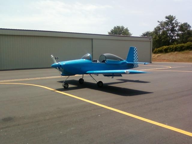

Stan, I'm not sure exactly what your asking. I built and fly an RV-8a which has a MGL EFIS with AP and SV GPS that I gain access to via a removable panel that I access through the baggage compartment. I have a new 406/9 kh ELT and invisible mounted antenna. What can I help you with? You can contact me by phone at 478-731-9678 or pm and best regards, Bill N288WP, RV-8a 30.2 hrs into Phase 1
