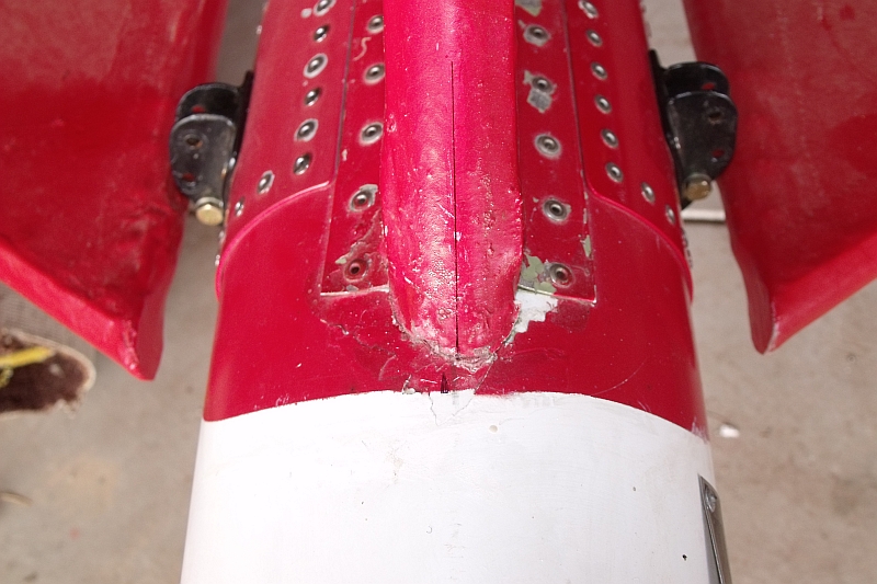

After my neighbor offered the observation that I seemed to need an awful lot of rudder to keep the Mk IIIX flying straight on take off I started investigating and found that the vertical stabilizer was off ever so slightly. See picture 1. I removed the rudder trim tab and flew the airplane. You can see from picture 2 that the airplane flew a bit sideways. The Yaw string is about 8" long and I'd guess it is deflected about 2.5" giving a side slip of a little over 18 degrees.
If you look carefully at picture 3 you can see how much the rudder is deflected to keep the airplane flying straight in level flight. Sorry, I've never tried to take a picture over my shoulder while trying to fly an airplane straight and level.
After the vertical stabilizer was moved to align it straight down the tail boom, I flew it again, still without a rudder trim tab. Under power, there was no change in the results shown in picture 2. Pull the engine back to idle and yaw string flows right down the line on the windscreen and the ball is centered.
Where the improvement really shown was in the power off stall characteristics. Before removing the trim tab, the airplane had a bad break to the left almost immediately at the onset of buffeting and it took rapid application of forward stick and right rudder to break it. Now with the trim tab removed, the airplane flies straight with the engine at idle and my feet off the rudder peddles. The stall is much more like that of my Mk III, no wing drop and recovery only requires releasing the back pressure on the stick.
I still have no idea why P factor is so strong in this airplane. I've checked the engine alignment and it is straight down the centerline of the airplane as best as I can measure it. Because Ken's prop no longer fits after I lowered the engine mount to the factory recommended height, I'm using my prop, adjusted for the difference in the gearbox ratios of Ken's engine (2.62) and mine (4.00).
So, I'm taking heart in the fact that the airplane no longer wants to break into a spin when stalled without power. I did not do a departure stall with it, if the weather is nice again tomorrow, I may work up my courage and give it a try. My airplane would not do a departure stall, it would just hang on the prop until I release back pressure. Somehow I don't think I'll get the same results with this airplane, but I've been wrong before.
Anyway, I think the airplane is much safer, although I can only fly it for about 30 minutes before I get a cramp in my left calf.

Okay, I'll go through this one question at a time."In less I'm miss interpreting your description I have to believe you were allowing the plane with the trim tab to yaw when going into stall."
Yes, the trim tab was pushing the tail to the right (nose to the left) and causing the aircraft to break hard left when stalled. With the trim tab gone and my feet off the rudder peddles the yaw string and the ball are centered when the engine is at idle. Any power above about 2800 rpm causes the nose to push off to the right. The more power, the more the right yaw requiring left rudder.
"Your photo was taken from one side so it will naturally look like it is defected. "
It looks deflected because it is. It takes about half the left rudder travel to center the ball and the yaw string. It's obvious enough that it can be seen from 200 to 300 feet below, that's why my neighbor was able to make his observation.
