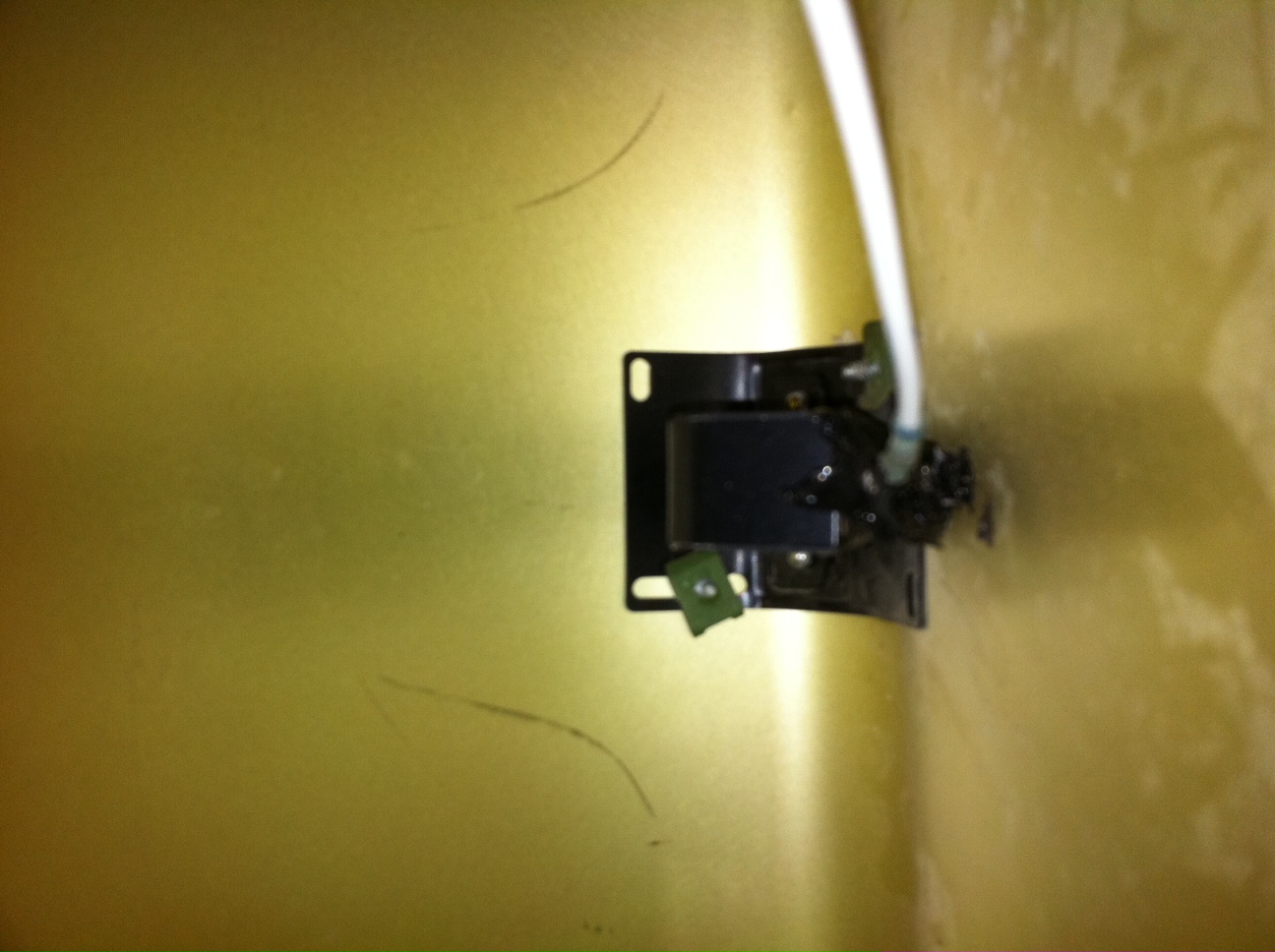

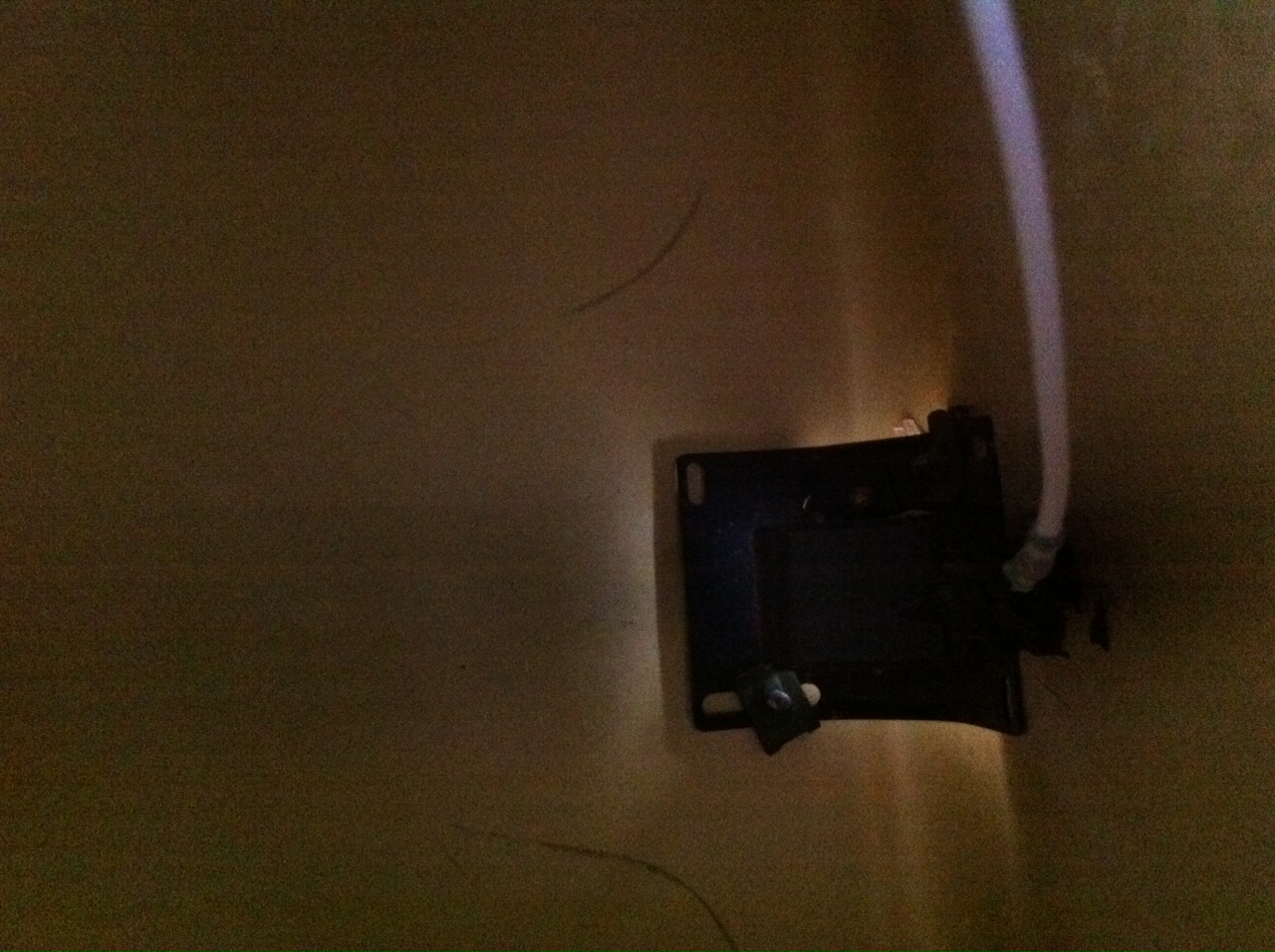

Anyone have a suggestion as to how to seal the stall warning switch? I checked and mine leaks air. To me that means drag.
So I'll have to figure out how to seal it
Here is a picture of mine
Notice all the light coming in around it in the second pic?
With camera flash on
With camera flash off. see the light coming in?

Well, you could use some thin foam or some silicone. However, do you
really use the stall warning horn? If you're really after getting rid
of drag, I'd drop the switch inside and secure it in the other holes and
then fill up the hole in the leading edge.
Just a thought.

Not being an experimental I have to keep the stall switch working in place.
I may try the silicone or maybe a small amount of touch and foam???
I have not held and looked over the switch itself. I think the leak is outside the switch. Anyone know if the switch itself leaks air thru it?
Well, only during the annual. Wink
And it depends on what your goal really is.
From the pictures it looks like the switch rests in the black curved
(plastic or metal?) part. The light is leaking between the leading edge
metal and that black plastic part.
If there is drag, as you say, with that air leakage I suspect it's down
in the nano knot range. You might consider leaving the stall switch
alone 'till the last 'improvement'. The stall switches are pretty
pricey, I think.
Linn
