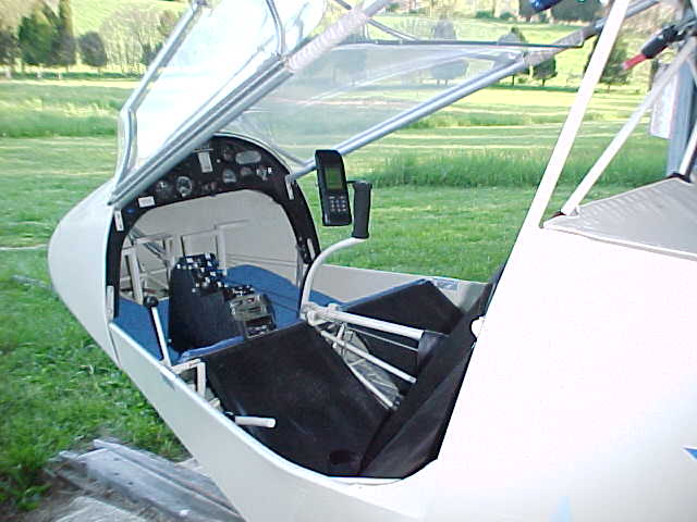

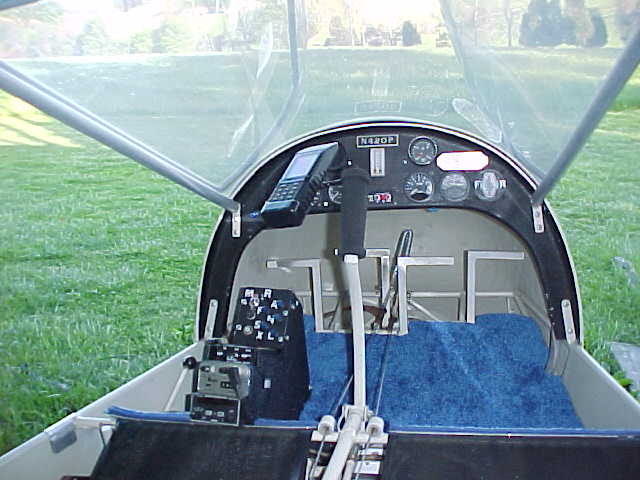

Make a bracket and mount it on the stick. Here's how:
Take a piece of tubing about 3" long and the same diameter as the control stick and split it in half. Spread it open a hair. Weld a 3/16" rod to the top of it sticking out sideways. Solder that to a piece of copper sheet (from the hobby shop) that is bent so that the gps fits into it snugly. Angle it so it is easy to see.
Roll the rubber grip back and slip the half tube into place, wrap it at the top with a couple wraps of electrical tape, it won't go anywhere. And (Taa-Daa!) you can poke the gps with your thumb without ever having to take your hand off the stick.
If you want detailed closeups, let me know, I'll get you some tomorrow.

Nice setup, Richard, thanks! I'm going to try the simpler way and see
if the RAM suction cup will stay on my windshield, especially since the
entire cradle is necessary with the 16 pins.
Richard Pike
Kolb MKIII N420P (420ldPoops)
richard (at) bcchapel(dot)org
Kingsport, TN 3TN0
Now faith is the substance of things hoped for, the evidence of things not seen.
Hebrews 11:1
http://forums.matronics.com/viewtopic.php?p=356146#356146
http://forums.matronics.com//files/interior9_129.jpg
http://forums.matronics.com//files/interior3_126.jpg
