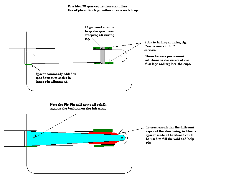

<?xml:namespace prefix="v" /><?xml:namespace prefix="o" /><![endif]--> Frans and others, Attached above is a drawing of how to install a wing rigging alignment device to replace the spar cups. It just attaches to the back of the fuselage.
Here is an excerpt from an email I sent to another Classic Owner (mono wheel) from my tech support file from a while ago:
There are a couple of things to look at with adapting the MG Wings to the Classic.
First, The Classic has the wing lift points set by the owner. Measurements vary somewhat from plane to plane as we have differences in builder abilities. The leading edge of the glider wing is narrow and the molded in attach point is smaller so the forward and aft sockets may not line up acceptably with the glider wing lift pin attach points.
Second, the fuselage must have Mod 52 to structurally take the stress of the motor glider wing loads. (If the Classic wings do not have Mod 74 then that must be done also for your own safety.) Your task is easier if the Mod 52 is not done. If the mod 52 is in, just try the wing rig first and see if the attach points will align, see below.
Third, should the glider wing fore or aft attachment points not line up with the glider wing, don't fret:
I have found it very easy to just move the attach points of the Classic fuselage to the glider wing position and simply remove and replace the pins in the Classic wing. The reason it is easier, as it seems to mean changing 8 hard points, is that it is technically easy, it will make rigging and de-rigging of the plane a snap and assure structural strength. The Classic wing is very easy to remove the pin attach points, and frankly I replace the aluminum one inch strips with two inch strips making a stiffer attach point as in the XS model. The socket attachments are quick to change also. Just unbolt and gently heat and remove, then grind the glass down. I pull out the aluminum wing root plates and replace them, as it only takes a few minutes with a dust mask and a grinder to remove. Total time with a die grinder and 40 grit paper is about 2 hours to remove the wing attachments and 2 hours to completely replace the aluminum plates with all the parts made up and on hand. It takes me 8 hours to remove the fuselage sockets and the glass and wood spacers on the fuselage side and replace them to new. Like I said, I remove the aluminum plates imbedded in the fuselage if the holes are just too far off. Hopefully you don't have to. If I have to, I grind away at the skin over the aluminum plates in the side after the glass is removed and allowing the now warm metal from grinding to detach from the inside skin, or by using a bit of heat from a soldering gun and I apply a prying force to the edge of the plate. I make another aluminum plate and install. 8-12 hours to remove and replace plus cure time. So a couple of days and you have a pristine fuselage side ready for a perfect alignment of both wings.
This is not a daunting task for me, but I am more familiar than the average guy. If your original builder did a precise job of aligning the pins on the Classic, you may have no problem or only a problem with aligning the front or the rear glider lift pin. I have found one of them to be just a bit high leaving the upper skin very close to the pin attach point with the glider wing perfectly aligned. We just did a Classic and I am uncomfortably close to the top of the attachment area on the rear pin support, instead of centered in the pin area. If it were my plane I would have centered the pins and moved the fuselage sockets, but I tend to prefer to shoot for the optimum, and my clients are wanting the quick solution.
Don't let a bit of glass work over a few days or a week keep you from having the joy of a soaring airplane. I can't tell you how enjoyable the motor glider is. I hope you saw my article in the Europa flyer on cross country in the MG. If not send me an email and I will send a .pdf copy. The mono with motor glider wing is carrying a hundred pounds of extra wing weight so make sure your rubber block is new as your normal touchdowns will need to absorb the extra mass.
