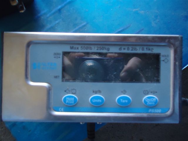

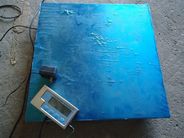

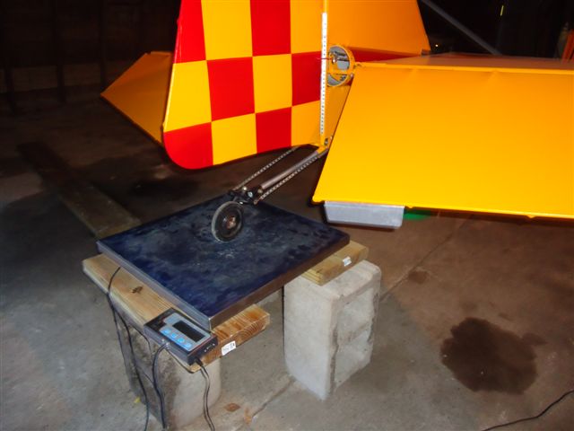

I decided to rent a professional scale from the airport and eliminate the bathroom scales. Tomorrow we will redo the W&B and get it down to a Gnats-Ass .
No responsible pilot wants to fly fudging numbers. There is enough risk in flying an experimental aircraft already !
Stay Tuned !

Good News
After a W&B redo and a quality scale we found I'm still far aft. But safely within my cg envelope limits. Exclamation
