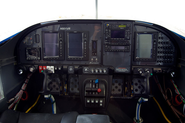

Dave, I have 115 hours on my 3 screen G3X and loving every minute of it. The iBBS back-up battery works great with the system. The system has dedicated pinouts for the iBBS. I also have the D6 as a AHRS/MAG back-up with an internal battery. I was also one of the last 430W buyers but would jump on the GTN750 if it was available. I played with one too and super user friendly. A lot less button pushing compared to the 430W or 530W. All the new jets have G1000/G3000/G5000 with touch pads so the touch screen is where it is going and turbulence must not be a factor if these are getting approved. I think turning a knob and pushing buttons in turbulence might be harder than using the grips and pushing a touch screen but I have no real experience in turbulence while using the touch screen. I seam to get by pushing my iphone touch screen while I'm listening to music through my audio panel.
Here are some pics of mine . I need new ones to show my interior panels from Aerosport.

About the comment on the Dynon Skyview - I did not consider it because of three reasons. First, they work only with their own autopilot which is internal to the EFIS. In the event of an EFIS failure you are out of luck but with all the other units, assuming you are using an external A/P, the A/P will fly the airplane. Second, it does not have XM weather capability. Third, it can not do a complete coupled approach, lacking vertical navigation. While I think the Skyview is a really nice unit (and may put one in my VFR RV-6), it did not measure up to the other choices. I'm sure some will disagree with me about whether these are worthy points or not.
I hope Dynon catches up but they seem more interested in the LSA and VFR market.
I wish I had the GTN-750 rather than the 650 because it is a joy to look at and use. From a pure functional standpoint it does not do much more than the 650 but if I recall, cost about $6-7K more. My heart told me to buy it but my brain overrode.
I like the panel shots. The G3X fits the panel nicely without being overcrowded. I have mounted all the avionics and was also able to do it without touching the ribs in front of the panel.

Size of the G3X screens was a big concern of mine before and when I got them. They are great when actually using them. They are only two feet away and probably have the same font size as the competition. I have flown behind Cheltons, GRT, AFS, G1000, SPZ5000, Primus 1000, Proline21, and the DA900EASy. I think Garmin has all you need in these boxes plus some. I like mine more than any of the others but again it's mine. The landscape is more broad in some of the others with synthetic vision, but the same info is there. As far as databases....well I spend 1300 per year on the Garmin bundle and the XM so that could be a lot better. Hopefully that will come down. I see they have a special with the 750 but that doesn't help me with my 430w.
I think ease of use with the GTN 750 is the gain in capability.
