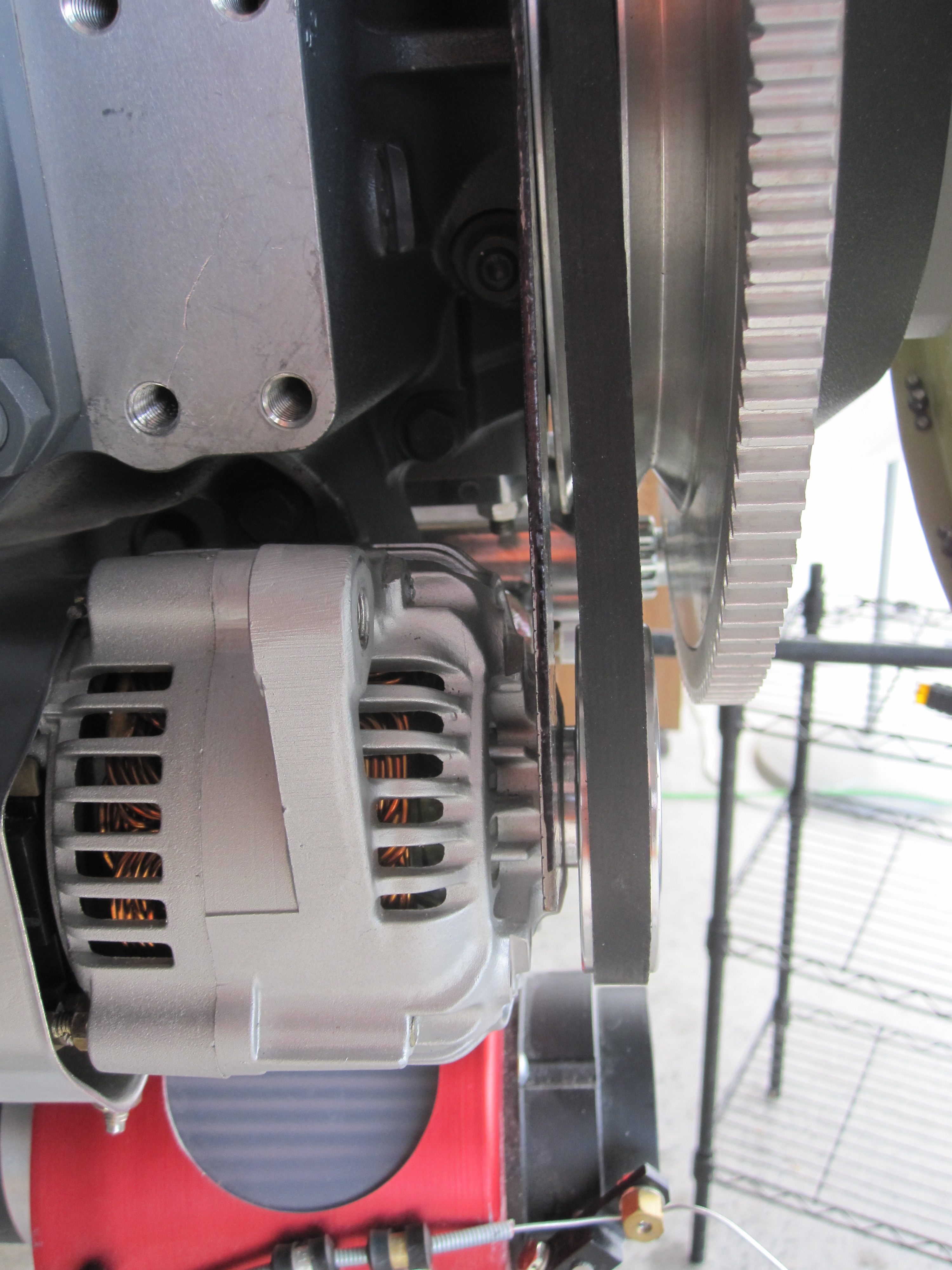

I’ve been talking with Dick Carmichael at Plane Power about an alignment issue on my RV-10 between the pulley on the Plane Power 60a alternator and the pulley that came with my IO-540-D4A5, which were both purchased through Van’s. I’ve attached a photo for review. In the photo, I’ve also placed a square against the back of the Lycoming pulley.
As you can plainly see the alternator belt is out of alignment. In talking with Dick, he stated that this is due to the dual belted pulley that came with my engine. He further stated that he couldn’t guarantee that the belt would stay on and it clearly would have a shortened life due to the misalignment.
Since there are no user adjustments for this alignment with the Boss mount, I’m being told by Plane Power to use a single belt pulley on the engine.
Is this the standard pulley for an IO-540-D4A5? Plane Power is giving me the indication that this is not the case. Is there the possibility that the incorrect part was substituted by Lycoming?
Has anyone else run into this problem? If so, what did you do?

I have the YIO-540D4A5 (no certification paperwork) bought thru Vans, and it came with a single belt pulley.
I have found Williamsport to be very accomodating; my engine came with a light weight starter and I requested it be changed to the heavier unit (per the starter company's recommendation) and Lycoming immediately sent one to me.
I'd ask them for the correct pulley.

Bob, Why do you have a dual belt prop pulley? The standard pulley is a single belt. The only reason I’m aware of for having a dual belt is to accommodate an A/C compressor. For those installations w/ A/C they have been relocating the alternator to the other side of the engine and placing the compressor where the old alternator was?

That’s what Lycoming shipped when I ordered the engine through Van’s. It wasn’t an option that I chose.
Gus at Van’s stated that is what Lycoming now ships on the YIO-540-D4A5. However, I know of at least two other folks that got the single pulley. Gus stated that Lycoming would swap it out for me.

Did you get a parts/o-haul manual with your engine? I’ll bet it doesn’t list a dual belt as standard. Go for the exchange. It’s disappointing to hear Van’s give crappy advice/info.
Deems
You might want to see what a single pulley flywheel goes for, and sell the dual pulley, When I ws considering A/C and looking for a dual pulley, it was going to cost me $1200.

That definitely is not right. I've never seen that problem before. Could the alternator bracket is really to only variable that I can think of. Can you get some measurements off that and have people on the list compare?
As Deems said, I have only seen the dual belt pulley used w A/C, although in the most recent installation I have seen the compressor was on the left side and the alternator stayed on the right. That was an RDD installation of the Flightline A/C system.
I think somehow your alternator bracket is wrong.

This change of std pulley shipment started fall 2010 or before. I have the same dual groove/pp setup as Bob.
Not only are the pulleys out of alignment fore-aft, PP's bracket has the pulley/flywheel not in the same plane. Very unacceptable engineering and lack of communication between Vans/Lyc/PP.
Wayne G.

Wayne Gillespie also has the same issue.  Vans or Lycoming had better get the word out they have a serious field problem about to show up!  Wonder how many are out there and no one has spotted the issue.  How many are flying or about to?
Wayne invited several RV-builders to pre-inspect his build prior to DAR inspection.  We found the same issue on his engine.  He is going to correct it prior to flight.  Machine new spacers to relocate the alternator slightly aft.  But is a problem that must be solved prior to flight.

I have the dual flywheel pulley on my rv10 because I have air conditioning. The Plane Power pulley was way off when I first installed it. I had to make a different spacer and mount the alternator on the back side of the bracket to get the belt in alignment. If you are interested in pictures, let me know. I will have my cowling off next week.
The alternator is mounted on the right side of the engine (per Vans) and the compressor is mounted on the left side.

Putting together comments from several people, it appears that Van’s and Lycoming made this change about two years ago.  The comment that I got was Van’s was that most of their engines are going to Brazil and they use a/c.  Somebody made an executive decision and didn’t inform Plane Power.   In talking to them, they are very anxious to solve this problem, but appeared to be caught off guard.  I guess folks are modifying brackets and spacers themselves.

I installed a dual-pulley ring gear with a standard Plane Power alternator and it lined up perfectly. I wonder what the difference could be.

Seems to me that the easiest fix would be to machine the difference from the back of the alternator pulley to bring the belt into alignment.
bob

Machining the pulley may be an option after engineering approval from PP. I would not want to weaken the pulley too much.
While waiting for all of this to get hashed out I am going to pull the rear spacer and machine it down approx .120 then add two 7/16" AN washers to front spacer. Also I am going to straighten tension arm.
Once PP comes up with a fix I can swap out the parts.

So I have had conversations with Vans, Lycoming, and Plane Power.
Vans passed the buck even though they made the change to go with the dual pulley flywheel about two years ago from what I can tell.
In talking with Lycoming, they were unaware of the issue with the Plane Power alternator not aligning with the dual pulley flywheel. It has been escalated to their engineering department and I'm awaiting a response from them at the moment. The mentioned that 2/3's of the YIO-540s sold to Vans are going to Brazil.
Plane Power states that there alternator will not align with the dual pulley flywheel from Lycoming. They are anxious to resolve this issue. Both Vans and Lycoming are big customers of theirs. They were going to call both Vans and Lycoming today to discuss the details. (Jesse they were curious as to how you got your's to align without modification)
At the moment, there appears to be two solutions.
1. Van's must indicate an option to choose whether or not you need a single or dual pulley flywheel.
2. Plane Power must fabricate a new bracket for the dual pulley flywheel.
Both Lycoming and Plan Power seemed frustrated since Van's only wants to order a single sku from them. It appears that Van's made this change, but didn't coordinate with both company's engineering departments to ensure that everything worked.
At this point in time, I'm awaiting responses from all three vendors to see how the choose to resolve this issue. I'll keep everyone posted.

aircarepros(at)yahoo.com
PostPosted: Tue Oct 11, 2011 9:07 am    Post subject: Plane Power and Lycoming Pulley Alignment Issue Reply with quote
John at Flightline here. The best PMA part for a dual groove pulley is the
LW-10184. It retains the original groove from the Lyco 540 10" pulley, as
well as adds the one we need for ac. I can't speak to the alternator
alignment as there are so many, but I haven't heard any complaints about the
belt alignment of the Plane Power or the B&C until this thread. We have had
numerous instances where people have thought that they were being sold a
dual groove pulley with their engine only to find out that it was a trim
groove, not a belt groove to shave weight from the pulley. You might be
looking at such a situation here also. The true 2 groove pulleys are
exactly the same at the bottom of the groove. The single with the shaved
groove is different and typically places the belt right up against the body
of the ring gear support.

rv10flyer
Joined: 25 Aug 2009
Posts: 364
PostPosted: Tue Oct 11, 2011 9:25 am    Post subject: Re: Plane Power and Lycoming Pulley Alignment Issue Reply with quote
Mine is LW-12227. The fwd groove is a vee shape and the rear is a u shape. Maybe just for reducing weight but the rear u shaped groove is approx .120" aft of PP alt pulley groove.
Wayne G.
rv10flyer
Joined: 25 Aug 2009
Posts: 364
PostPosted: Tue Oct 11, 2011 9:30 am    Post subject: Re: Plane Power and Lycoming Pulley Alignment Issue Reply with quote
O.D. of my pulley is approx 9" and I had to purchase a Gates 7328 belt to fit.
