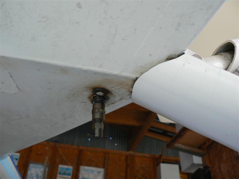

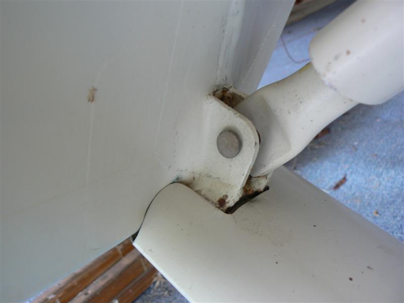

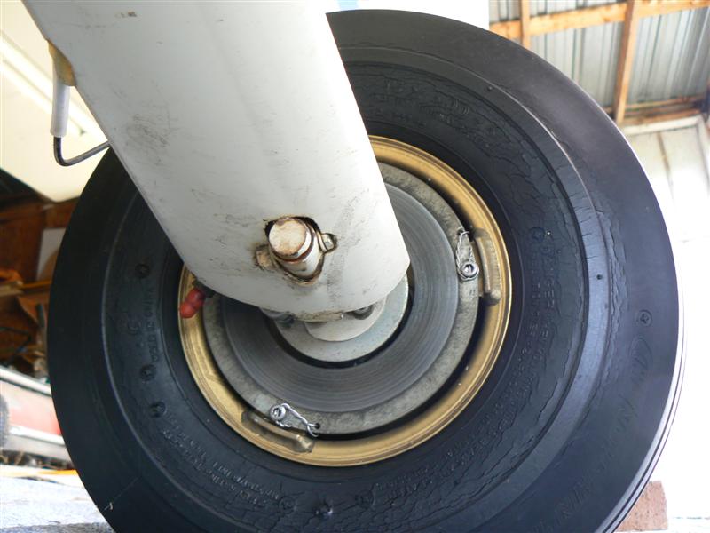

Richard Pike
Posts: 1671
PostPosted: Mon Oct 10, 2011 8:22 am    Post subject: Re: Strut Fairings Reply with quote
Dennis Thate wrote:
Richard,
How about a close up photo of this stream lined landing gear idea, is it riveted like the wing strut covers ?
Here ye be! These are the plastic lift strut fairings that Kolb sells, cut down to fit. I make paper templates of how I want the top and bottom to fit, do the bottom first, and the top last.
Jack the airplane up and remove the bolt that holds the gear leg in place, slip the fairing over the leg and then put the gear leg back in the socket. Do the bottom first, a Moto-Tool works well. Then with the leg slid most of the way in to where it needs to be in the socket, make the upper template out of paper and trace it on the leg. Keep cutting it off a bit at a time until the leg goes in far enough for the bolt to fit. I probably put each gear leg in and out 25 times.... groan... A tedious process, but gives decent results.
Because of how the fairing slips over the top and bottom hardware, it does not need to be anchored to anything, it cannot rotate or move enough to matter. I ran my brake line down the inside of mine. Just a word of warning - mine were not symmetrical, the templates for one side were close for the other, but not quite. Why? - ??? So don't assume.
 Filesize:  64.01 KB
 Viewed:  21648 Time(s)
 Filesize:  32.61 KB
 Filesize:  38.35 KB
Richard Pike
Kolb MKIII N420P (420ldPoops)
Kingsport, TN 3TN0
