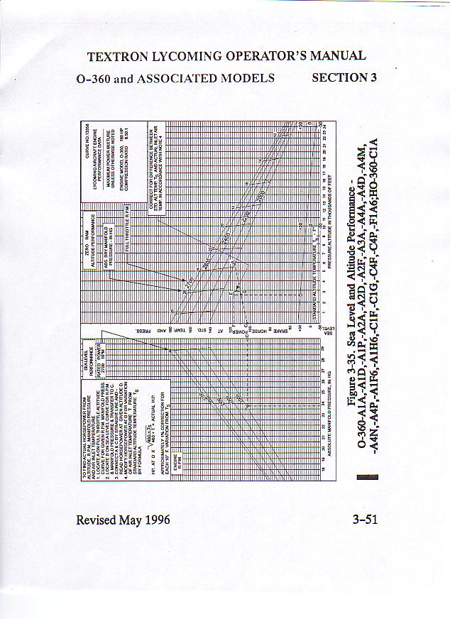

Here ya go
hp = torque * RPM / 5252
otherwise check your POH cause it's different in each plane or
see attachments for O-360

I should have been a little more specific. I'm looking for a formula that computes % HP from parameters that are measurable .... fuel flow, OAT, RPM, MP etc. so I can display the value on my EFIS. Since the EFIS measures many parameters a formula could compute % HP realtime. Hard to fly and look at the graphs ...... Razz There is a formula from Van's (below from another email) but it doesn't seem to be accurate for different size engines (not sure which engine really fits), and I don't have the math skills to tweak it. I was hoping someone might have the magic bullet.
