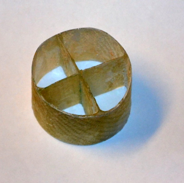

Hi Bob,
I'm not sure I know what you mean by installing a splitter in the air intake tubing to the carburetor. Perhaps you did something like I did but use a different word for the device.
I made a "Straightener" and installed it just before the main input to the carburetor. Here is a picture:
[img]cid:part1.05000809.08030307(at)att.net[/img]
I made and installed this part after having the engine run a bit rough when going from high cruise to WOT. I'm not sure it actually did any good because when I installed it I noticed the carburetor was not properly attached to the engine. After properly attaching the carburetor and also installing the straightener the engine ran very smoothly all the way to WOT. I just don't know which change actually made it work correctly. (The straightener I made is 1.5 inches deep and 2 1/4 inches diameter.)
