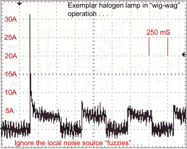

Not sure 'current ramping' would have a very useful effect.
Some of you may recall an experiment we did some years back
to evaluate the usefulness of inrush-limiters in wig-wagged
landing lights. Remember this plot?
http://www.aeroelectric.com/Pictures/Curves/Wig_Wag_Currents.jpg
We discovered that the lamp temperature stays pretty warm
during a 250 mS off-cycle such that you don't see the typical
cold-filament inrush each time the lamp is powered up. But
the temperature excursions between no-visible light and full
intensity is still significant. It may well be that the very
thing that makes the halogen a stellar illuminator amongst
incandescent lamps is it's Achilles Heel as well.

PostPosted: Sun Sep 11, 2011 7:57 am    Post subject: Halogen bulbs with wig wag circuitry....failure mode Reply with quote
Wig-wagging really big halogen lamps is also easy providing a current surge protector is used. I have demonstrated 2X 250 watt lamps wig-wagging happily with our WW(c) or WW(d).
Inrush current beyond the initial cold
start is not an issue for incandescent lamps.
The reason I plotted the this data . . .
[img]cid:.0[/img]
was to show that while the first, cold start inrush was the typical
30+ amps, subsequent start up currents were quite nominal. The lamp
being tested had a nominal on current of 4A (55w) but as you can see here,
the average start up current in the wig-wag mode was a tad above 5A.
This is because the filament doesn't cool off enough between flashes
to push the inrush even close to a cold-start value.
It isn't inrush killing these lamps by flashing them, it has to
be temperature cycling . . . for which there is no mitigating 'fix'.
After all, the reason these filaments produce white light is because
they've been elevated from below a dull red glow to the white light
produced by a metal glowing at 5000 degrees F. THATS a big temperature
shift.
I need to re-plot that trace above. There was some very strong
noise source going on at the time that produced the fuzzy spikes
on my data.

Sure . . . The purpose of study was to support a
discussion about the NTC thermistor style current limiters.
These things 'work' when allowed to heat up past the
resistance vs. temperature break point where the
device's resistance falls to some low, tolerable value
of series resistance.
I think we were talking about the CL series limiters
http://search.digikey.com/scripts/DkSearch/dksus.dll?Detail&name=KC023L-ND
http://www.ge-mcs.com/download/temperature/920_325a.pdf
These stay in a low resistance state by a sustained
current flow and have a 'cool down' requirement of
2 to 20 seconds for them to 'reset' and be capable
of limited the next inrush event.
The discussion concluded that the thermistor style
device would perform as needed for the initial cold-
start transient but was too slow to help for closely
space repeat transients. The data plot showed that
second and subsequent events in an incandescent wig-wag
system were insignificant.

Nice graph of the pulses.
That's a plotting feature of even the low cost lines
of most 'scopes these days. I can plug a thumbdrive
into my TEK TDS220 scope and dump the screen to a
.jpg file. I can also get a dump of the numbers for
use in other analysis.
