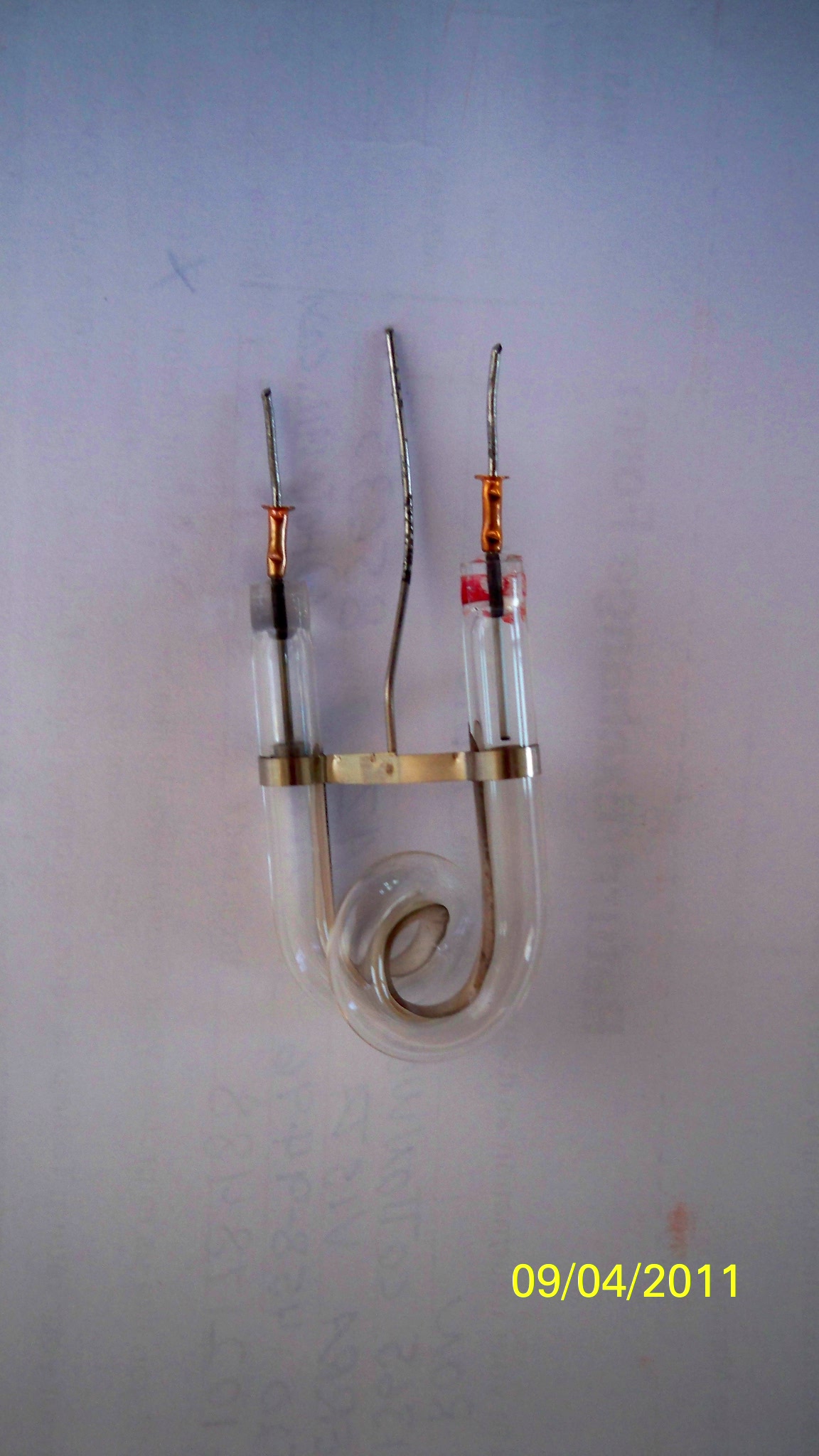

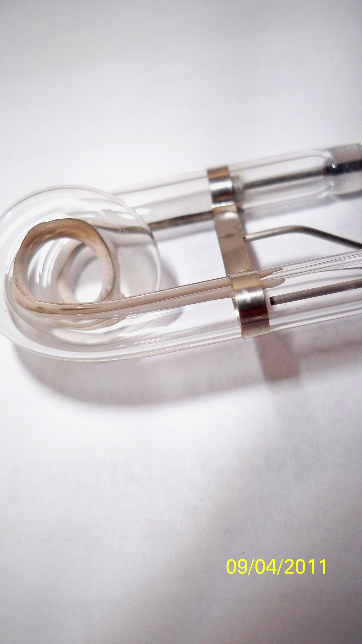

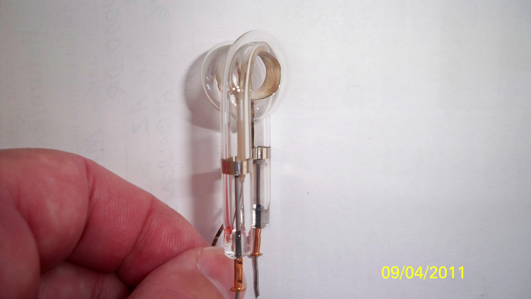

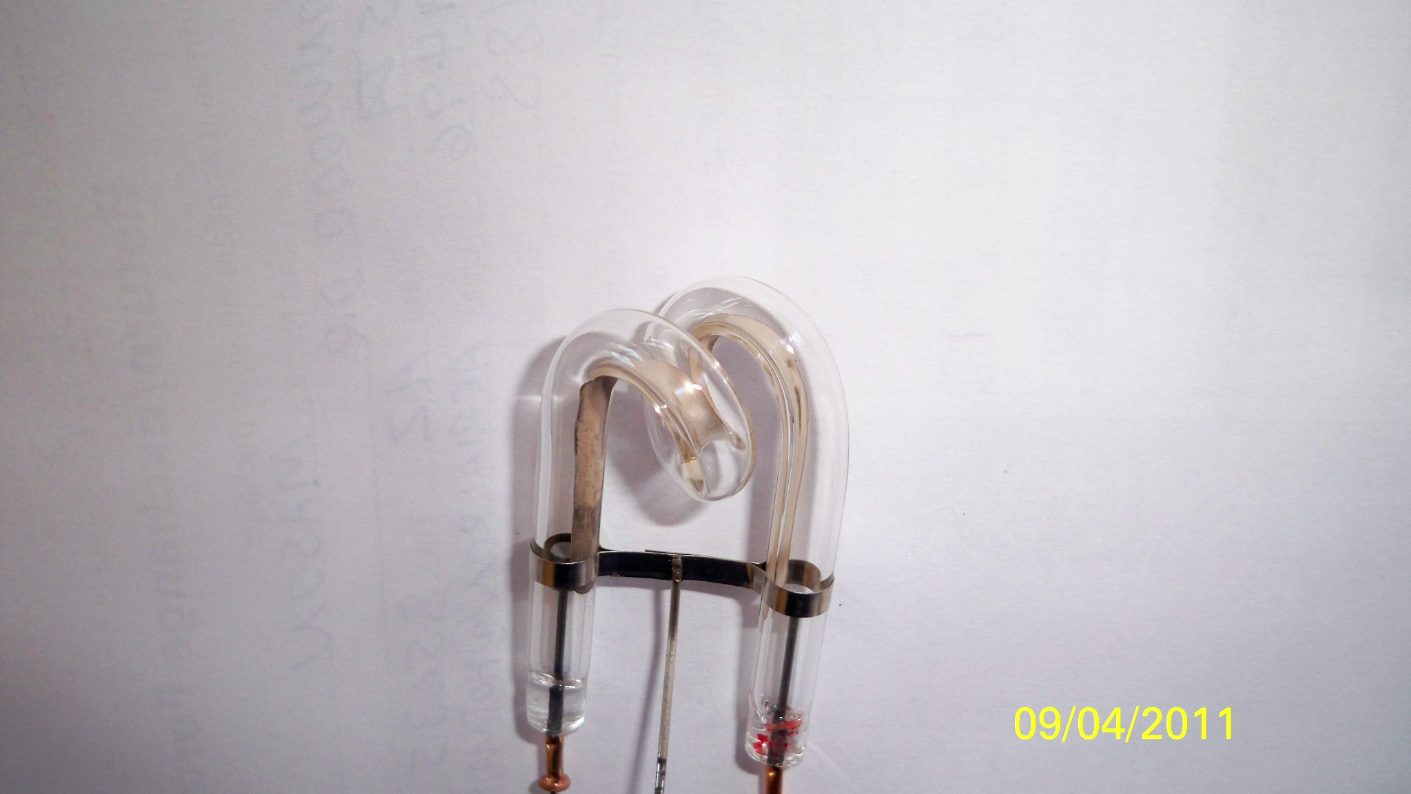

I am (guessing) pretty sure as I see no filament and I run an ohm meter across the prongs and it showed nothing. Those things do have a filament right? its not some fancy gas plasma gizmo. I don't remember what it looked like before I had it mounted kinda expected it to last at least 10 years or so.
I'll try to upload a close up photo of it a bit later as it is sitting by the other computer. I can still cancel my order with aircraft spruce it ain't shipped yet.

PostPosted: Sun Sep 04, 2011 12:14 pm    Post subject: Strobe Light Reply with quote
Okay that's good, now if I can figure out who else sales these bulbs I guess I can get it for a fraction of the cost. I a, wondering about the probability of this being a custom bulb just for the FS1440.
I am gonna load up a photo and if someone recognizes this as a generic bulb for 5 bucks I'll owe him her a beer. I'd prefer a her but you know how it is.............

PostPosted: Sun Sep 04, 2011 4:46 pm    Post subject: Strobe Light Reply with quote
First you gotta come up with a bulb, smart stuff.

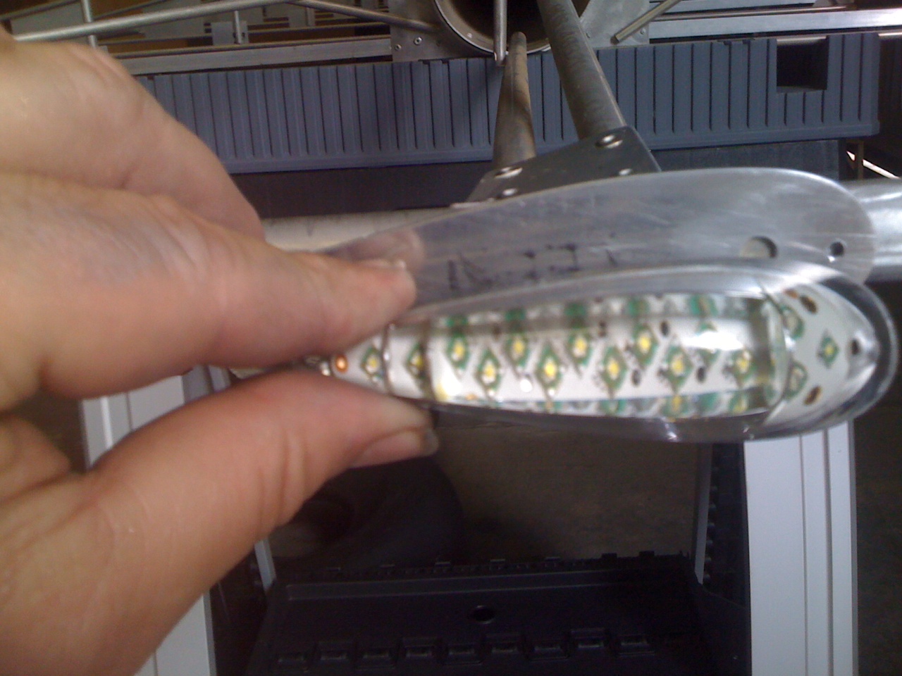

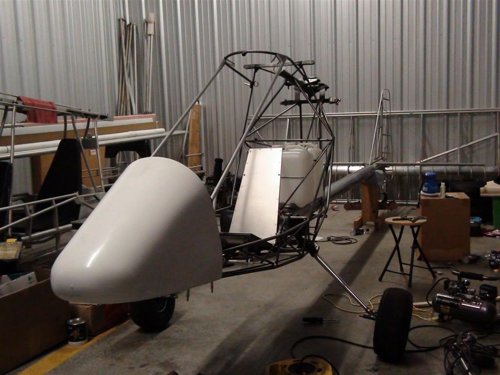

I just got off the phone with Rotax Rick a few minutes ago. He is going to be building the 670 for me..... It is going to use a Exhaust like what is use on the 618's.......... The FireStar II is just about finished other than beefing up the cage for the 670, and I am installing a mount for my new Aveo PowerBurst Strobes........ These Strobes are Awesome and well worth the price of around $400.00 for the Pair
The 1st Picture is of the FireStar II as it is Now
