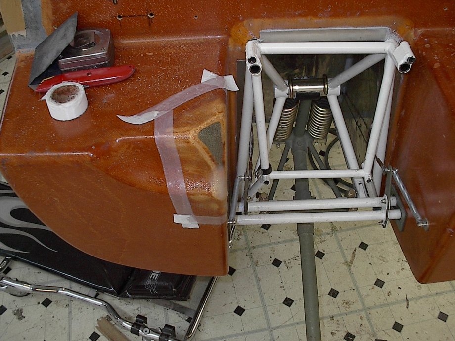

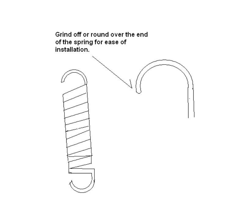

Attached is a drawing of how I round off my springs and a photo of how we keep the spring from grinding into the steel frame by using small bits of stainless.
Note that I install the springs with the openning forward. Please note the left and right hand wind requires you to place the springs so that they do not rub against the center tube.
The springs can be installed facing aft but the last snap in is a bit difficult unless the entire wheel well is open or you are very strong.
Forgive me that I do not have my tech article on how to install the springs any longer as folks were just not having problems and it went to archive somewhere. Bob Borger and Gary Leinberger may have photo's of us doing theirs if you ask..
Please round over the spring as per the drawing to make snapping the spring over the top tube less painful. You may do the lower part as well.
One indispensible tool is a piece of stainless cable with handles on both ends to snap the spring up and over the top. I have one of the guys standing on the wheel well and pull it up to snap in the spring over the upper tube. Then he bounces on the front until the 5/16 and 1/4 inch bolts fall out.
The other nice to have tool is a set of threaded rods with a couple of curved ends to help hold the gear up while I install, but rope or a strap works also...I just like steel to protect me from a rope brake or strap slip. It takes me with two helpers (for added weight), about 45 minutes to install the springs.
[url=https://skydrive.live.com/redir.aspx?cid=2161856909618aa7&page=play&resid=2161856909618AA7!137&parid=2161856909618AA7!136&type=1&authkey=KzlAF!wKhQk%24][img]cid:008801cc65d5$1e17afd0(at)goldfishbk2xxe[/img][/url]
[url=https://skydrive.live.com/redir.aspx?cid=2161856909618aa7&page=play&resid=2161856909618AA7!138&parid=2161856909618AA7!136&type=1&authkey=KzlAF!wKhQk%24][img]cid:008901cc65d5$1e1a20d0(at)goldfishbk2xxe[/img][/url]
Small pieces of stainless between the spring and frame glued in or just set in sealant will keep the spring from scratching up your frame and rusting later on. Even with an engine on you can see that putting a cable through the hook on the spring and pulling from above is an easy safe method to snap the spring in. Technique: I normally put the engine on to add weight when I am doing this operation alone. I put a strap around the gearbox and nose gear leg to pull the spring a bit to get the bolts to fall out then repeat.
Please use safety precautions so as not to injure yourself when stretching and installing the springs and you will find it is an easy install.

Thanks for the detailed reply.
In the May 2006 version of the Mod it looks like the openings face aft but in the 2011 version the opening is forward. I elected to use the latest version for guidance. The Landing Gear Frame in my kit has several additional members so there is not much room for the upper hooks to move in either direction - they are trapped between two narrowly spaced tubes.
In my case your other suggestions about getting the springs in place don’t apply since I am doing Mod 71 right after Mod 72, so the engine is on the floor and not in the way. I also eliminated most of the hassle getting the springs in place by removing the tie wires and the four bolts on the pillow blocks that are the pivot points for the nose gear arm. With the leg free to move a bit (still restrained by the safety cable) I could get the lower hooks in place with minimum fuss.
Of course, with the engine on the floor that leaves me to contemplate how to load the springs with sufficient force to remove the spacers.

Rob,
[url=https://skydrive.live.com/redir.aspx?cid=2161856909618aa7&page=play&resid=2161856909618AA7!137&parid=2161856909618AA7!136&type=1&authkey=KzlAF!wKhQk%24][img]cid:image004.jpg(at)01CC6618.7F05B330[/img][/url]
[url=https://skydrive.live.com/redir.aspx?cid=2161856909618aa7&page=play&resid=2161856909618AA7!138&parid=2161856909618AA7!136&type=1&authkey=KzlAF!wKhQk%24][img]cid:image005.jpg(at)01CC6618.7F05B330[/img][/url]

<?xml:namespace prefix="v" /><?xml:namespace prefix="o" /><![endif]--> Rob,
There isn't much room but it is sufficient with the hooks forward in the 2011 (which I still haven't seen final) version which is how I do the mod. If you don't have the engine, make friends with three 200 lb. agile guys to spring things into action.
I am surprised that you don't leave the gear leg attached final as it is quite easy to snap the spring into place even working alone. As Bob Borger indicated in his email it takes a bit of rounding of the spring end, and a bit of a pull to get them in. One thing that was not forwarded though is I use a few 5/16 inch bolts to help lengthen the spring. Hopefully Bob's photo album shows that we took the time to prep and make sure the spring was dead straight.
I have an unfair advantage that I have done many of these and frankly miss what I consider is obvious, which is not.
Apologies for leaving that info out.

Thanks again, Bud.
What I had not indicated is that I had all of my landing gear hardware powder coated so I tried hard not to damage the integrity of the coating (unavoidable on the Landing Gear Frame), ergo, drop the gear leg and place the lower hooks with minimal damage. In retrospect, perhaps flexing of the gear legs during even normal landings will craze, or worse, the powder coating. Too late to worry about that.
I may try a long lever arm bolted to the LGF to assist in loading the springs in order to remove the spacers.
Best regards,
