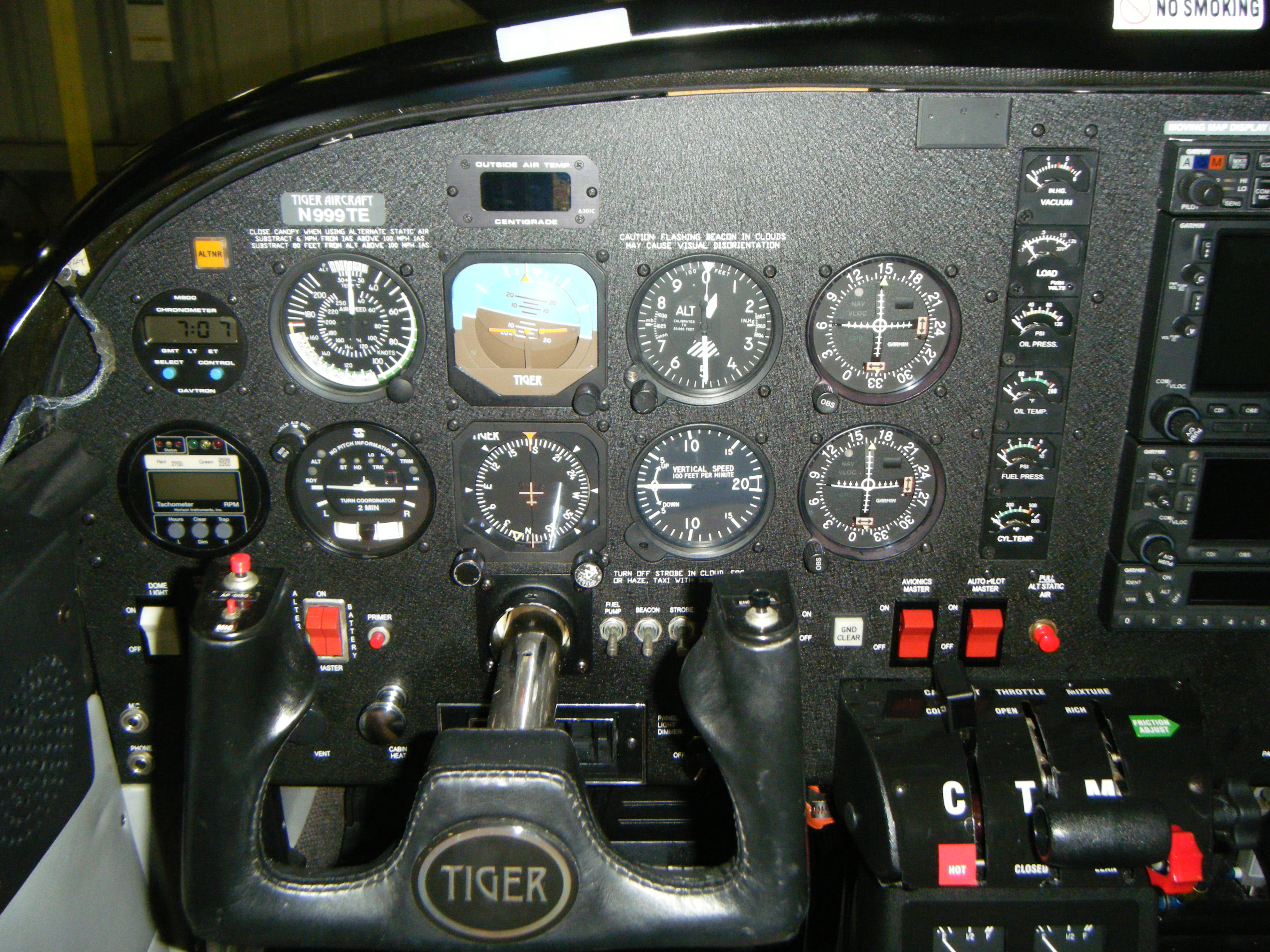

Thank you both very much for the quick, and thorough, responses. I’ll attach a picture of the amber Alternator light- top left panel. I have the Zeftronics 24v solid state voltage regulator- just like the one in your picture. The light will flicker intermittently regardless of RPM. It may remain off for over an hour of flight and then begin to flicker (with no change in charging voltage as noted on the EDM 700).
This system does seem way more complicated than it has to be. I have flown experimentals with GM alternators/ internal regulators that never missed a beat.
Gary- I will start checking the grounds and the connections… sounds like I have some work ahead of me. Am I correct in treating this as an “indicating” problem and not a “charging” problem? I can verify proper alternator operation with the EDM 700 and the load meter/ voltmeter. Thanks again for all of your help!

I agree with Gary about you may have an intermittent ground. I had one about to happen when the starter relay wire fell off on my hand.
I too have flown experimentals with internal regulators. I would encourage you to do anything you can to change it to a controllable external regulator. Or wire it with a relay.
I had the internal one fail and start pumping 30 volts into my 12 volt battery. There is no way to shut an imternal regulatir off when this happens
See Bob Knuckols at aeroelectric.com and on matronics.com for all the details on this and how to isolate the beast.
By the time I got the plane on the ground the battery was fried. I was fortunate that it did not blow up and make a mess like one did in my mother inlaws car!
Ned

In general, the indicator on an AA5B only indicates if the ALT side of the Master is on and therefore putting power to the field. It's possible the one in an AG5B does the same. Check the back of the Master and make sure the connections are tight. I remember having a problem with a Cheetah (no light) that made the amp needle wiggle. It was a loose connection on the Master Switch. May or may not have anything to do with an AG5B, but, what the heck.
Gary

That reminds me that my light used to flicker and my avionics guy told me to spray electrical cleaner into the master switch and work it on and off a bunch. That did away with the flicker. I took the battery ground cable off first.
It would be worth trying
Ned
