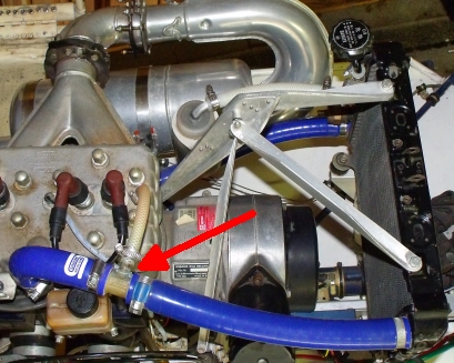

A car radiator is too big for anything that travels faster than a PPC. What you want is the radiator from a Honda Sabre or Magna motorcycles. I've converted two 582 powered Kolb Mk III's and both work perfectly even in the Kansas heat. See the attached article I wrote for the newsletter of our local EAA chapter.

Arty, You misunderstood the point of my article which was about finding a suitable radiator for a 582 in a PUSHER configuration, specifically that the Rotax twin radiators are not suitable, IMHO, for that configuration. The pictures, both in the article and those included in the post show the Honda radiator used in a pusher configuration. There's one other consideration that might be of interest to you. The Honda Sabre / Magna radiator has a nice compact cooling fan and mounting frame that can often be had with the radiator, depending on the supplier. I've never had a reason to use it, but you might be interested if you operate at airports where you have long taxis or they are busy enough that you find yourself having to wait in line to take off. Nice to be able to just flip a switch and know you have sufficient airflow through the radiator to keep things within specs.
As for the bigger is better argument, well, hmmm. Bigger is more weight and most likely more drag, both anathema to aircraft. As I pointed out, going to a one piece radiator as opposed to a two piece is more efficient since the air goes through the radiator rather than around. In a single pass radiator of brass construction, 100 sq. in. of area is the minimum I would condider for a 582. I've had the opportunity to test it in 110 degree heat this summer in my Kolb Mk III and it kept everything within parameters during full power climbs of 6 minutes. From my home field, elevation 1270', that's a climb to 5000' in the Kolb. Since OAT generally goes down with altitude I have no reason to believe that longer climbs would cause any problems.
