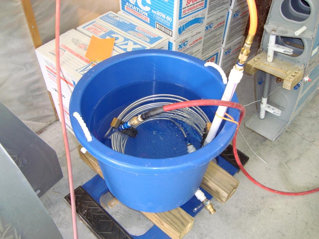

For those of you doing your own painting, attached photo is a water separator that I find to work well. When painting I add a few blocks of ice to the water. In the photo the red hose is air in, the orange hose is air out. The drain valve is connected at the bottom of the vertical PVC pipe. The vertical pipe acts as a water collector.

That's pretty cool, Carl. I have one caveat, though. PVC has been known to explode and the shards aren't visible in X-rays. I'd use copper for the riser.

It’s difficult to see in the picture but I assume that the condenser coil’s output intersects the vertical pipe a few inches from its bottom?
Questions:
  1. how much water is collected after an hour of spraying?
  2. What part of the country are you in?
  3. relative humidity, temp/dew point spread?
  4. Any idea what the pressure drop thru the device is? (tank pressure vs gun pressure?)
  5. How many pounds of ice do you typically use & how long does it last at what ambient temp?
I know, waaaay too many questions.

This is the fourth drain in my air system. Before adding this to the first three I got water to the gun. With it I don’t. I shot primer today on the RV-10 cabin top and cowl in hot, humid Fredericksburg Virginia.

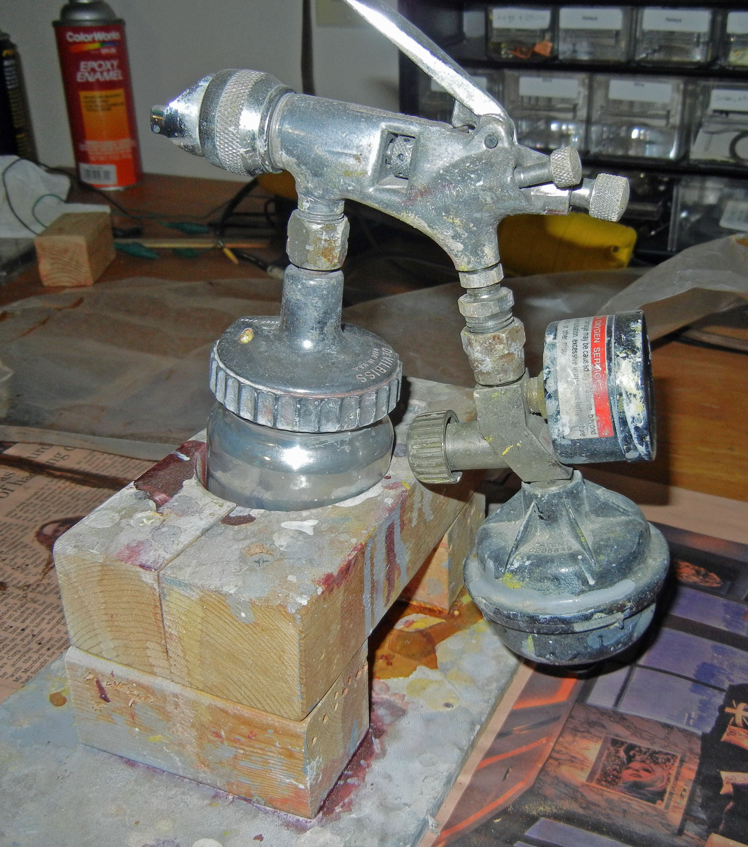

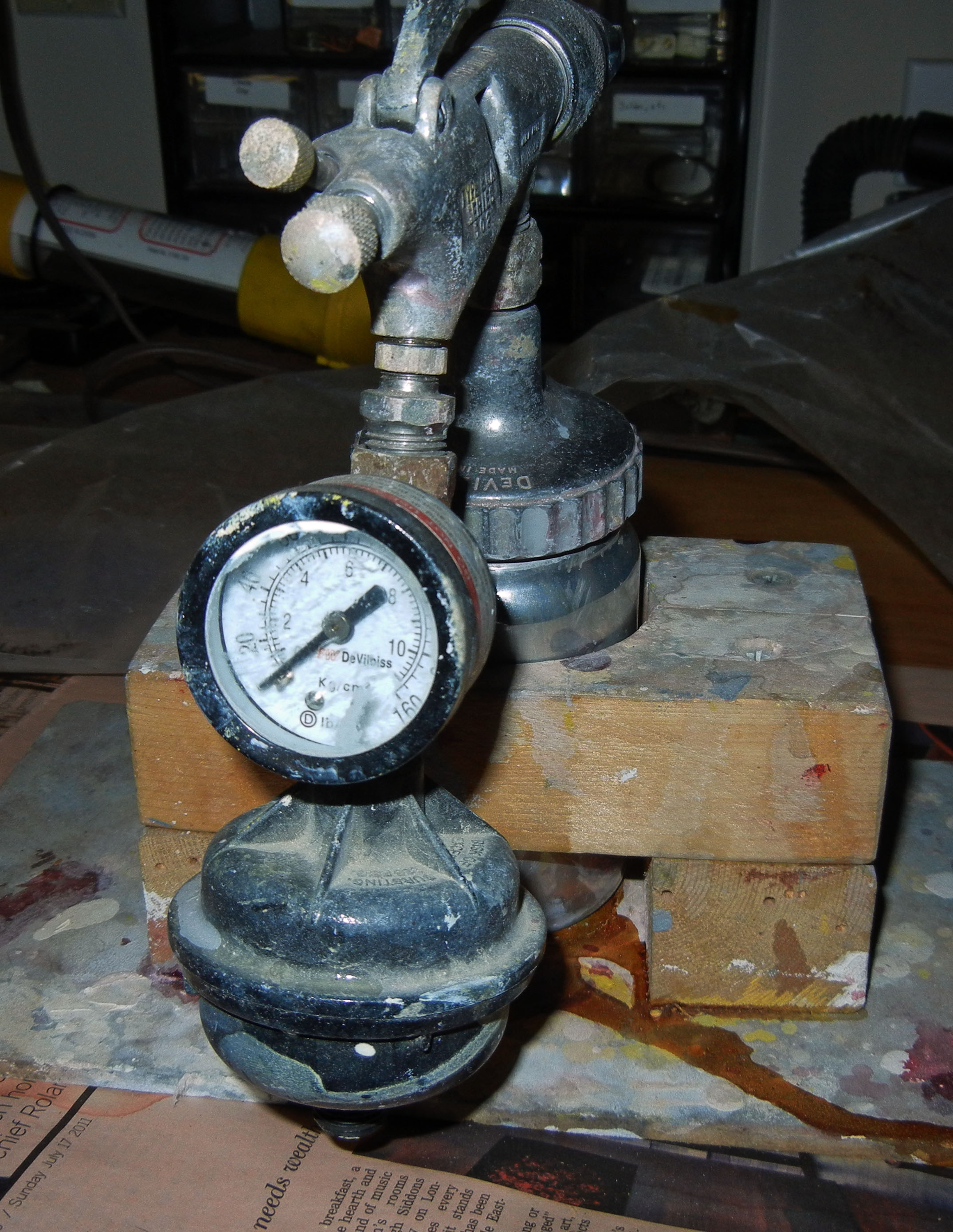

I painted my RV-6A in July and August of 2004 in Florida where and when the temperature and humidity, are always very high. Initially, I worried about water in the air line and read of many solutions that involved cooled coils in the air line. However, I avoided those complications by using a filter at the gun and had no water problems. I used conventional high pressure guns, a de Vilbiss touch-up gun for small parts and a gravity feed gun (forgot the brand name) for the large areas. My paint sequence was: wash primer followed by epoxy primer, then color followed by clear. At no time did I observe any water droplets. The painted result was excellent.
If you look past the well used and messy spray gun, I've attached a couple of pictures of my touch-up gun with the in-line filter (the black thing below the pressure gauge).

I used the same set up (black filter/ water trap) on my Devilbiss HVLP spray gun in 2002 when I painted my RV-4 with no water issues. Had some issues before I installed the trap, but not after. Now if they could develop a bug trap.......
