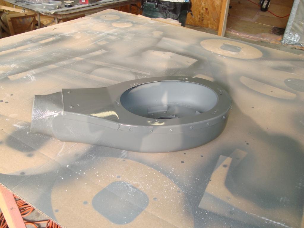

I found that the Van’s air box can be easily modified to handle the larger K&N E-1000 filter. Photo attached. This air box is made for the James Cowl.
Also note the .032 aluminum plate and air filter brackets in the bottom of the air box. On my RV-8A I found the air filter wears away the bottom fiberglass, and the bottom of the air filter tends to lose its shape with time (the bottom diameter gets smaller). The plate also makes the alternate air door fabrication easier.
Carl
