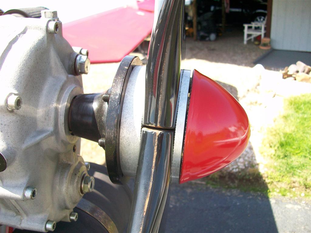

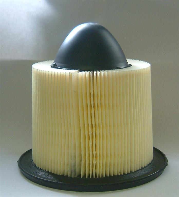

Here's a cheap spinner: a Motorcraft air filter.
If anybody is interested, I'll try and find out the part number, anyway it is plastic and easy to do.
 Filesize:  52.03 KB
 Viewed:  17618 Time(s)
 Filesize:  95.64 KB

Motorcraft Air Filter FA1632
--> Kolb-List message posted by: "Richard Pike" <richard(at)bcchapel.org (richard(at)bcchapel.org)>

[quote="fs2kolb(at)aol.com"]
Hey! I bet that's why that particular picture had the tag it did!
(Facepalm)
