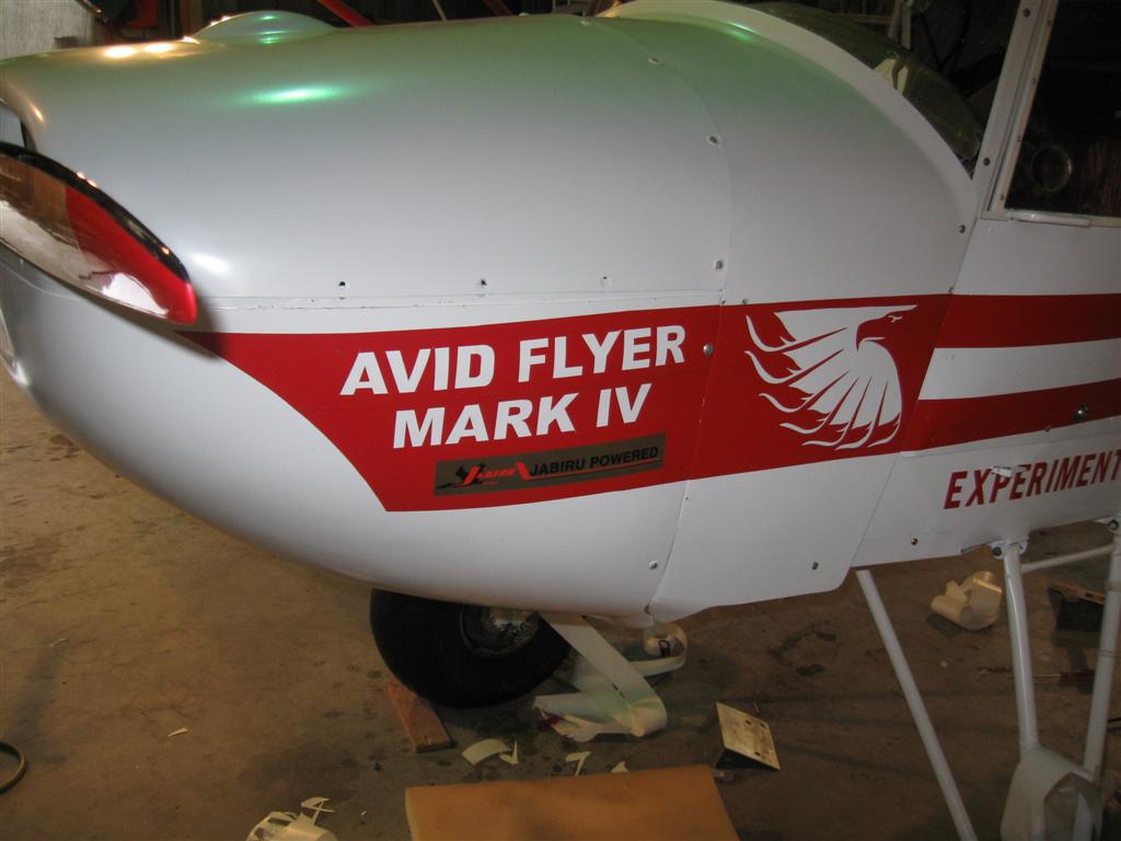

Hi James,  I have to agree with you about the looks of the Avid MK IV cowl verses the round Kitfox cowl.  I have a MK IV cowl that I have to remodel for my Kitfox 4 also.  I'm flying an Avid MK IV now and the cowl is way easier to see over than the round cowl  when on the ground.   If I was you, I would add to the back of the Avid cowl whatever you have to to make it fit.  I am going to do just that myself.  It will end up being a three piece cowl when it's done, a boot cowl up to the fire wall, and then a top and bottom cowl from there forward.  When I put my Jabiru engine in my Avid I had to do much the same thing with the two piece cowl I bought from Avid.  Fortunatly it was long enough and fit the windshield okey.  I ended up cutting the top and bottom off at the fire wall, fiberglassed them togeather, and then shortened up the front two pieces about 1 1/2" so they fit the front of the engine.  Here is a picture of what it ended up looking like.   If you need any more details of how I did it, just ask.  Take care,
Jim Chuk
Avid MK IV (flying)
Kitfox 4 (slowly building)
northern Mn
