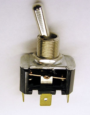

An excellent recap of some extensive discussion
shared here on the List some time back.
[img]cid:.0[/img]
Rivets have been used to assemble gazillions
of switches for decades. The designers of such
devices strive for rivets not to be the "weakest"
link in the chain of stresses on service life.
Let's look at the inner workings of a Carling toggle
(common to tens of thousands of Cessnas and certainly
thousands of OBAM aircraft). We observe TWO features
in the current carrying path that are more vulnerable
to wear-out or environmental failure. One is the
contacts. Resistance across the contacts is a function
of spring pressure and contact surface condition.
Resistance across the pivot-saddle is also a function
of spring force and surface condition . . . but at least
it gets "scrubbed" each operating cycle. Contacts just
get "hammered". Contacts also benefit from the cleansing
effects of electrical arcing to burn away products of
corrosion.
When installed with some attention to stresses on riveted
terminals, one can expect failure of the low-pressure,
moving-components to precede failure of the rivets by
perhaps an order of magnitude of service life.
Rivets in the switches are used in tension and they
join a stack of materials that includes a plastic.
Rivets in sheet metal are used in sheer. Further, if
properly drilled and set, they swell up in the hole to
form a metal-to-metal, gas tight fit . . . not unlike
the gas-tight fit of wires properly mashed in the
barrel of a terminal.
Riveted doublers to reduce sheet current density
around a high-current ground to airframe is probably
not a 'bad' idea . . . but if there are concerns
for getting a good ground in a thin-metal assembly,
perhaps going around it entirely with a bundle of
copper "cat-hairs" is a 'better' idea.

thermal expansion rates, and a destructive cycle of rising resistance,
higher heat and accelerated damage results until the Bakelite cooks and
crumbles or the copper bits inside anneal and deform to the point that
the actuator can't move the rocker far enough to make/break the
connection.
Neal
Joe Gores
n8zg(at)mediacombb.net
