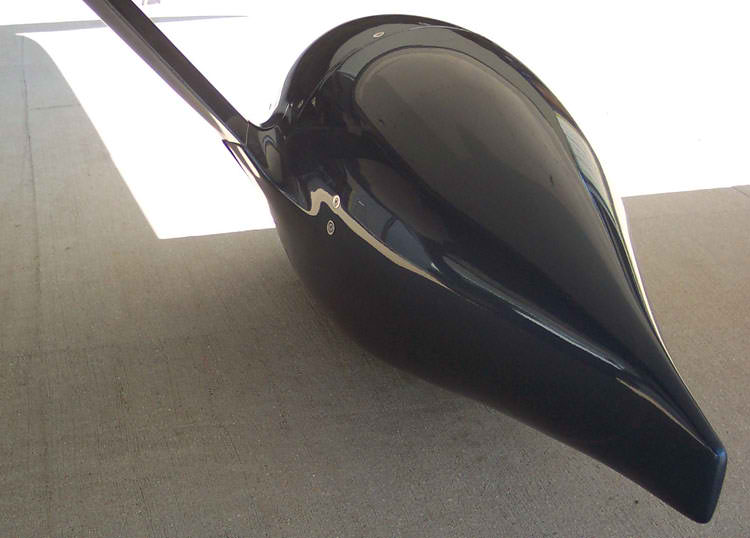

Hello Fellow RV-8 Builders, I'm about finished making my intersections and my hanger mate, the ever evil and diabolical Neil, just modified his RV-9 wheel pants to incorporate the bottom intersections into one piece (really two pieces, but one pants) Ever in fear of humiliation from the horde of other RV drivers at the airport and the shame of having a inadequate and technology flawed design wheel pants I suppose I need to follow suit. My question is where are the divider cuts made in the RV-8 intersections when attached permanently to the wheel pant? Show a photo or two would be appreciated, Bill of Georgia RV-8A, N288WP, 10 Hrs into Phase l and trying to finish the legs and wheel pants

Want to one up your builder friends? I am at OSH looking at fiberglass work and figuring out how to best finish off my 8A wheel pants and saw one of the nicest applications to date. Once you get the blended wheel pant gear leg fairing complete as you are asking about (mine are already done and look great) then put pant in place and cover with release then add your concoction of micro balloons or mill fiber and resin and cover the gear leg down low flairing out the gear leg to match the profile of the wheel pant fairing. Then before it sets up take the back side of a hack saw blade or a thin knife and run between the pant fairing edge and the new material you just added. Let the resin set up. Once dry sand both (in place) till the shapes match. You now have made a transition from the gear leg to the wheel pant with no lip. This will also hide any chafing common at this intersection. The end result is a nearly seamless leg to wheel pant.�
I hope the description is clear enough to understand. I have photos but will not be downloaded from my camera for a week.
One other suggestion. For non-8 specific questions I suggest you throw out your requests to the RV list not just the 8 list as we all have to deal with fiberglass issues regardless of the model RV.�
Photo of my RV-10 wheel pant with integrated transition fairing (note split location - top and bottom of pant).
Robin

I don't quite follow what you're asking. But, do yourself a huge favor and surf over to Bob Snedaker's "Fairing Etc" web site and order up a pair of upper and lower intersection fairings. You'll be glad you did. They fit exceptionally well and reduce the amount of time spent significantly. More importantly, when you're done, you'll have an exacting shape match between the left and right sides. Here's a link to Bob's site:
* https://fairings-etc.com/Intersection_Fairings.html
Here's a step by step of how I did my RV-8 lower fairings using Bob's parts. 13 log entries:
* http://www.mattsrv8.com/users/display_log.php?user=MattsRV8&project=638&category=2973&log=99660&row=82
Later, I redid the wheel pants and made a blister for the brake caliper which made them fit a LOT better. I highly recommend this modification. 11 log entries:
* http://www.mattsrv8.com/users/display_log.php?user=MattsRV8&project=638&category=2973&log=108939&row=17
