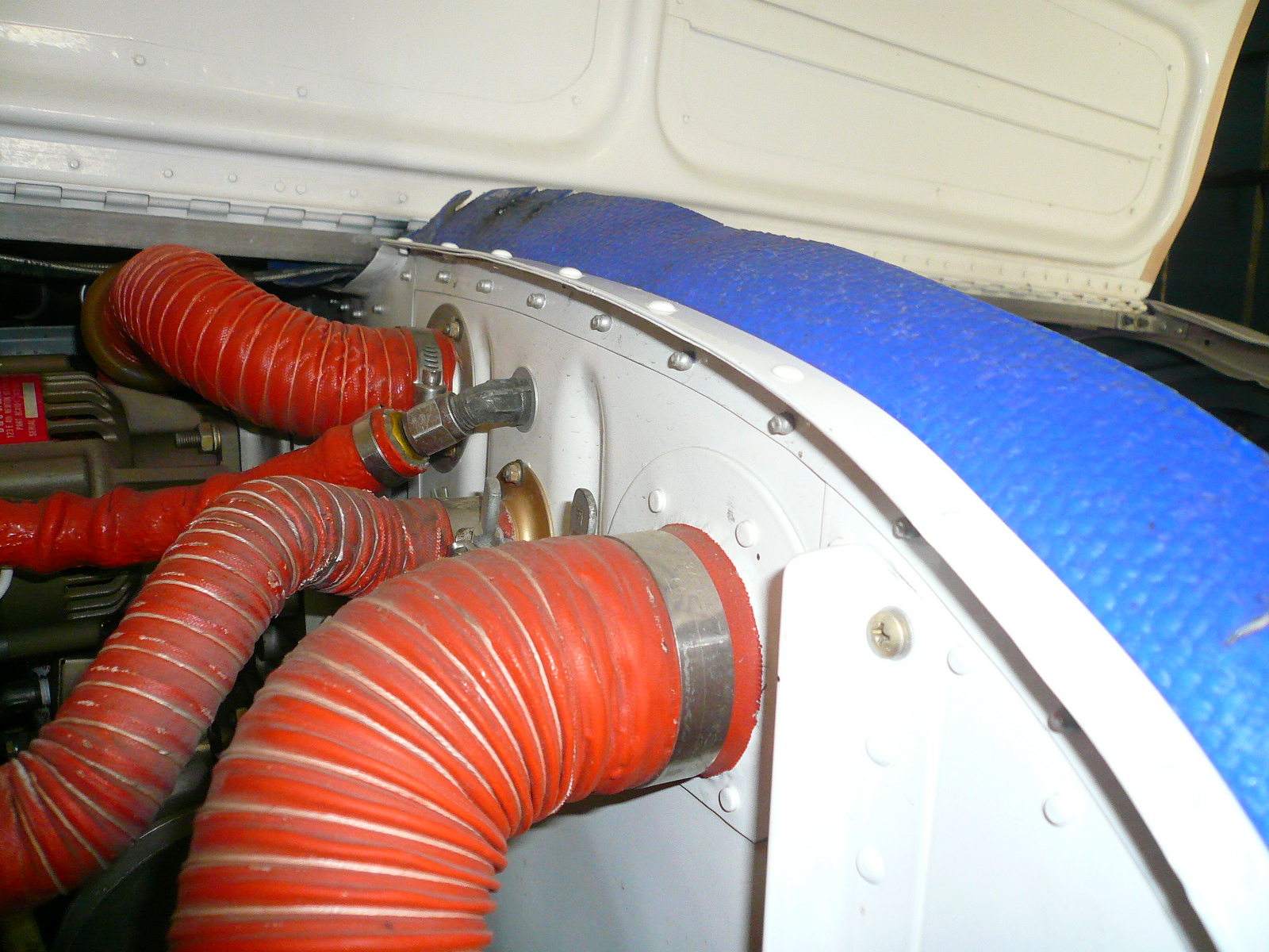

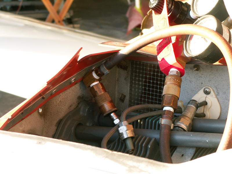

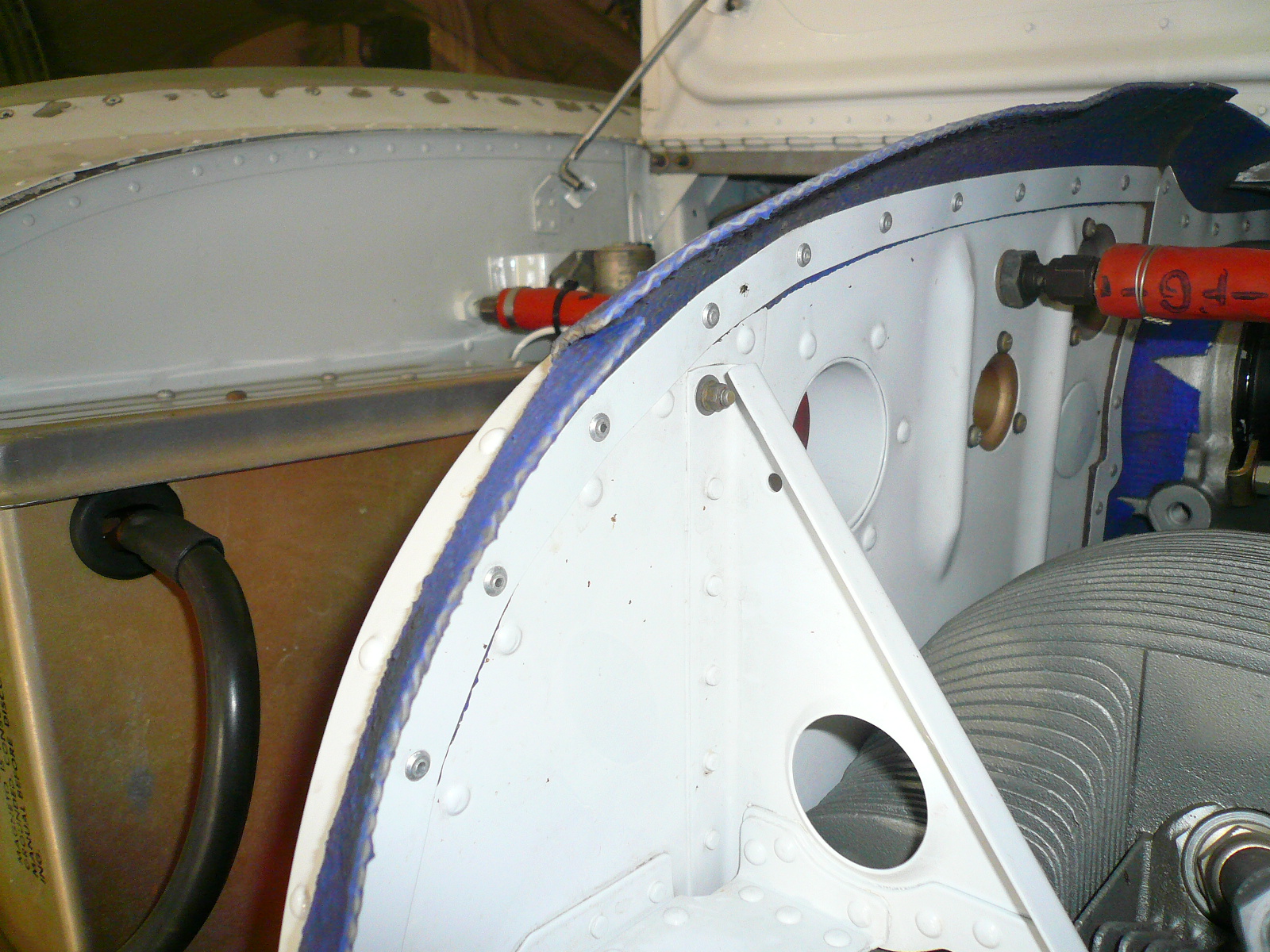

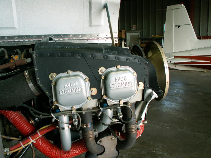

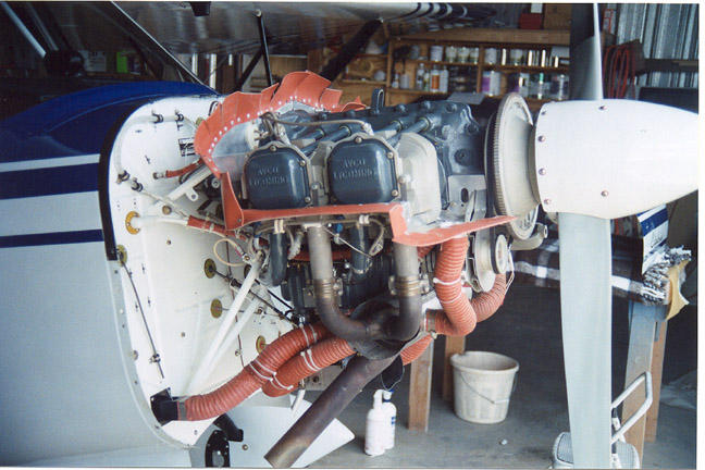

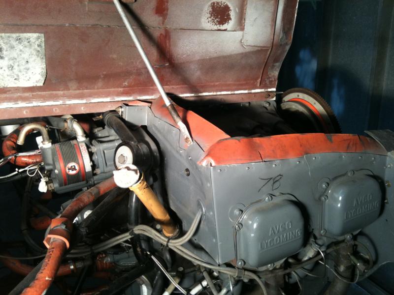

Boris,

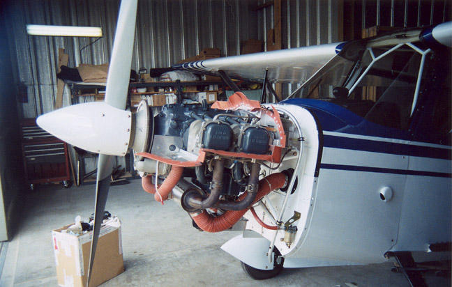

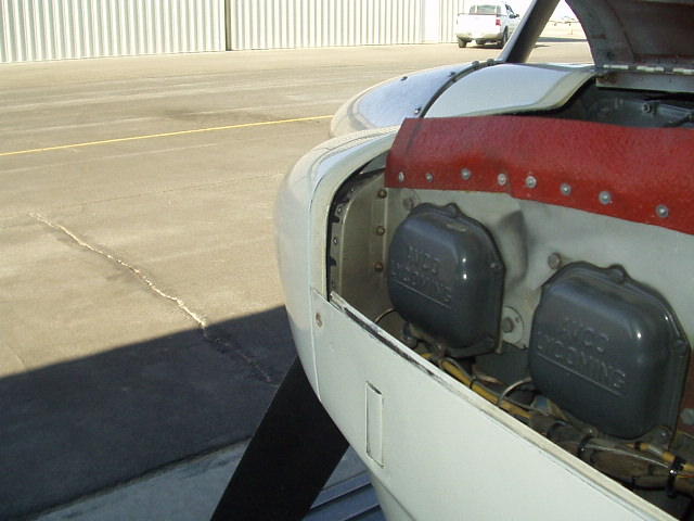

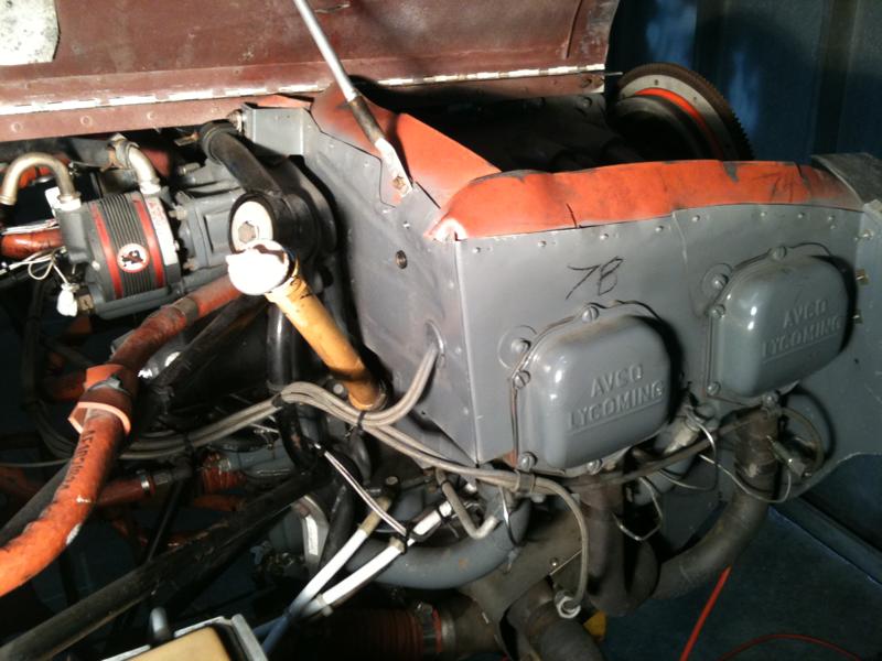

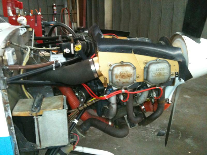

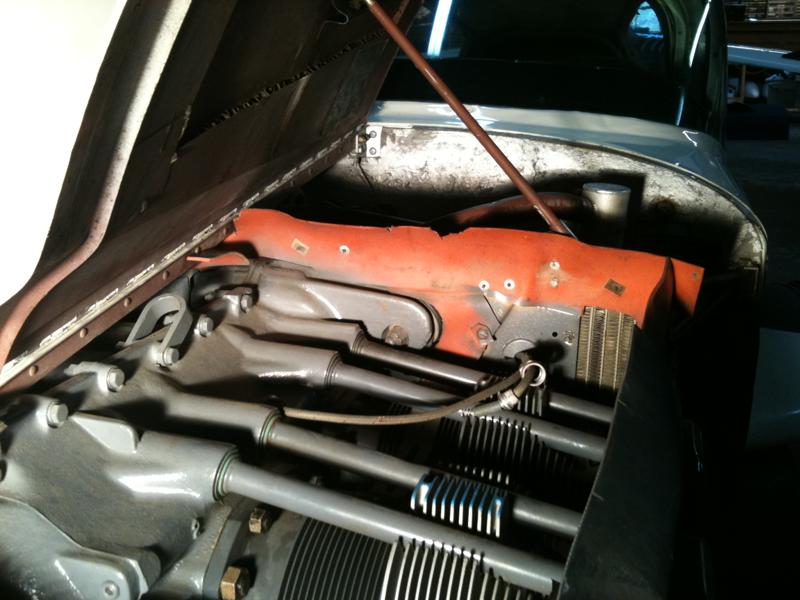

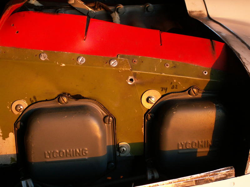

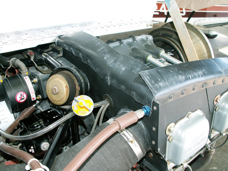

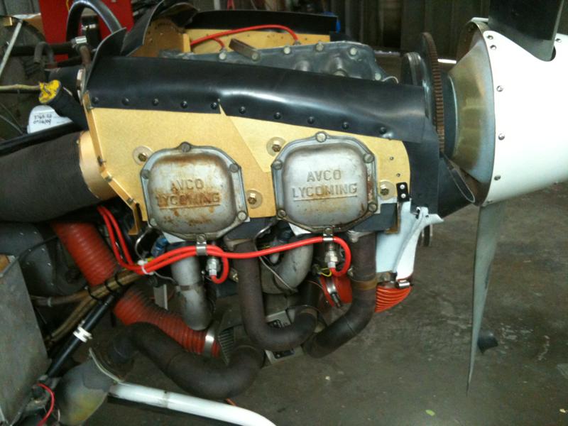

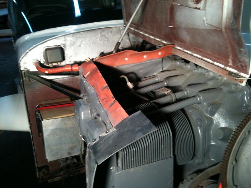

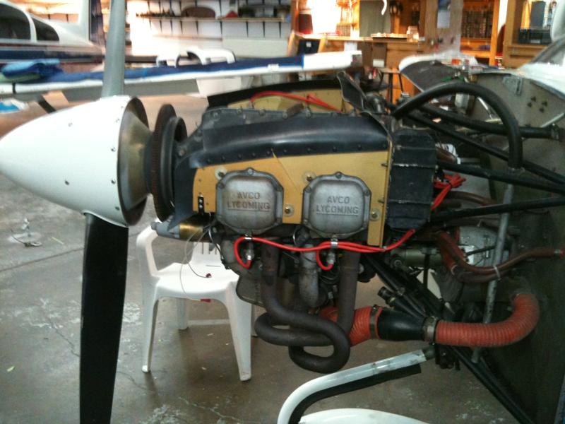

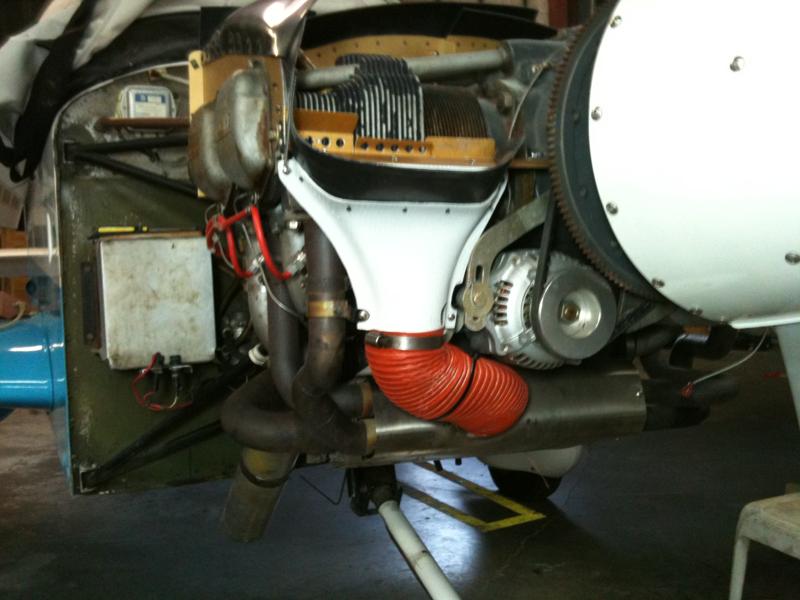

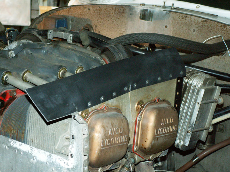

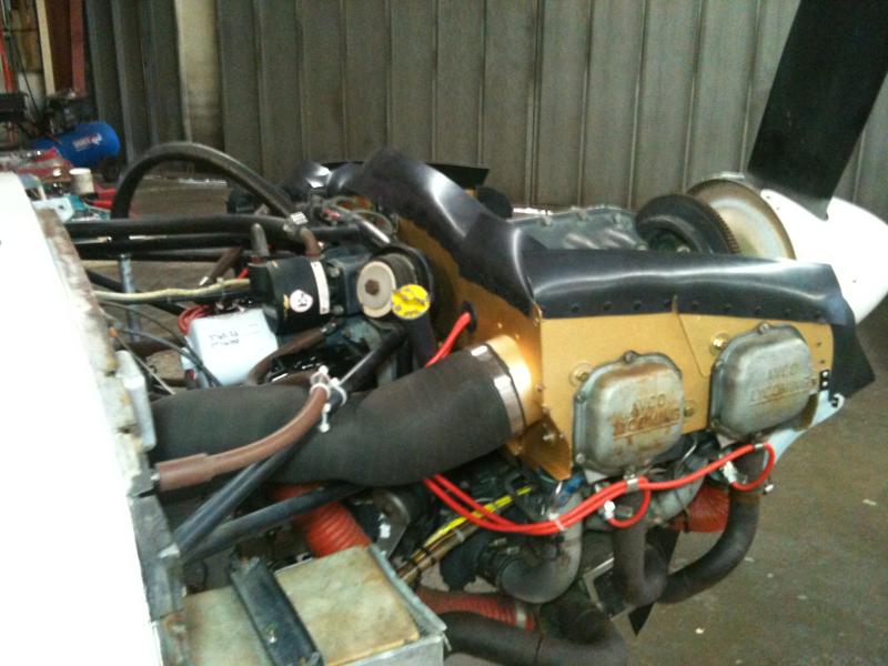

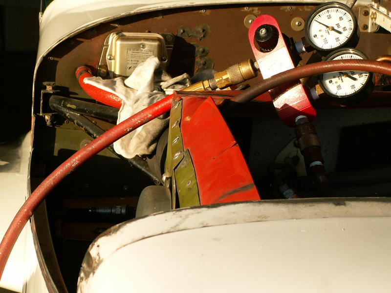

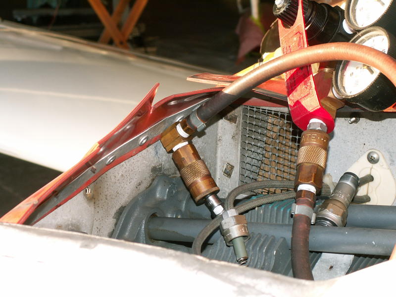

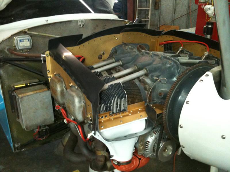

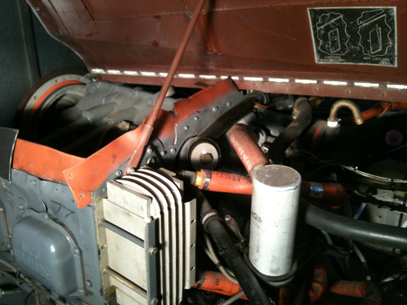

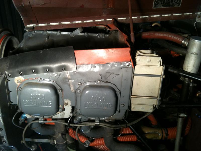

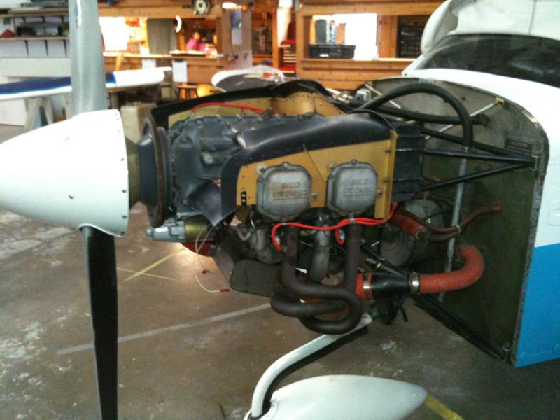

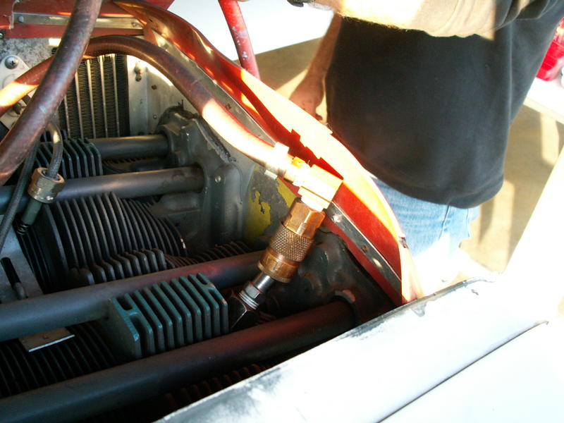

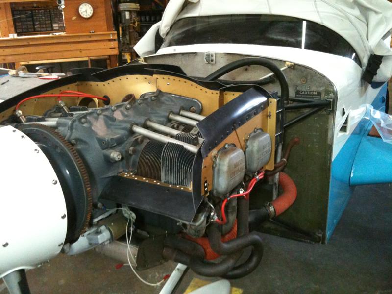

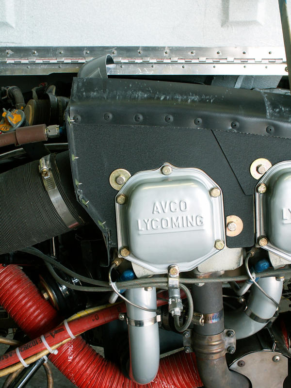

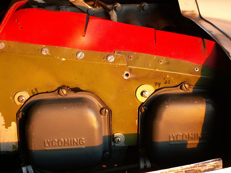

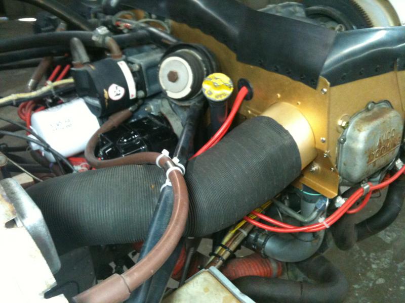

I've heard this argument before and it's total bullshit. The baffle seals bend over the baffle and seal between the baffle and the cowling. If you want baffle seals to conform to the shape of your cowling, follow the directions. Otherwise, you'll end up with baffles that stick straight up into the air and you'll never get the cowling closed.
A very well known Grumman expert puts the seals on the inside and then bends the metal baffles to force the seal to bend over. This not only makes it nearly impossible to remove the plugs, but it looks like shit too.
see pics.
First set: customers plane. How not to do baffles.
Second set: my plane. Note how the baffles conform to the shape of the cowling.

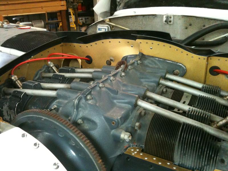

Third set: N119ST. This is during the installation of the baffles on N119ST. These are new baffle seals. Note how they conform to the shape of the cowling.
I would feel confident in saying that there are few mechanics, A&Ps, plane owners, or novices that know how to correctly install baffle seals so they fit properly.
Go to www.AuCountry.com and click on Restoration. Under 2003, you'll see Baffle Installation. That may help.
Gary
PS. Now ask how I really feel about baffles/baffle seals. {smile}

Good pics Gary! I've seen quite a few really bad cowl seal installations .... admittedly on homebuilts.
Almost every baffle segment is attached to a curved edge. I attach the baffle seal material using the 'devide and conquer' method. I attach the material to the outside at the mid-point of the curve. I use the outside because so the seal material protects the cowl from the aluminum edge .... if it's close and the engine rocks. The next rivet 1/2 way to one end, pulling it down just a little so it folds over towards the inside. Do the other side 1/2 way towards the end. Continue the stretching/riveting until you're satisfied. Once all the riveting is done I run a small bead of silicone along the top of the aluminum edge and lay the top cowl on until the silicone cures. I've had the best luck this way.
Now, as for the material. I use the thin fiberglass reinforced stuff like in Gary's pictures. I've seen a lot of 1/8" silicone installations and they all look like crap. The thin stuff forms much easier to the cowl shape and is easier to work that subtle curve.
Linn

Thank you for the pictures, Gary!
I have just learned so much! For example, I need to make a cut-out in the cabin heat inlet duct to accommodate the alternator belt adjustment bolt.
Another "Other people suggest" question - this one about baffle seal material. I heard people say that the reinforced baffle seals wear out and expose the reinforcement material and it starts rubbing holes in the top cowl and for that reason they prefer non-reinforced silicone seals. I haven't seen it rub a hole all the way thru, but I have seen some damage in the top aluminum cowl. Some people suggest to put aluminum tape to cover the contact area as a remedy. What do you think?
Your plane has a standard exhaust! How come?
The N119ST baffle doesn't have a cut-out for the hinge. Are you using a one-piece top cowl now?

I use the 3/16 inch reinforced material from Bee-Gee. I buy it in 100 foot rolls from Sacramento Sky Ranch. You can probably buy it direct. You'll need about 4 feet or more.
The pics of my plane are pre-2005. Originally I was going to do both exhaust systems. Then I learned the cost of extra drawings and testing. Based on the number of cowling sales, I'll break even at about 50 to 60 cowlings. Had I done the stock exhaust system, figure another 30 cowlings.
I don't have any pics of my upper cowling and the wear on the baffle seals. For the most part, the Imron on the underside of the cowling will be smooth enough to stop chafing. There is some wear. But, after 7 years on my plane, nothing is worn through.
N119ST. It wasn't finished yet.

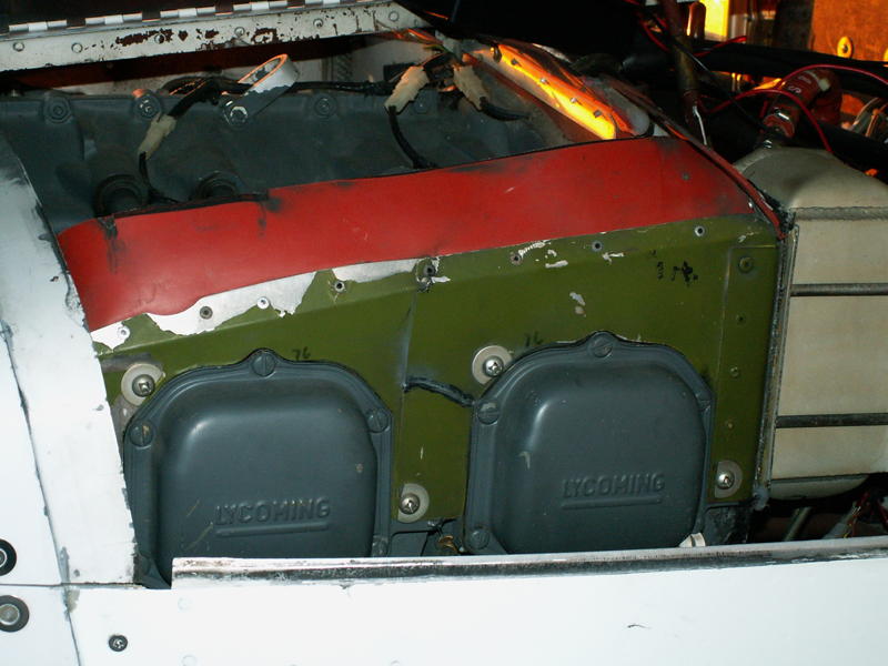

I believe that a good installation can be done either way. I've seen
baffles that were installed incorrectly from the back side that were cut
by the sharp edge of the metal baffle, probably because there wasn't
enough clearance between it and the cowling.

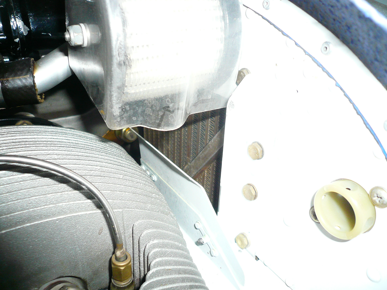

Here are 3 photos of what is a totally different arrangement than what
has been discussed, albeit not on a Grumman. Note that in the photo
(P1060256) of the front side that a top metal strip is riveted to a
flange and it sandwiches the seal material, forcing it to bend forward
and form a nice curvature.
The last photo (P106057) shows the oil cooler installation on the
opposite, LH side where the cooler is set back about 1.5 inches behind
the cylinder fins for improved air entrance flow. I think the Tiger
cooler could benefit from this sort of thing, although it wouldn't need
to be set back nearly as far.

Boris, Gary & Team:
Here are my thoughts on In Vs Out:
1. There is no advantage of putting the silicon baffle material on
the outside. Only a disadvantage.
* Why? Well if you think about it there is only 0.025 to
0.035" difference in position between inside and out. The
thickness of the metal baffle.
* The difference is in which direction the NATURAL ROLL of the
silicon goes. YOU MUST place the curve of the silicon baffle
material to the INSIDE. This is true for BOTH the LENGTH and
the WIDTH of the silicon baffle material.
* THERE IS A CURVE! ! !
* It's ugly! But beauty is in the eye of the beholder.
2. Reinforced Vs Un-Reinforced:
* The Un-Reinforced is softer and will bend easier and conform
easier.
* The Un-Reinforced will also deform easier when the
Pop-Rivets are squeezed down. This causes and adds to the
scalloping of the silicon baffle material.
* The Un-Reinforced will tear easier.
3. The Cure for problems in #2 above:
* I use 1/8" thick x 1/2" wide x Required LONG LENGTHS of
aluminum strips that function as a CONTINUOUS WASHER to hold
down the silicon baffle material against the aluminum baffle
material.
* This FLATTENS the silicon baffle material ELIMINATING ALL
scalloping as well as stiffening the aluminium baffle material.
* So NOW you can use the softer, more flexible Non-Reinforced
silicon baffle material. Which will give you a better seal
and less ware.
* So, why on the inside if you do all the above? It LQQKs a
hell of a lot better.
* Yes, you can still use the LONG LENGTHS of aluminum strips
that function as a CONTINUOUS WASHER to hold down the
silicon baffle material against the aluminum baffle material
- On The Out Side.
* Oh! I use 5/8" Dia HEAD x 1/8" Dia Shank x 1/2" Long Shank -
Pop-Rivets.
* To prevent tearing I stitch the over laps in the corners and
'V' cuts with dental floss.
Barry

teamgrumman(at)yahoo.com
PostPosted: Thu Jul 07, 2011 11:28 am    Post subject: why put baffle seals outside the baffle Reply with quote
I did my Citabria, which has baffles that are not that different from those on a Bonanza, using my technique. I used 1/4 as much hardware and accomplished the same thing. The Citabria had baffle seals mounted on the inside. I copied them. By the time I was done, I wished I'd done them differently. Still, it worked OK.
I've included a few pics.
• The first one is a customer I did a few years ago. This is how the baffle lays over without any help.
•The next several pics are of an installation where the metal baffle was deformed to make the baffles fit. It's a brute force method that is really ugly and makes maintenance difficult.
•The next two are of my Citabria.
•The last one is of an installation of a LoPresti nosebowl. Notice the gap in the corner. There is no way to elegantly fill this gap. Unless the installer knows what he's doing, CHTs will be higher after installing a LoPresti nosebowl.
From: flyv35b <flyv35b(at)minetfiber.com>
Sent: Thu, July 7, 2011 8:47:35 AM
Subject: Re: TeamGrumman-List: why put baffle seals outside the baffle

michael(at)flightsked.com
PostPosted: Thu Jul 07, 2011 12:34 pm    Post subject: why put baffle seals outside the baffle Reply with quote
Hmmm... I believe that I recognize that engine compartment.
Gary replaced my baffles, with new metal parts, and flexible material as he describes. It is definitely easier to access the plugs now - you can see on the old baffles how the top edge was deformed from getting the socket wrench in and out.
All the cylinders cool well in cruise and climb with the new baffles (actually, I didn't have any cooling problems with the old ones either, but they were old and tired, and needed to be replaced).
Michael
