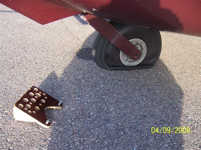

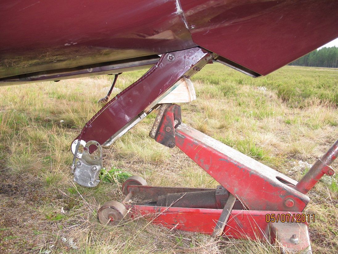

However, could you be more descriptive of the Jacking Block you always carry? Perhaps I missed it in your earlier messages. I’m sure we need to follow your example if it saves a great deal of trouble.

Hello Ferg
Look at the photos – I am sure you get the idea for a simple wooden block – a real mind saveing angel. With lightening holes it is very light but still strong. Notice high quality bolts (2 x) which will carry all the load when jacking up.
You will get all the dimensions from your gear including the angle of the triangle shape.
Let me know if you need more info or LHAD drawings *.
* Left Hand Aided Design
