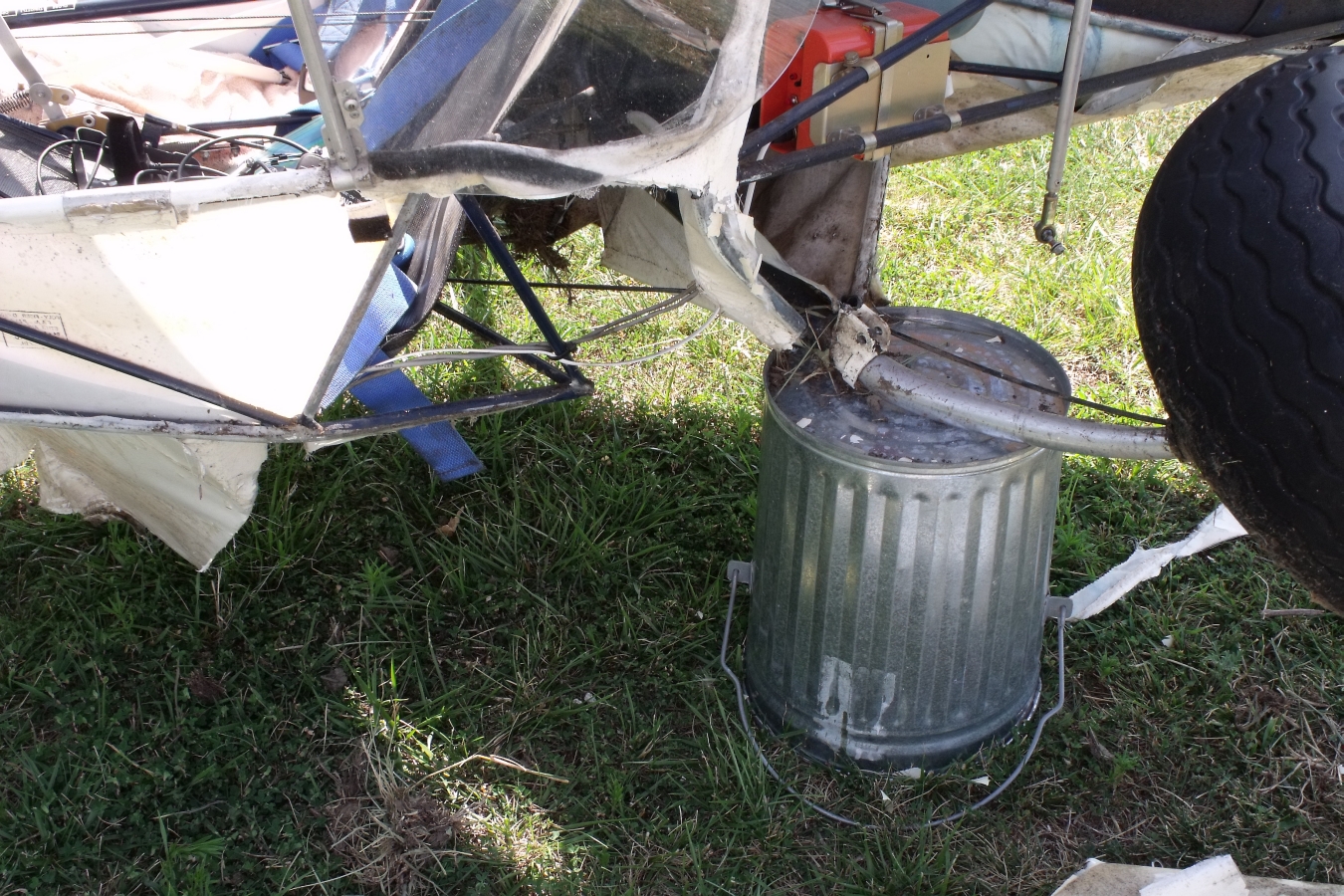

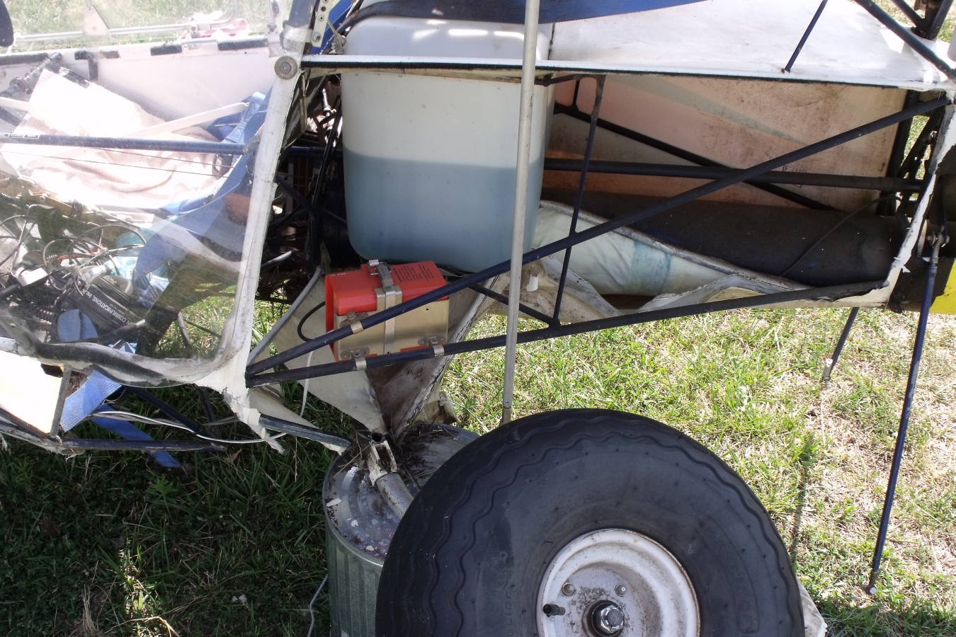

My wife, Lou, and I just took the wings off Zulu Delta and I cut away come fabric from the fuselage to get a better idea of the damage. Not as bad as I first thought. Not good, but better than I expected.For Newbie and other lurkers. I didn't take close ups of each weld cluster, but not a single one failed. Where ever there was a separation it was because the tube ripped, not the welding. I hit pretty hard but I walked away without even a bruise. The truss structure absorbed the hit and left me unscathed. I am glad I was flying from the right seat, though. I don't think one of the tinker toy aluminum tube and pop rivet aircraft could have protected me like this.
If you're out there Homer, I owe you a very big thanks.
Rick Girard
Zulu Delta
Mk IIIC

  The ELT locator radio is one of the last things I need install, and I noticed
yours in your photos.  I haven't decided on a final location, but at the moment
I'm leaning toward the "under the passenger seat" position.
  By any chance, did you notice if your ELT beacon went off?  Do you now have to
report your accident to the FAA?  What about logbook entries for the repairs/etc?
I'm curious because I don't know how an "experimental" plane handles things like this.
I've got a pretty good idea about certified planes and accidents, just not in this case.
Mike Welch
