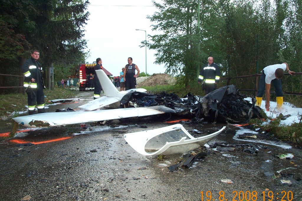

Sorry to remember you all that my Woodcomp prop nearly took my life.
I hate to repeat my words, but memories seem to be short.
The propeller i had was equipped with microswitches, which were and
,after a change, still are not designed for outside use.
Nethertheless these switches are mounted on the backplate, open for
weather.
These switches are designed for AC 240 V, not for DC 12 V, and the Amp
rating is way below the current going through them.
The cross-over diodes are specified for less then half the current drawn.
Even when activated only occasionally, it's a design flaw.
Know to me are 3 incidents with short circuiting micro-switches, both
other pilots could land their plane without damage to their plane or
themselves. An incident with a loose gear, causing one of the blades at
a totally diffent angle then the others was reported to me, and never
made it to this forum. This seems to be the happy family show, which i
am now spoiling. Sad
It may well be that there are others, or people never fly in rain. or
are just very lucky.
In my case, to the best of my knowledge, a microswitch short circuited,
taking the prop to a feather situation, shortly after take-off. I had
been flying in heavy rain for hours the other day.
Unless thing have changed is Jyrki the only one who understands English,
if he's not available you are on your own.
After my incident Woodcomp banned the Smart Avionic controller. What
that means is unclear to me. As far as i know, they never got there own
controller working decently.
As for the figures, i've had trouble to keep up with a 912 with a fixed
prop and i was flying with a 914 and a Woodcomp 3000. The only good
figure seems to be the price.
So in short: Save a few, risk your plane and life.
The choice is yours....

Hi
Further to Jos's comments about his very serious accident I seem to recall that the Austrian authorities planned to issue a report regarding the possible cause.  I may have missed it so can anyone let me know what it contained, preferably in English.
Not being an expert in these things I find I have problems linking the limit switch failure Jos talks about to the fact that for the propeller to go to fully fine or even beyond fully fine to a beta state requires the motor to be powered to drive it there. I am sure there may be a mechanism that will make that happen but I cannot see how it can do that just because a limit switch fails.
Also my understanding is that Woodcomp do not support the Smartavioncs controller not surprising really as it is not their product and it is in competition with them but " banning" it is beyond their remit.
Tim H

Tim,
I've sent the report to somebody who is German en fluently in English,
on his offer to translate. This translation takes an incredible amount
of time obviously.
But, as a matter of fact, the investigator thanks me for diverting from
my line of descent into an occupied office building to trees. The
wreckage was badly burnt. He also reports that he had Woodcomp check the
remains of the propellor, and that they stated that the blades "must
have been at a flyable angle" Also there was no obvious fault with the
engine. It has not been possible to determine what the cause of the
accident was. You may doubt of course that i have summarized properly as
well.
Significant might be also that after the accident Rotax was the first to
talk to me, smartavionics next, the factory was very interested also.
But no question, no word from Woodcomp.
I find it strange that you start an argument by telling us that you are
not an expert. And reach a conclusion, which is false. I am an expert,
electricity, electronics have been my profession and hobby. I know
microswitches and diodes, and if i tell you they are grossly underrated
and not up wet conditions, you can take my word for it.
My only interest is to save your lives. If you don't want it, please let
me know.
So, let me explain how the prop ended in a non-flyable position, so
simple that a non-expert can understand. I commanded via the controller
to go finer. That makes the motor run the blades to fine. The motor runs
then as long as the controller command it to go finer or the fine limit
switch cuts the current. In this case, because the desired rpm was high,
and i was climbing, the fine limit switch should cut in. But it didn't
because it was burnt, and short circuited to earth. The controller
reversed it voltage to increase pitch and we had a short circuit on the
plus now. The circuitbreaker popped. The revs went to 6200, with no
pull. Attempting to reset it booted the controller. Which proved it was
still working, And after the boot it popped again, The accident
conditions were there, low on altitude, low on speed.
I find it amazing that people defend such a product. Everybody i spoke
to privatly admids there have been problems with communication, with
quality of parts, with forgotten or loose parts, splitting blades,
whatever. Oh, of course, they will cut the blades in a banana form, or
apple, or anything else you fancy as fast. Very flexible indeed.
There is a good working product available, has been for years, factory
choice, with only plusses but the price.
Everybody makes a mistake, and i can admit it was my mistake to go on
the cheap and settle for a Woodcomp.
Jos
Tim H
and ,after a change, still are not designed for outside use.
for weather.
Amp rating is way below the current going through them.
drawn.
both other pilots could land their plane without damage to their
plane or themselves. An incident with a loose gear, causing one
of the blades at a totally diffent angle then the others was
reported to me, and never made it to this forum. This seems to be
the happy family show, which i am now spoiling. Sad
or are just very lucky.
circuited, taking the prop to a feather situation, shortly after
take-off. I had been flying in heavy rain for hours the other day.
English, if he's not available you are on your own.
What that means is unclear to me. As far as i know, they never got
there own controller working decently.
fixed prop and i was flying with a 914 and a Woodcomp 3000. The
only good figure seems to be the price.
Jos Okhuijsen
(enjoying his second life Smile

Carl,
Microswitches do not regularely fail. Their MTBF is typical one ot 10
million.
However, thanks for confirming this, in this (Woodcomp) application they
fail for 2 reasons.
Wrong environment, not intended for outdoor use.
Underrated for heavy DC current.
Maybe an example helps. Take a look at the brake-light switch of your
car. It would be a typical place for a microswitch, but instead a 4
times bigger lump sits there. Why? Because it has to switch DC, although
far less then for a heavy motor. Becaue the inside of a car is not
classiefied as dry, although it will seldom rain there.
Failsafing with a second switch does not help.
It just doubles the fail factor.
In case of water ingress this might be clear, there are now 2 paths to
short.
As help for underrated switches, it is even for layman fairly easy to
understand that due to unavoidable mechanical tolerances, the switches
will never switch at te same time. As a result all load will be carried
by one switch.
Until it has melted, which will never be discovered until the second one
goes. Unless it melts to ground.
Another monkey story indeed is the mechanical stop. If all fails, that
should stop the blades from running in idle.
In flying you have to be sure that your minimal pitch is flyable. How
sure are you that your mechanical stop A does keep you in the air and B
does not burn your motor or break the gears? How many of you Woodcomp
jockeys do test their electrical endstops on a regular bases? Who has
ever tested the mechanical endstops?
Maybe its is easyer to forget and just enjoy flying. But recommending
your favourite deathtrap goes really one step too far. Wether you have a
regular, reversing or feathering woodcomp prop. The prop on OH-XJO took
182 hours before it tried to kill me.
Jos OKhuijsen
weather.
at a totally diffent angle then the others was reported to me, and
never made it to this forum. This seems to be the happy family show,
fixed prop and i was flying with a 914 and a Woodcomp 3000. The only
Jos Okhuijsen

As you know I was there at the accident, with the same plane and
the same controller and the same SR3000 (albeit without the reverse option).
I flew back to try to help you and subsequently examined the wreckage and
spent some time helping the Austrian AAIB man. As the accident happened
flying out of the Rotax Factory Flyin it's not surprising that they were
quickly able to help. Secondly since Mark Burton, owner of Smart
Avionics,was flying with us he was quick to talk to the investigator. I may
say that I gave the investigator my copies of the Smart Avionics controller
and SR3000 handbooks and allowed him to look at the complete workings of my
set up which was the official factory set up of an SR3000 without the
reverse option that you had and without the non Woodcomp/personal
simplifications to the wiring system that you had incorporated into the
circuitry. There wasn't too much left of the plane after the fire but the
prop hub was there and it was apparent that the blades were close to zero
pitch, so that regardless of how they got there it would be safe to say that
a similar accident could not happen with an SR3000 that does not have the
reverse option (which is not accepted by the LAA following your accident),
as the standard props have not only electronic stops at the fine limits but
also mechanical ones.

According to woodcomp, invited by the inspector, the blades were at a
flyable pitch. Remembering the lack of thrust, and the overrevving, they
must have been at a positive angle, NOT REVERSE, but with a pitch not
enough to stay airborne.
Why stopped the motor at that blade position and not later or sooner?
Because, at the same moment the microswitch should cut in, it burned
with a short circuit to ground, defying it's purpose and allowing the
motor to run further. Next, adding throttle, the controller jumped in,
reversing the polarity of the motor. The voltage now came direct, not
anymore over the motor, on the microswitch and the breaker popped.
Blaming the accident on the reversbility of the prop, thus assuming that
a mechanical endstop makes it impossible for the prop to turn too fine
to fly is mute as long nobody ever has checked that mechanical endstop.
Sofar i have not heard of anybody who has checked this mechanical
endstop on the non-reversable prop. Unless somebody, preferrably you,
shorts or otherwise disables the end switches, and runs the motor till
it jams, relying on the mechanical stop is not very wise to say the
least. It would be also interesting to know if the gears would survive
such a try.
> plane and the same controller and the same SR3000 (albeit without
> the reverse option). I flew back to try to help you and
> subsequently examined the wreckage and spent some time helping the
> Austrian AAIB man. As the accident happened flying out of the Rotax
> Factory Flyin it's not surprising that they were quickly able to
> help. Secondly since Mark Burton, owner of Smart Avionics,was
> flying with us he was quick to talk to the investigator. I may say
> controller and SR3000 handbooks and allowed him to look at the
> complete workings of my set up which was the official factory set
> up of an SR3000 without the reverse option that you had and without
> the non Woodcomp/personal simplifications to the wiring system that
> you had incorporated into the circuitry. There wasn't too much left
> of the plane after the fire but the prop hub was there and it was
> apparent that the blades were close to zero pitch, so that
> regardless of how they got there it would be safe to say that a
> the reverse option (which is not accepted by the LAA following your
> accident), as the standard props have not only electronic stops at
> the fine limits but also mechanical ones.
> My understanding of the investigation was that no prime
> cause could be positively identified, and if I do not misquote him
> I believe this is also Mark Burton's view (who is also of course an
> electronics professional.)

Jos,
I am sorry for your accident and was careful to Google Earth your flight path – amazed at your survival in view of the circumstances. Naturally like most of us I can see why you would be angry at the outcome.
Nevertheless, because I ahve a Woodcomp (as yet untested) I am interested in any and all discussions regarding it. I researched the company and am aware of its foundation in a healthy (if socialist) industry – at which they were fairly productive. Content with their family tree, I consulted a number of buyers, all of whom appeared content with the firm. I then visited Woodcomp north of Prague and was satisfied with the plant and its resources – modern, clean and efficient – four hours.
In the process of installation, I managed to snap off one of the sintered brushes which transfer the energy to the rotating prop – and sent off a request for a replacement. It was not a design fault – I just had little room to manoeuvre in my spare bedroom and whacked it in passing. Jiri Holoubek didn’t reply, so I sent a chaser. Apparently he was away and when he returned, I got an email requesting clarification. On receipt of my reply, along came two brushes in the mail – no charge.
I am a licensed amateur builder but no electronic expert as you are apparently, but I assembled the prop and its controls without difficulty and ran the tests with no trouble.
The faults you ascribe to the design were there when you assembled it, yet we got no complaint then in spite of what appears to an expert to be obvious failings. So my question is: Did you modify the system at all prior to the accident?
Regards, Ferg

Hi Ferg,
No, the prop was as received -assembled- by woodcomp. No modifications.
But you seem to miss the point Ferg, i am not complaining about their history, or their family tree. I have serious complaints about their inplantation of components not designed and not suitable for the job being asked from them.
The result of that poor design caused my accident.
If then folks, who are protecting their investment over their safety, are trying to convince others that business is as usual, i get really upset. Lack of knowledge is forgiveable. Not accepting facts or reducing their importance is not, especially if others are possibly getting involved.
Jos
