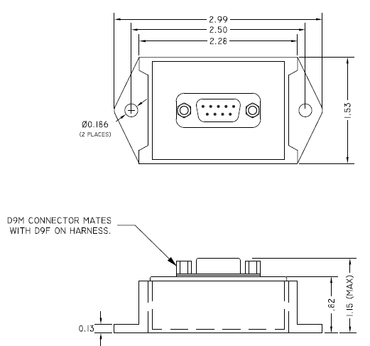

If there's enough interest in this device, it could
be packaged up nicely in a box like this:
[img]cid:.0[/img]
Since you guys did all the development and proof of concept
work, it would only take a couple hours to package it up
and add it to the product line. We could also make this
a DIY project and sell the ECB, case and connector hardware.
