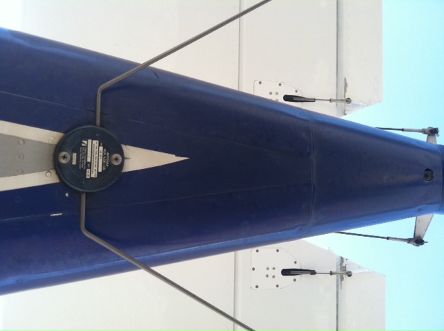

Am currently about 36nm from the center of the DC SFRA. Right wing points to DC. Left has my archer nav. I'm at 3000', well high enough.
Perfect signal on my SL-30 with whiskers. No signal on my 480, shadowed by the plane. Not good for being so close to F-16 territory.
Tim

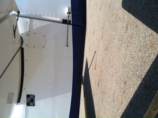

Tim ......Do you have a pic of where you whiskers are mounted?
See you OSH '18
Q/B - sold.
Tim Olson
Joined: 25 Jan 2007
Posts: 2882
PostPosted: Fri Jun 17, 2011 9:03 am    Post subject: Sold on whiskers Reply with quote
Taken 1 minute ago in coldwater Michigan where I was skyway robbed for 6.10/FG. (FG = friggin gallon). Highest price I ever paid.
Average for the trip is in the low 5's with a few under 5.
See you OSH '11
Q/B - flying 1 yr+
http://forums.matronics.com/viewtopic.php?p=343300#343300

Tim Olson
Joined: 25 Jan 2007
Posts: 2882
PostPosted: Fri Jun 17, 2011 9:24 am    Post subject: Sold on whiskers Reply with quote
Waiting on my sandwhich so took another photo. Nice day in the shade.
Tim

mregoan(at)hispeed.ch
PostPosted: Fri Jun 17, 2011 10:29 am    Post subject: Sold on whiskers Reply with quote
Tim,
What's with the spalled paint in front of the trim tab cable attachments?
Is there a problem with cracking or flexing?
Hoping you'll chip in to the discussion about door seals and tell us that
the Van's one is just fine and super easy to install. Irrational optimism I
know .........
And hoping this makes you feel any better, think about 2.50 Swiss
francs/litre (=8.7 $/FG) next time you get gas as cheap as 6.10 Wink
Enjoy the rest of your trip!
Gordon

PostPosted: Fri Jun 17, 2011 11:34 am    Post subject: Sold on whiskers Reply with quote
Tim,
Is there a specific model # for belly mount or is it the same as the VS
mount?
Steven Stella
RV 10 Fuselage
#40654
gengrumpy(at)aol.com
PostPosted: Fri Jun 17, 2011 12:45 pm    Post subject: Sold on whiskers Reply with quote
Same place I have mine mounted, and they work just great there.
grumpy

Tim Olson
Joined: 25 Jan 2007
Posts: 2882
PostPosted: Fri Jun 17, 2011 3:00 pm    Post subject: Sold on whiskers Reply with quote
On that paint, we tried to paint those tabs as light as possible,
and when you combined the too-thin paint job with a crappy job
of prep on that area, that's what you get. That and around
the base of the cowl are my worst areas.

Tim Olson
Joined: 25 Jan 2007
Posts: 2882
Mine is just the same ol' standard one.
Tim Olson - RV-10 N104CD
