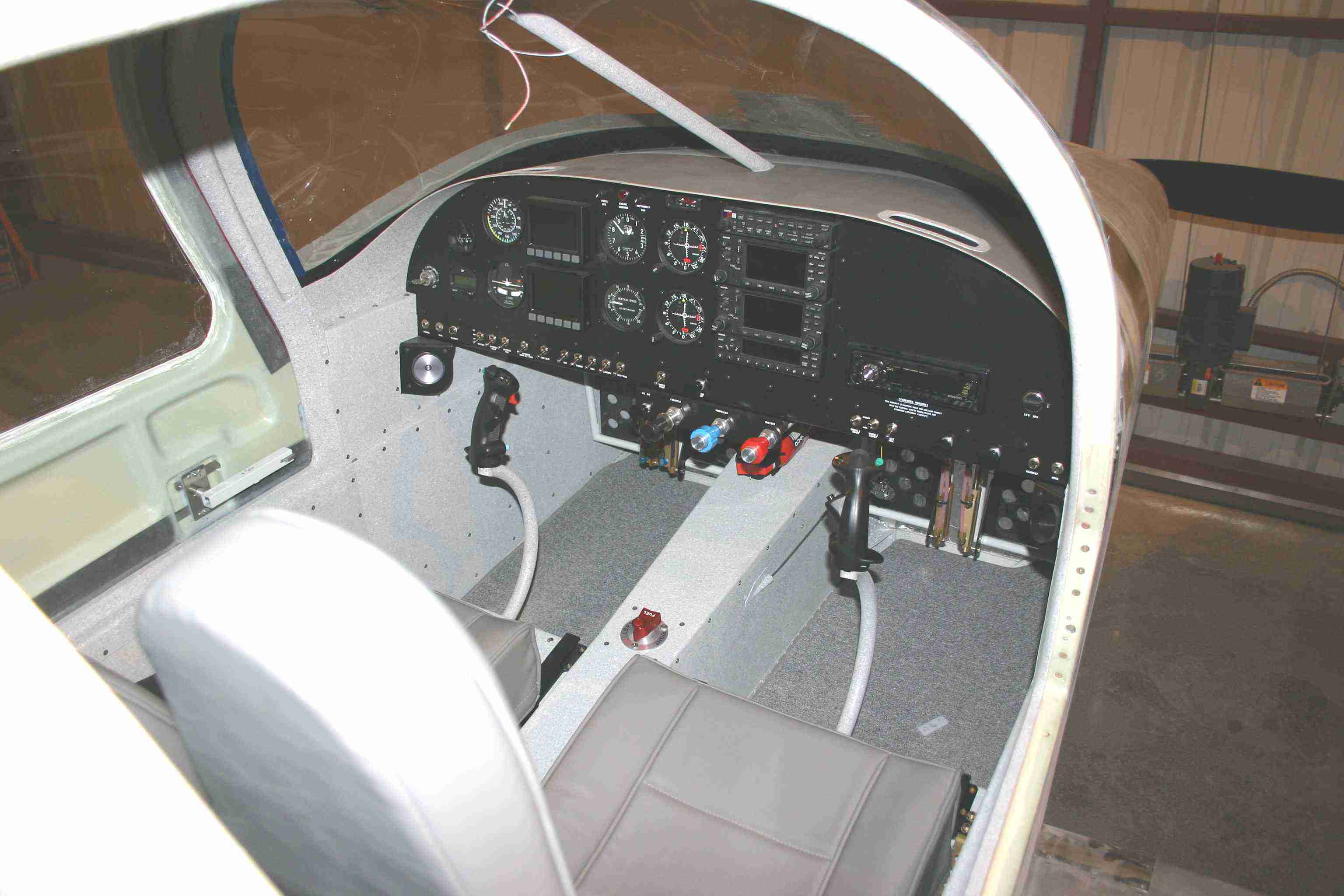

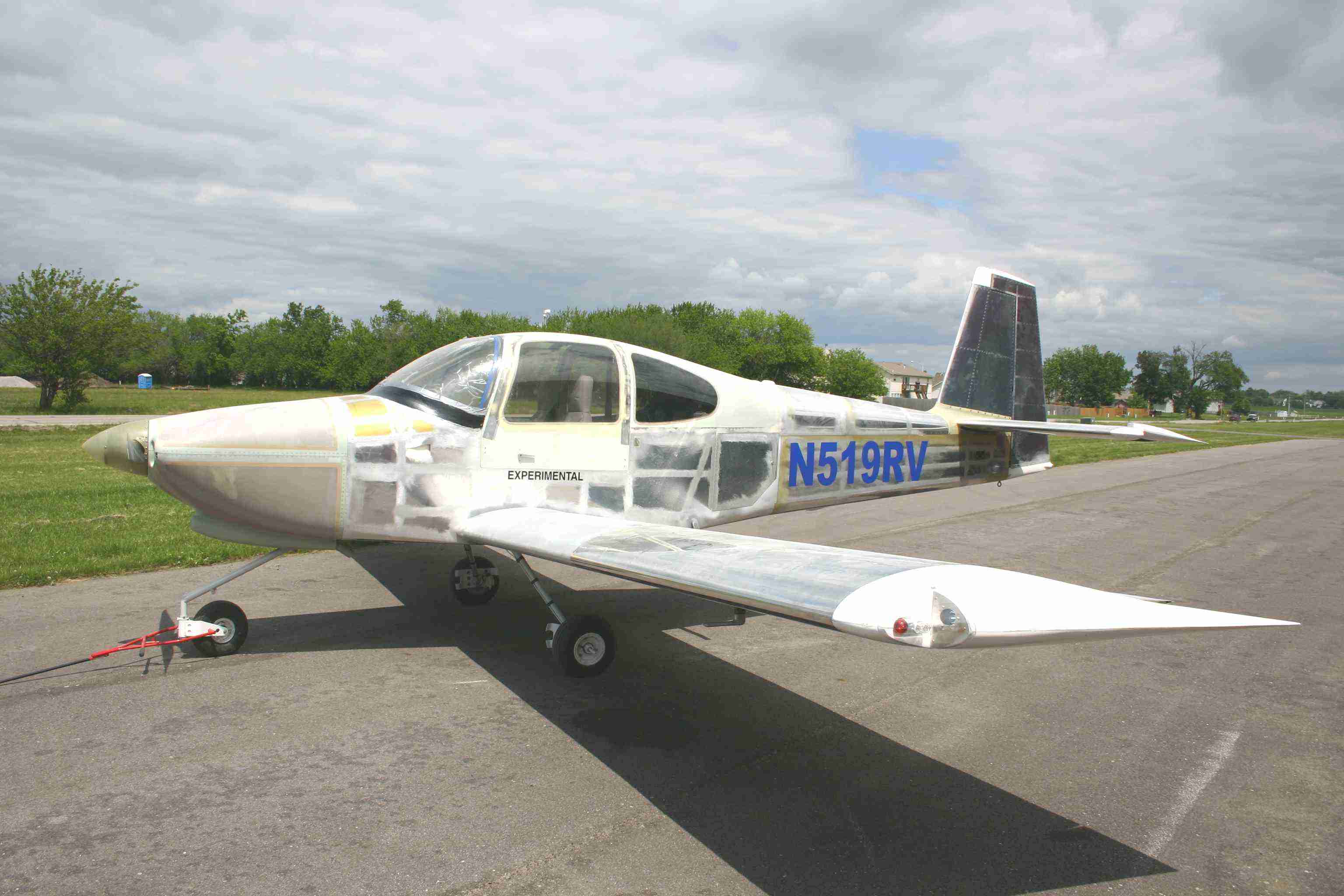

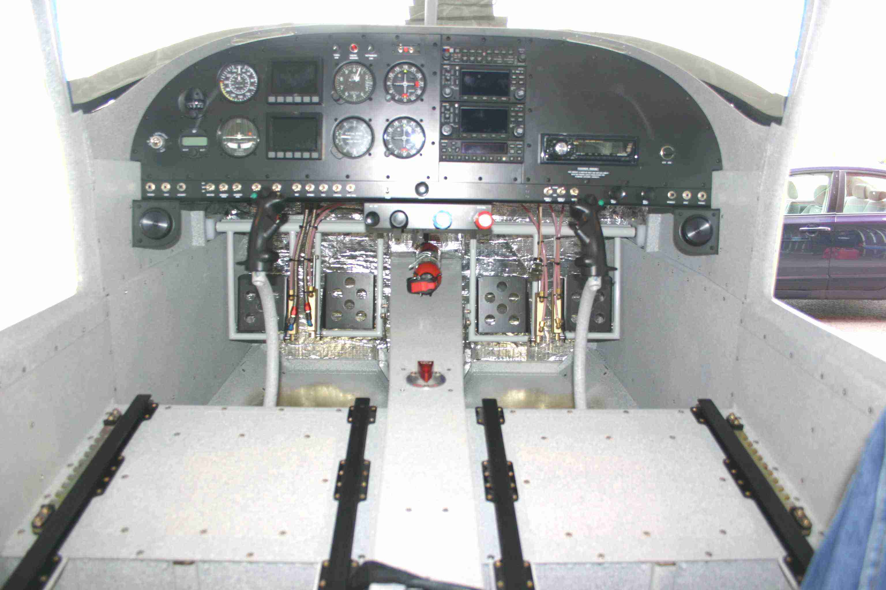

Here are a few recent pictures of N519RV (40250). I also completed the W & B yesterday, which weighed in at 1587 lbs.
Nose Wheel 369 lbs Arm 49.82
Right Main 609 lbs Arm 123.82
Left Main 609 lbs Arm 123.69
For the Weight and Balance, the gear leg fairings, wheel pants and intersect fairing were not installed. The exterior of the plane in not painted, but the interior is complete with carpet interior panels all painted except the insides of the doors.
Thank You
Ray Doerr
40250 (N519RV) (DAR scheduled for Mon May 22nd, First Flight scheduled for Fri May 26th)

coop85(at)bellsouth.net Guest
Posted: Mon May 15, 2006 6:02 pm Post subject: Recent pictures of N519RV (40250) and Weight and Balance |
Ray,
Nice, clean looking interior. Are the side panels painted aluminum sheet or vinyl with snaps? It’s kind of hard to tell by the pictures and I’m trying to firm up what I’ll be doing on the sides.
Marcus

JSMcGrew(at)aol.com Guest
Posted: Tue May 16, 2006 6:35 am Post subject: Recent pictures of N519RV (40250) and Weight and Balance |
Ray,
Could you post the part # / where you bought your tow bar? Aircraft Spruce sells a bunch of them, but I'm not sure which one works with the RV-10
Jim

Ray.R.Doerr(at)sprint.com Guest
Posted: Wed May 17, 2006 7:27 am Post subject: Recent pictures of N519RV (40250) and Weight and Balance |
I made the panels from .020 aluminum sheets.
Thank You
Ray Doerr
