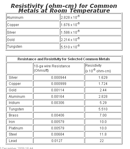

There's a fist full of ways to describe the relative
resistance of materials. Obviously, it's a volume thing.
A bar of copper 1" square and 10' long will show a much
lower resistance than a .1" square that is also 10' long.
Any chart that speaks to relative resistivity of materials
will be incomplete without building definitions around
the samples for which the numbers are cited. For example.
Here's a chart I found on the 'net . . .
http://tinyurl.com/3w4m4kp
[img]cid:.0[/img]
Some resistivity charts have been published using copper
as a baseline and assigning it the value 1.0 with all other
metals compared to copper. Similar charts have been made
with silver having the base-line assignment of 1.0. MOST
such charts are used to calculate the ratio of RELATIVE
resistance between two different materials.
The chart above does us the service of adding a cross-section
that's well known, like 10AWG wire. Note the similarity
of this value to the resistance for copper wire published in
the 'Connection. VERY close to 1 millohm/foot.
RESISTANCE is always a point-to-point measurement like
from one end of a resistor to the other, two different
points in a circuit, one end of a wire to another. The
value observed may be the sum effects of many resistances.
RESISTIVITY always speaks to the volumetric resistance
of a homogenous but otherwise single material . . . like
a bar of brass, copper or stainless steel.

Thank you very much, Ron. I checked out your website and found one link to a "relative resistivity" chart that I really like. It's really a relative conductivity chart, which is of course the reciprocal. It shows copper to be 100%, and it compares everything to it. Silver, for example, has a conductivity of 105%.
I really like this chart and info below it. It says that although brass has a large percentage of copper, its conductivity is degraded much more by the additive metals than the percentages of them in brass. I never use brass for electrical conduction, although it can be used for RFI shielding.

PostPosted: Mon Jun 06, 2011 10:14 am    Post subject: Re: Brass bus bar Reply with quote
Hi Henador
"Thank you very much, Ron. I checked out your website and found one link to a "relative resistivity" chart that I really like. It's really a relative conductivity chart, which is of course the reciprocal. It shows copper to be 100%, and it compares everything to it. Silver, for example, has a conductivity of 105%."
I too like that chart.
I have been using copper bus bars (and thin wires):

PostPosted: Mon Jun 06, 2011 2:13 pm    Post subject: Brass bus bar Reply with quote
At 03:15 PM 6/6/2011, you wrote:
Groan, Ron! The prices of the Cool-Amp is $231.87 for a 16 oz bottle and Conducto-Lube is $496.72 for a 8 oz bottle! At those prices, I'd have to sell my house and outsource my wife!
Such potions are mostly intended for connectors that
can be mated/de-mated with some frequency and do not
enjoy gas-tight make-up of the contacts.
The only time you might get some benefit for permanent
joints is if they've been made up too loose to begin
with. Those products are popular with the maintenance
folks in factories, etc. but I've never seen them
called out on an airplane drawing anywhere.
