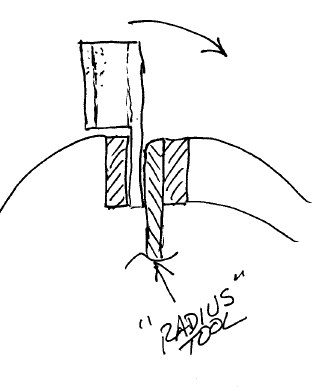

I would suggest an effort to maximize the bend radius would also prove
wise to distribute stress, as opposed to a minimal radius 'sharp' 90
degree bend that would concentrate it; as one might obtain by clamping
the ring in a vise and whacking the crimp barrel over with a hammer
would likely produce.
PostPosted: Sat May 14, 2011 1:08 pm    Post subject: Ok to bend uninsulated ring terminals? Reply with quote
I would suggest an effort to maximize the bend radius would also prove wise to distribute stress, as opposed to a minimal radius 'sharp' 90 degree bend that would concentrate it; as one might obtain by clamping the ring in a vise and whacking the crimp barrel over with a hammer would likely produce.
Excellent point. If one has an 1/8" piece
of aluminum or mild steel from which to fabricate
a bend radius tool . . .
[img]cid:7.1.0.9.0.20110514165610.01db16f8(at)aeroelectric.com.0[/img]
Bob. . .

I'll try to maximize the bend radius and support the wire as well.
Thank-you both for the replies. Just what I needed to keep making progress.
