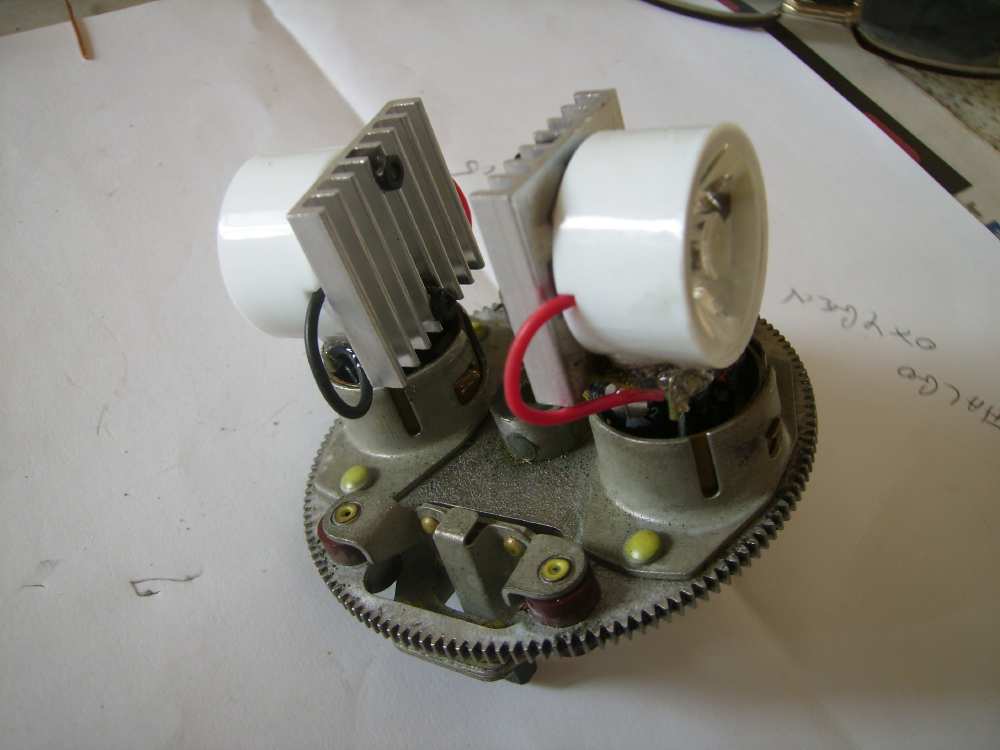

Paul, I have been trialling a LED light and reflector obtained on ebay for the tail light, see attached pic. Contact me off list if you want more details on this project. Cheers, Phil Gower.

I woul be interested also. Please share. We are a small community of 18T. Let us share as much as possible.

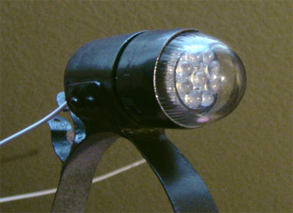

Here is what I have done and is from a previous posting.
The red beacon at the top of my vertical stabilizer and the wing tip nav /position / strobes on my CJ are from AveoEngineering. They are LED-based, very bright, draw next to no power and will probably last forever as they are in solid epoxy. You'll have to make a small aluminum plate to cover the large hole each the wing tip, but that's very simple. Here is a link:
www.aveoengineering.com/Aviation/Airplane_LED_Lights/position_LED_lights/AveoFlashLP_Ultra/index.php
www.aveoengineering.com/Aviation/Airplane_LED_Lights/position_LED_lights/PosiStrobe_MiniMax/index.php
Two of us at FFZ have AveoEngineering lights on our CJs.
There are also replacements for the small exterior Chinese bulb. It's 24 volt, LED cluster that has the same bayonet base. This would be a direct, drop-in replacement for the lights on the nose gear, mains and tail cone. This particular LED arrangement has viewing angle of 90 degrees, so it is brightest when seen from straight ahead. Here is where I found this:
www.superbrightleds.com/cgi-bin/store/index.cgi?action=DispPage&Page2Disp=%2Fother_bulbs.htm
The web site navigation is a little confusing, but basically what you would be looking for is the 24 volt, white, dual contact, single intensity, 15 mm 1142 bayonet base. The ordering designation is: 1142-W15-24V White LED bulb - 24V. I've attached a picture of what this looks like installed.
There are also smaller LEDs from the same web site that you can use to replace the six interior landing gear indicator lights and the cockpit interior lights.
I hope that this is helpful.
