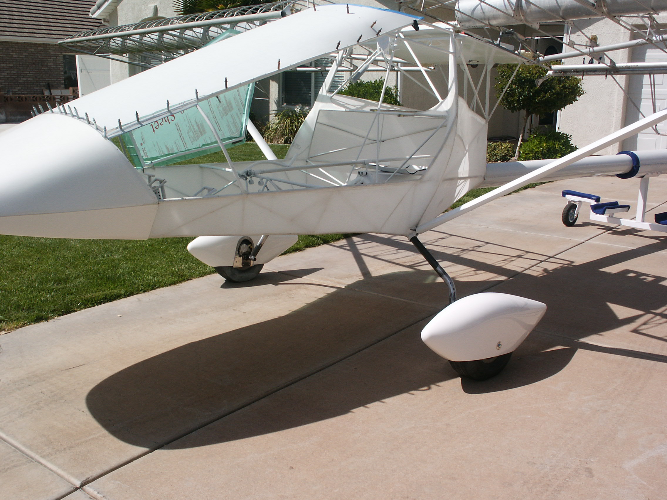

  Your link for a photo didn't come in.  ??    I'm building a Kolb MkIII.  It has a VERRRY
long windscreen (approx 65").   (see old photo.....the plane is almost finished now)
  The intended location that I had planned for the GPS antenna was on top of my radio
console/instrument pod....at the forward portion, mounted on the pod's fiberglass cover.
  This location would place the antenna at an unobstructed spot, forward of my view.
